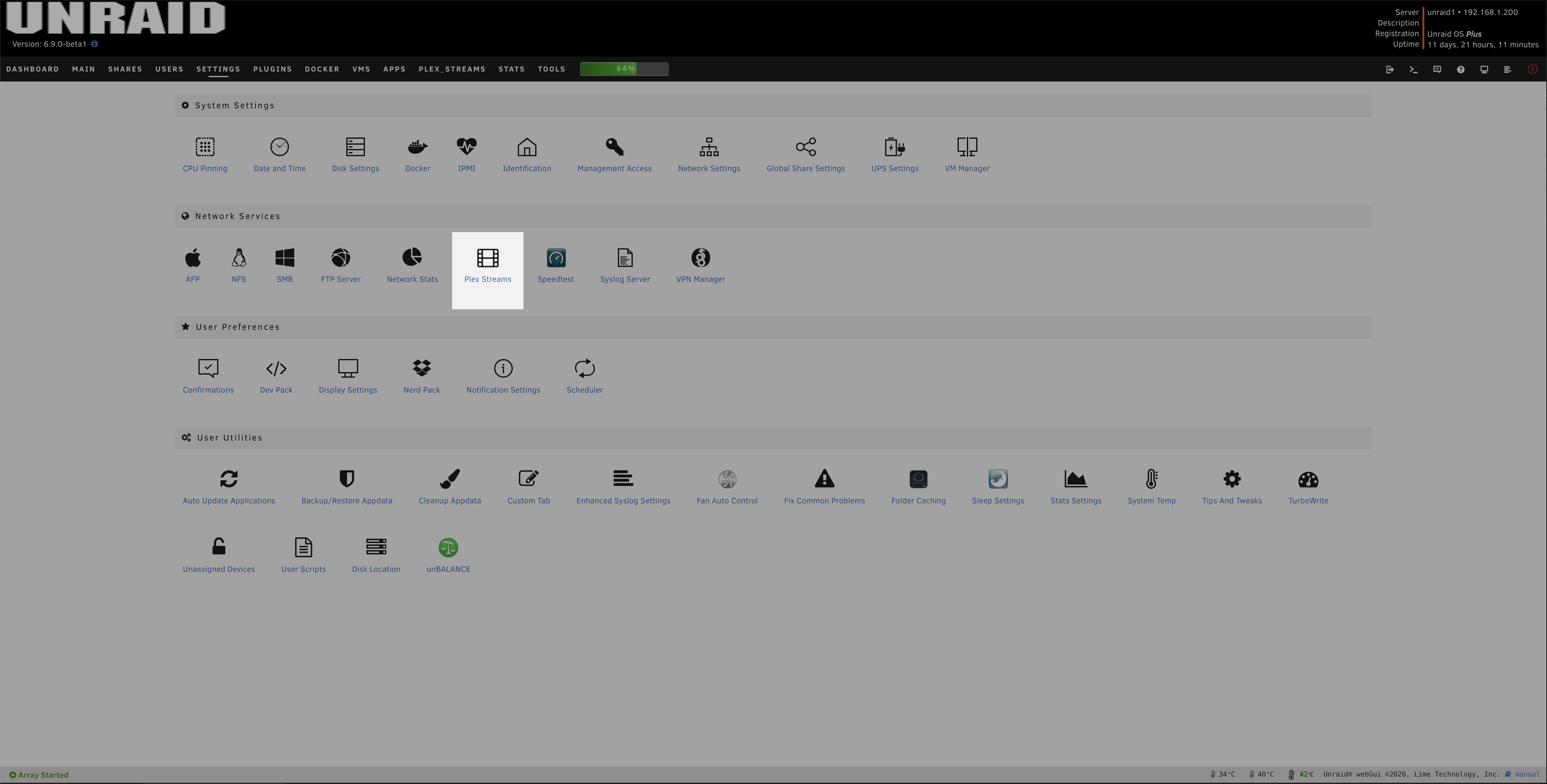

Interesting, can you please show me your settings page.  I pull the list of servers from Plex, also besides the screenshot of the Settings page, add ?dbg=1 to that URL as well and then navigate to the plex.tv URL that it outputs, and could you DM me the output of that file??
Settings page of what? your plugin? or Plex server settings? it doesn't output a plex.tv URL, only the one I display here ?  Maybe i'm not understanding where to look :)
in the Plex Nav click settings, then click Plex Streams under the Network Services section287755446_ScreenShot2020-06-09at5_15_11PM.thumb.png.70c3d565311229e257fdf3e3d95d5d17.png
