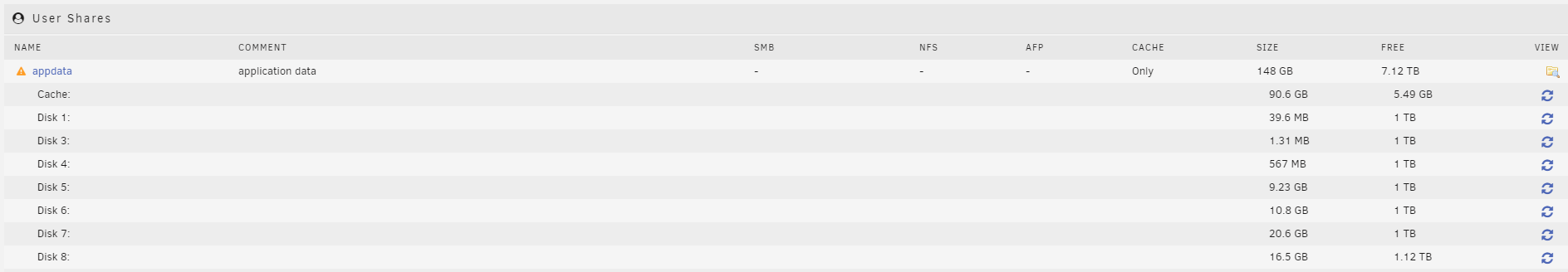

Go to Shares - User Shares and click the Compute All button. You will probably have to wait a few minutes for the result. If it hasn't displayed the results after several minutes refresh the page. Then post a screenshot.

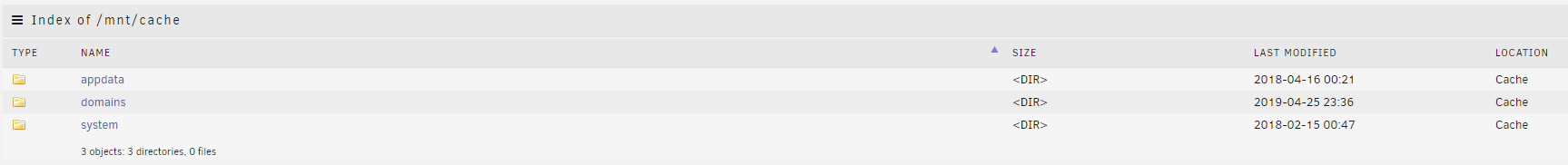

Also, go to Main - Cache Devices and click on the folder icon at the far right under View. Post a screenshot.
OK, I haven't screenshotted the whole page, because I think the answer lies in the first 2nd row!
Just thinking out loud, but could this be the metadata that Plex is storing for the Films and Movies in my media folder?
One or more of your containers is keeping the working data that should be in other shares in the appdata share.
You need to determine which subfolders in appdata are taking up so much space, and then we can look at the configuration for those apps.

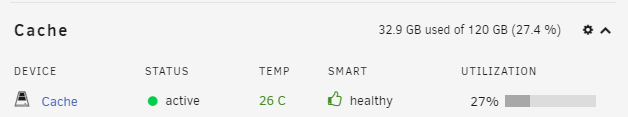

OK, I think we've made some progress.
I've just deleted all 'Video Preview Thumbnails' from Plex, given it's not a feature I've never caught myself using and as if by magic:
Do I still need to check appdata as @jonathanm suggested? And I assume i need to revert some of the cache usage settings now?
