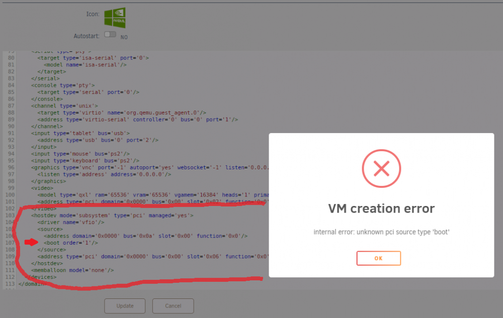

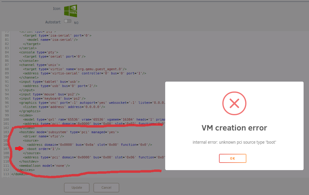

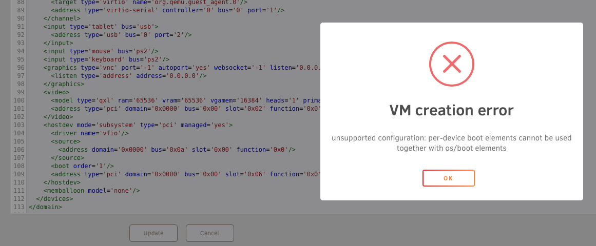

Hello guys, first happy new year to all of you and i think i have similar problem so i will use this thread here.
I try now to configure a win 10 vm which one is booting directly from a passthrough nvme...
Let's start from the beginning:
Unraid 6.8.2
Mainboard: Asus z170 pro gaming (Bios Verison i have to check at home...)
CPU: i7-6700K
RAM: 32gb
NVMe: Kingston 480 GB
Here my unraid flash drive settings:
Server boot mode:  Legacy
Permit UEFI boot mode "deselected"      Boot system in UEFI mode. Please check your system settings to support UEFI boot mode.
1. I add a new Win10 Template and configure the vm like in the screen below:
You are right and of course with a mounted Win10 ISO-File and virtio driver iso and booted to the install setup.
The problem was that i can't find the nvme no matter if with or without virtio drivers and the spaceinvander clover image as the primary device didn't helped out with the problem:
So i decided to shut down the unraid server and install win10 baremetall directly to the nvme like a normal usb installation.
After that i was able to boot to the vm (with the above shown vm settings and without the Win10 ISO-File and Virtio Driver ISO) only one time with the help of the spaceinvader clover image.
Here you can see the first poped up dialog in terms of passingthrough the nvme:
The next times i always crashed to the windows recovery after passing the clover bootloader (which is still the primary device ion the vm template):
At this point all methods brings a restart and places me again to the recovery. So i only have the option to press "ESC" to get to the uefi and there i saw the nvme and the clover bootloader hdd (but only at this one time):
So the vm started fine and all works like it should! But after a restart i crashed again into the recovery mode like the first time. Now i entered again the uefi but this time i noticed that the settings i save the last session have not safed and now the entries are different to the last time. The nvme was lost and only the clover bootloader was shown... after many restartes the same issue:
At this point i shut down the vm and mounted again the Win10 ISO-File and boot to the Windows Installation Wizard:
Here i choosed the option to repair the windows installation and got this screen, where i choose the first option to quit the setup and boot the vm:
Here the vm starts fine again and work absolutly perfectly but when i restart the vm the scenario plays again from the beginning. Sometime when i'm in the position to choose at the last point the repair options the screens looks different and the option to quit the setup and boot the vm directly doesn't exits but in that case a have an button to close and go the uefi ... than i see the nvme and can again boot to the vm. But this method only works when i go the way over the "(WIn10 ISO-File and the repais options)"-way... when i go directly to the uefi i don't see the nvme...
I dont now what to do... that is not a way i like to use my vm... please can someone help me?
My VM XML Code:

The trick here is it edit the xml and find your nvme.  Below source add <boot order='1'\> (just off my head might have the syntax wrong).  This will allow the nvme to boot without always having to select a boot device.  No modified clover image necessary.  Regarding viewing your VM, you can always enable RDP and access it that way...that's how I do it.  I take no credit for the boot order fix, I stumbled upon it in the forum after ripping my hair out.  The catch is every time you switch to form view you will lose this line and you will have to edit the xml again and add it.  Hopefully unraid will fix this eventually.  I'm at work and don't have time to elaborate but if you are confused search for nvme and boot order and you'll find the posts I referenced this from.
EDIT
So I looked through your xml and details but it doesn't look like you are passing through a m.2 NVME like I thought you were.  Perhaps it will still work for you.  Find whatever device your NVME is (somewhere in your xml).  Lets pretend it is this (likely not)
<address domain='0x0000' bus='0x05' slot='0x00' function='0x0'/>
place <boot order = '1'/> after that line for the appropriate device
With this you will not need to use the modified clover...
Edited by sprange

Hi @sprange and thanks a lot for your reply!
I have just tried this out but without a positive ending for my problem.
When i boot the boot order line in the correct place in the xml of the passing through nvme i can't save the changes because i will get the following error:
I dont know how to fix the error... tried many things which i read in other threads but still woithout a solution...
Is it possible that i've got these problems because the Kingston NVMe is shown as  a SATA controller in the device list?
In the VM Template the same thing...
My old Mainboard has 6 sata ports (onboard) and when i will use the one and only nvme port i have to lost the firt onboard sata port...
so is it possible, that my mainboard is talking to unraid that my nvme is a sata card?

I wasn't sure what would happen in your case.  If your nvme is connected via SATA then you should be able to boot it just like any other drive.  The clover image was for cases where the NVME drive was passed to the VM.
Ok maybe I have say it on the wrong way.... the nvme is connected to a normal M2 port on the motherboard. Furthermore my board has got 6 data port. But the manuell says in case of using a nvme in the M2 port the first port of the sata controller will disabled! That a reason of double using the same pci lanes of the board I think... so and what I saw in the Unraid device list I marked in the upper post. The Kingston nvme is listed as a SATA Controller... and here was my question if that can be a problem...
But the way... today I deselected the nvme in the "VFIO-PCI CONFIG" Plugin Application und do a reboot. Now the nvme is listed like a normal "UNASSIGNED DEVICES" in the main tab with the others ssd's and hdd's which are not used by the array... but I tried to passthrough it like a normal way by edit the xml file of the vm incl. the boot order argument, without a positive result. I got still the same error message internal error: unknown pci source type 'boot'
I don't really know what I can do next...
Here is how my PCIE NVME drive looks in the XML code:
      <driver name='vfio'/>
      <source>
        <address domain='0x0000' bus='0x02' slot='0x00' function='0x0'/>
      </source>
      <boot order='1'/>
Yours is a SATA NVME so I have no experience with them.  Maybe look through the forum as to how people pass SATA controllers but it absolutely is possible.

Ahh...I see you have <boot order ...> contained within the <source ... > tag.  Rearrange it like I have mine and see if that helps...
Hi again and thanks a lot for the fast reply!
just tried it up but it didn't work too... get the error:
unsupported configuration: per-device boot elements cannot be used together with os/boot elements
2106936965_Bildschirmfoto2021-01-07um21_16_25.thumb.png.cf63a6f523530c27d1eb0badb4834f00.png
//EDIT:
I have fixed the last error message... in the os part in the upper part of the xml i got this entrie:
<os>
<type arch='x86_64' machine='pc-i440fx-4.2'>hvm</type>
<nvram>/etc/libvirt/qemu/nvram/60421af0-dea8-1f14-024e-0e533ed868cc_VARS-pure-efi.fd</nvram>
<boot dev='hd'/>
</os>
That is an boot device selector in the upper part of the xml... and it doesn't allow to use a boot ordering in the bottom part where i passthrough the nvme...
So i entered the first boot order to the nvme but still have the issue that i cant boot from the nvme...
Is it possible there is a problem with, taht i installed the OS baremetall?
Or that the Windows Installer doesn't see the nvme in the installation process? It doesn't matter whether I load the virtio scsi drivers or not?
Edited by WowaDriver
