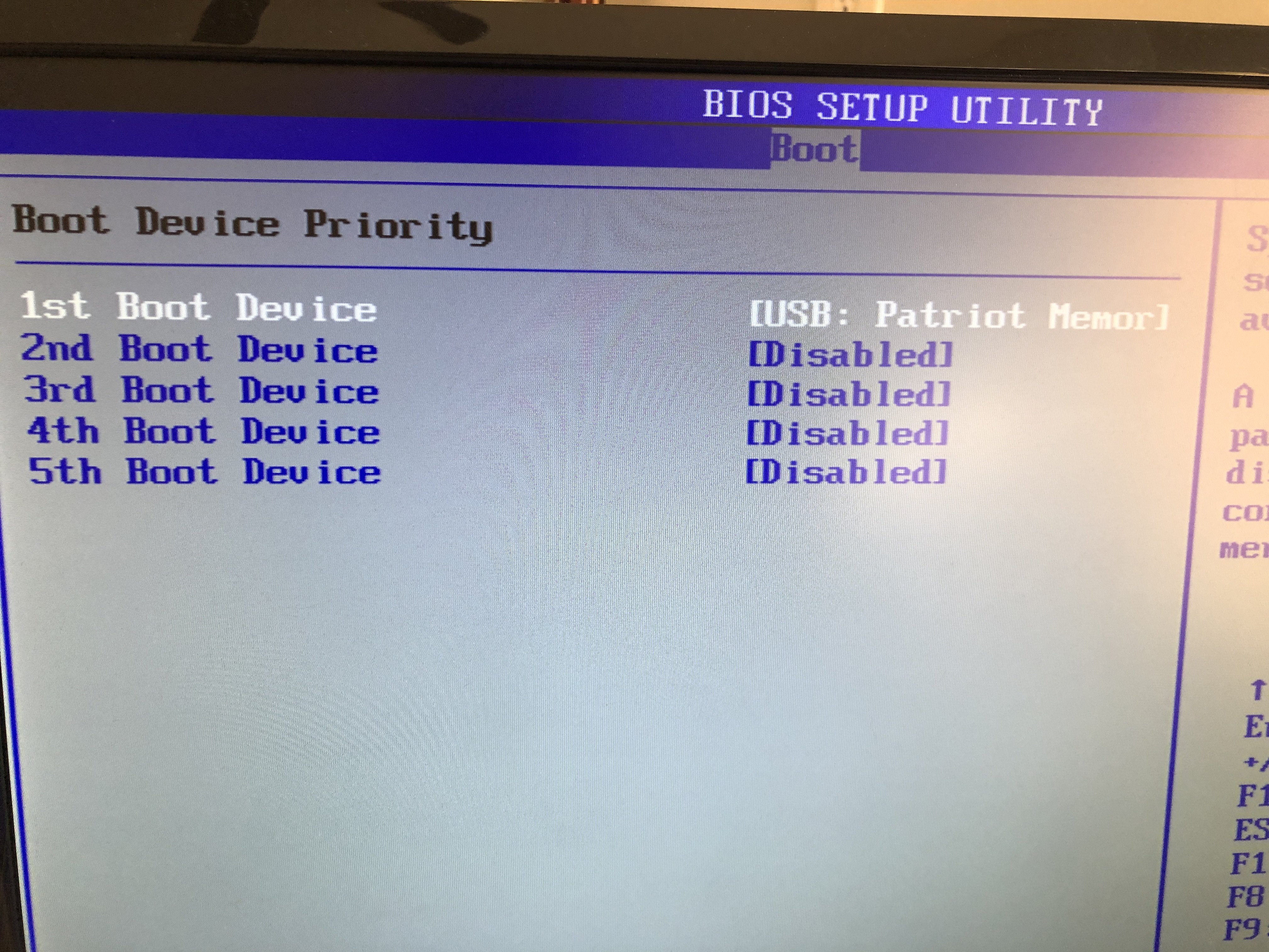

Most likely you have your boot order setup wrong in the BIOS.  Post a screenshot?

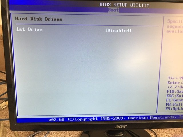

I wish it was that easy.  I even went so far as to remove all the drives from the setting where you could order the individual drives.
It doesn’t make sense to me that leaving both the WD and Seagate installed keeps it from booting to the flash drive but removing either drive and it’s fine.
I’m also not sure why the HDD activity light on the Seagate is on solid.

Since it worked before have you tried undoing everything you changed? Maybe try setting things back to defaults and changing just the essential settings back like VT/VT-d?
See, if on the Hard Disk Drive BIOS menu, if you can set the Flash Drive as the first 'hard' drive.
I booted initially with the BIOS set to defaults and all the drives installed and it wouldn't boot.  That's when I changed the boot order.
One more thing, you can check is to see if there is an update to the MB BIOS.
In the back of my mind, there were some MB's that had difficulty booting from a flash drive after a certain number of hard drives were added.  (looking at that 2009 copyright date...)
The USB drive shows up under USB Drives and isn't shown under the HDD section.  It's a Supermicro case with 36 bays, so I hope it doesn't choke after 12 or 13 drives.  The BIOS is current according to the Supermicro website v3.5c (3/18/16)
