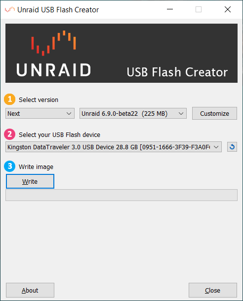

With the Unraid USB Flash Creator you can select the last beta :
(I know my USB drive is not the best choice, it was just a test with the first one on hand ;) )
(I know my USB drive is not the best choice, it was just a test with the first one on hand [emoji6] )
Omg...lol...I didn’t even check the usb creator cause I’ve had suck bad luck with it so I’ve been downloading the zip, extracting and then make the drive bootable
Thx! I’ll tinker with that tomorrow
