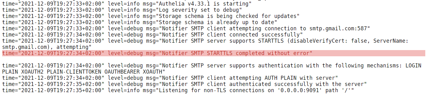

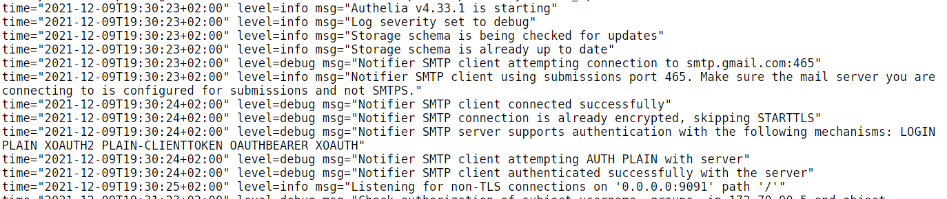

December 9, 20214 yr have question about smtp port , im using 465 and its ok but its like old port for SSL and for TLS better to use 587 like in video guide? but i have some red line when i change to 587 this log for 465 so what port is better to use ?
December 9, 20214 yr Author 3 hours ago, Masterwishx said: have question about smtp port , im using 465 and its ok but its like old port for SSL and for TLS better to use 587 like in video guide? but i have some red line when i change to 587 this log for 465 so what port is better to use ? Both are fine it really depends on your SMTP provider and what they require
December 10, 20214 yr 21 hours ago, Sycotix said: Both are fine it really depends on your SMTP provider and what they require Thanks i got it ,im using google SMPT jsut didnt understand why is red line on 587 and i though 465 is obsoled port but after i founded info in : https://github.com/authelia/authelia/issues/2194 and https://datatracker.ietf.org/doc/html/rfc8314 so i understand there is a little confusion about thouse ports in SMTP usage, but like you said they both OK...
