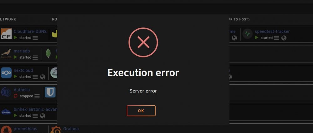

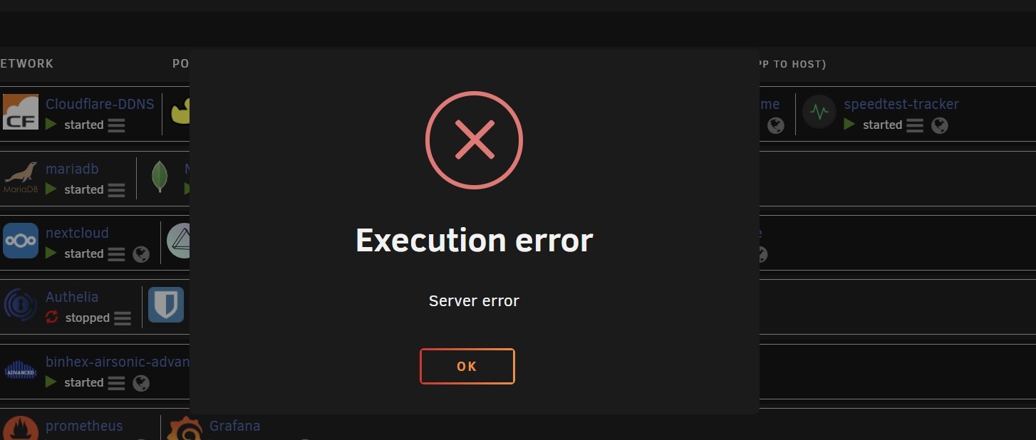

September 1, 20215 yr 3 hours ago, xxbigfootxx said: Follow this video: Very good guide on how to set it up. This what i followed ... also guide from ibracorp website (they made cool job) but having server error on start up authelia docker! but no auto config file when created authelia docker. Also deleted and recreated container some times but having same error . 1. maked database in mariadb 2. installed redis + bitnami folder 3. when making authelia container no auto making config ?!? then i dowloaded original config and from ibracorp github also edited config with my data and copied to Authelia empty folder made other stuff like auth.myserver.com but same error ...
September 1, 20215 yr You'll need post your authelia logs so I can see what the exact error is. Also I found that copying full config file and editing that worked best for me.
September 1, 20215 yr 41 minutes ago, xxbigfootxx said: You'll need post your authelia logs so I can see what the exact error is. Also I found that copying full config file and editing that worked best for me. The problem i dont have Authelia log becose of Server error ( Execution error)

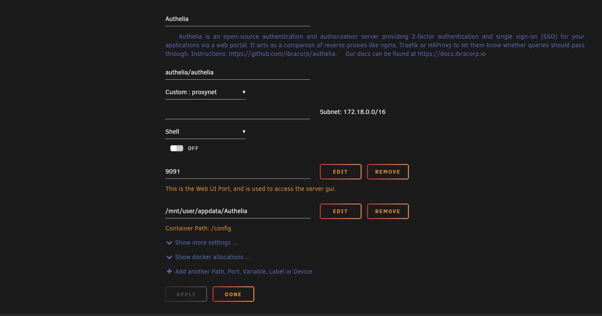

September 1, 20215 yr Can you send screenshot of your docker settings? And where you can see execution error
September 1, 20215 yr 2 hours ago, xxbigfootxx said: Can you send screenshot of your docker settings? And where you can see execution error i Solved the problem by changing port to 9092 (9092:9091) some how i having error on 9091 (9091:9091) but i have no other docker on port 9091 ...
September 1, 20215 yr You won't typically get that error even if another application is using the same port. It will still add, it just won't start the container as something else is running. That error usually means there's an issue with docker image. But if it's working now, that's good.
September 1, 20215 yr 1 hour ago, xxbigfootxx said: But if it's working now, that's good. Yes its running without errors but cant get to WebUI ... Wow 😱 i only now founded that i Prometheus MSI Afterburner Exporter on 9091 running (forgot it) i will change it to another port Thanks
September 1, 20215 yr 1 hour ago, xxbigfootxx said: You won't typically get that error even if another application is using the same port. It will still add, it just won't start the container as something else is running. That error usually means there's an issue with docker image. But if it's working now, that's good. Finaly all working after changed port back to 9091 and prometheus msi exporter 9092 ... The question - we can add users only by adding them to users_database.yml file manualy like in video we added first user ?
