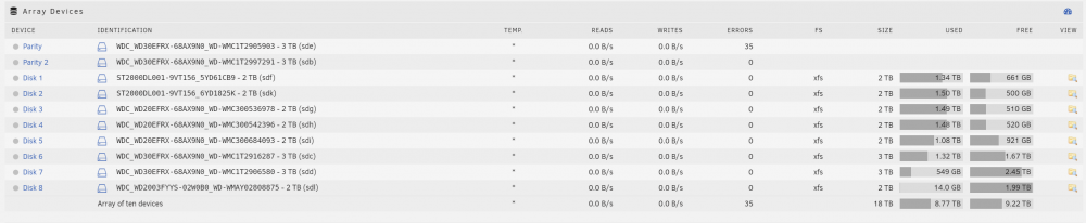

I just noticed that i have 35 errors on my parity drive.  I accidently cleared the notifications so i couldn't figure out when it happened.  I did have a parity check done on 7/1, and it completed and says with 0 errors.  I ran an extended smart test (i think it took about 6-8hrs) and i've attached it along with a diagnostic.
The smart test said that it completed without errors.
Is this something to worry about?
