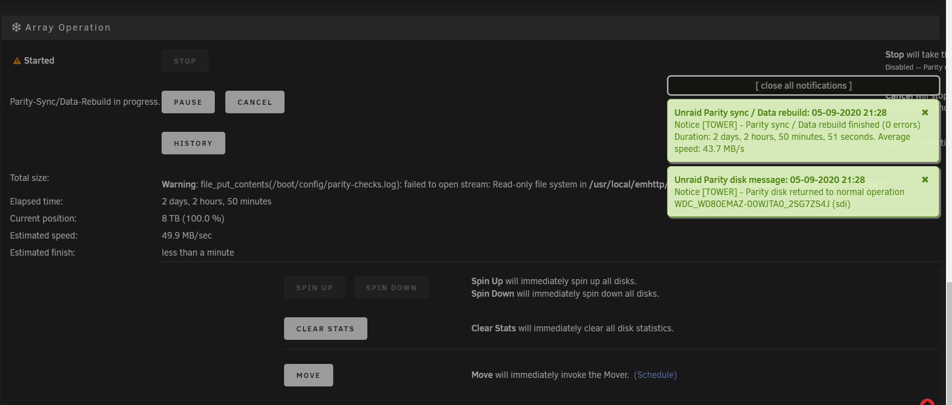

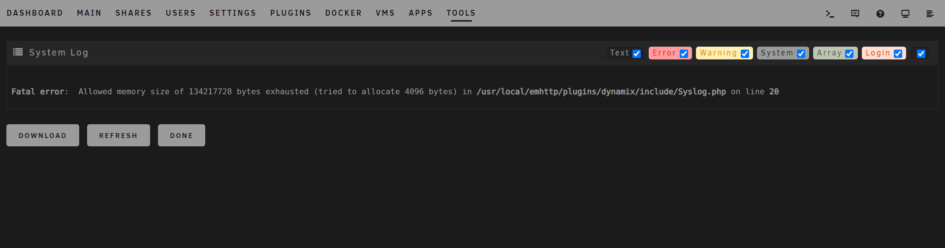

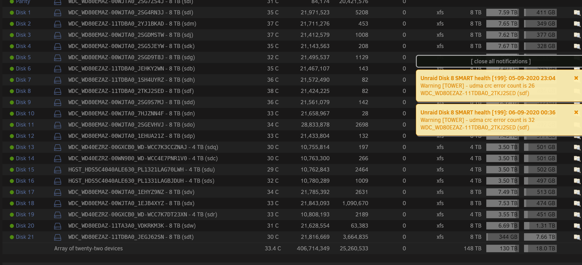

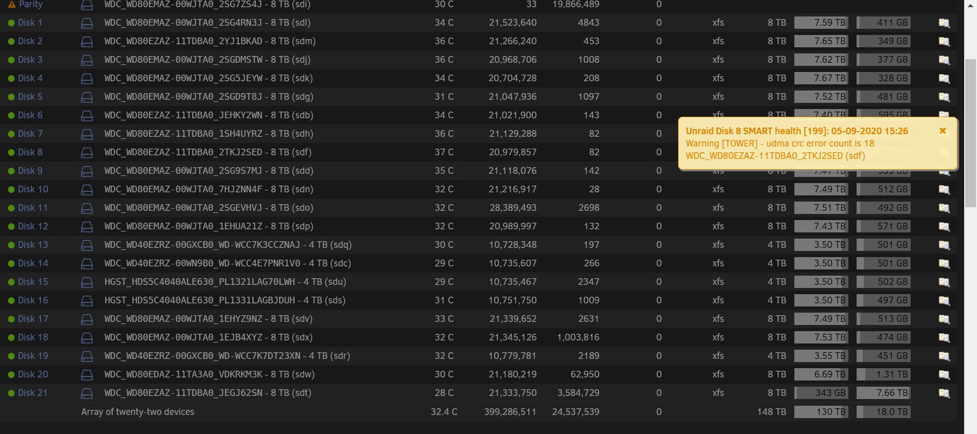

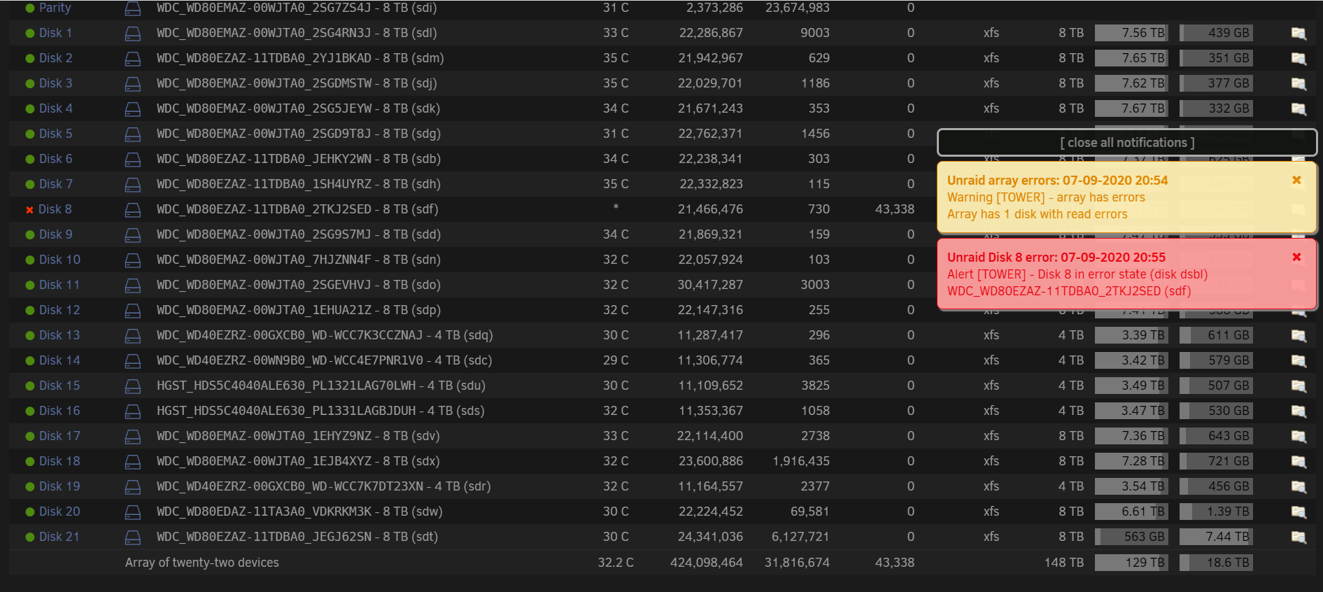

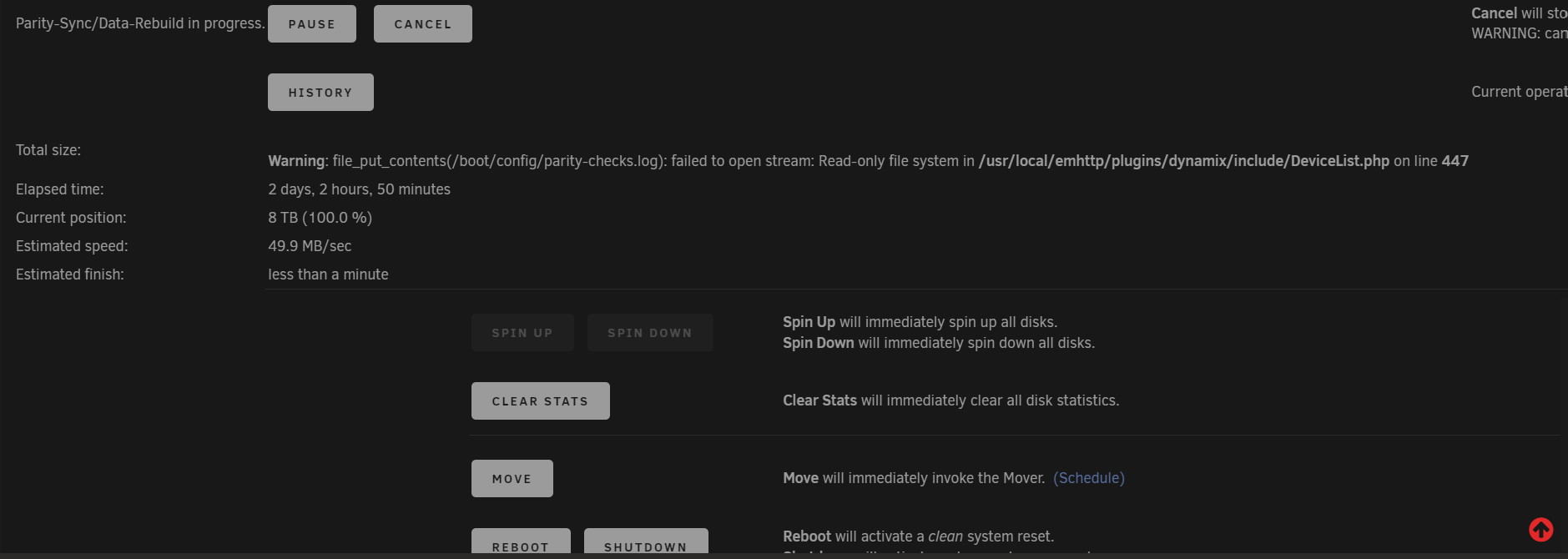

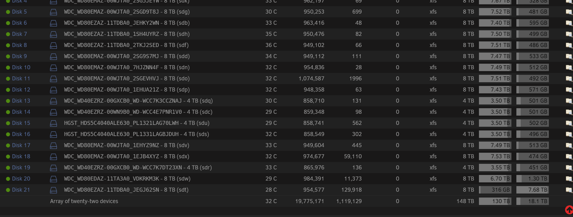

@trurl The rebuild for disk 11 finished and I have attached the diagnostics after it was done and some screenshots of disk 8 showing a few errors. Disk 8 has now completely failed. I have included diagnostics before and after the disk 8 errors. I also took a screenshot of the error in the syslog. I have not rebooted, stopped the array or even touched it since I got the error last night. I don't want to mess this up when I have two disks that have error-ed so close to each other. I ordered a 12 tb Parity drive so I can have dual Parity and hopefully if this ever happens again I can feel a little safer.  Please let me know if you need anything else I tried to capture every screen every diagnostic all weekend long I just didn't want to bother you during the long weekend.
Thank you,
GTP
after parity rebuild diagnostics.zip tower-diagnostics-20200907-2127.zip
SMART attributes for disk8 look OK. CRC errors are connection issues, not disk problems. Run an extended SMART test on disk8.
We didn't discuss rebuilding disk11. According to syslog and the "Parity disk returned to normal operation", you were rebuilding parity not disk11.
Sep  3 18:37:07 Tower kernel: md: recovery thread: recon P ...
Sep  3 18:37:07 Tower kernel: write_file: error 30 opening /boot/config/super.dat
Sep  3 18:37:07 Tower kernel: md: could not write superblock file: /boot/config/super.dat
That snippet also indicates problems writing to flash so you have another issue.
There is a gap in syslog from those diagnostics. Maybe you have other syslogs in /var/log that didn't get included and they would contain a rebuild of disk11 if you did indeed rebuild disk11. And your log folders are full. What logs did get included suggest lots of repetition of the same connection issues and some ACPI errors I don't know about. Maybe that is why the diagnostics is missing disk11 rebuild.
Another reason your log folders might be full is this next thing I just noticed.
In addition to the docker configuration problems I mentioned earlier, I just noticed that you are installing every package from NerdTools. Why? Do you even know what some of those are? I recommend not installing anything you are not using. With NerdTools, unless it is something you use frequently, you might even consider uninstalling any package after you have finished using it. One of those packages is atop, which is notorious for filling log folders with its own logs.
I don't recall whether it has been discussed in this thread or not, but with the large number of disks you have, perhaps your power supply is marginal.
Uninstall any Nerdpack packages you are not using, especially atop.
At this point, you are going to have to shutdown just to get your logs cleared. And you should put your flash drive in your PC and let it checkdisk. While there make a backup of flash. Do you always keep a current backup of flash?
Your latest post has left me confused about the current state of your server. It isn't even clear what the correct order of those screenshots should be.
After fixing flash in your PC, reboot and post new diagnostics.

No you were right I was rebuilding parity, apologies Ok I have begun the extended smart test on disk 8 and no I do not know what the tools are, I just thought I had plenty of space and I would use them eventually. I am uninstalling the nerd tools as instructed. I actually run parallel power supplies just for that reason. The disks in question are on the main power supply though. I will absolutely make a backup of flash.
Sorry about the screenshots I thought it would order them by date. It goes 4-2-3-1.

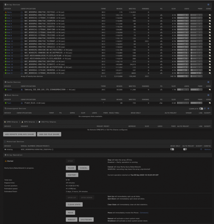

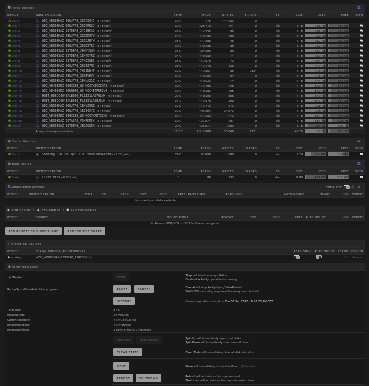

@trurl You are correct it looks like after I restarted it is attempting to rebuild Parity again. I have attached the screen shot.
Best,
GTP
There were already some read errors on disk10, this means parity won't be 100% correct, doesn't look like a disk problem, I would start by updating both LSIs firmware:
