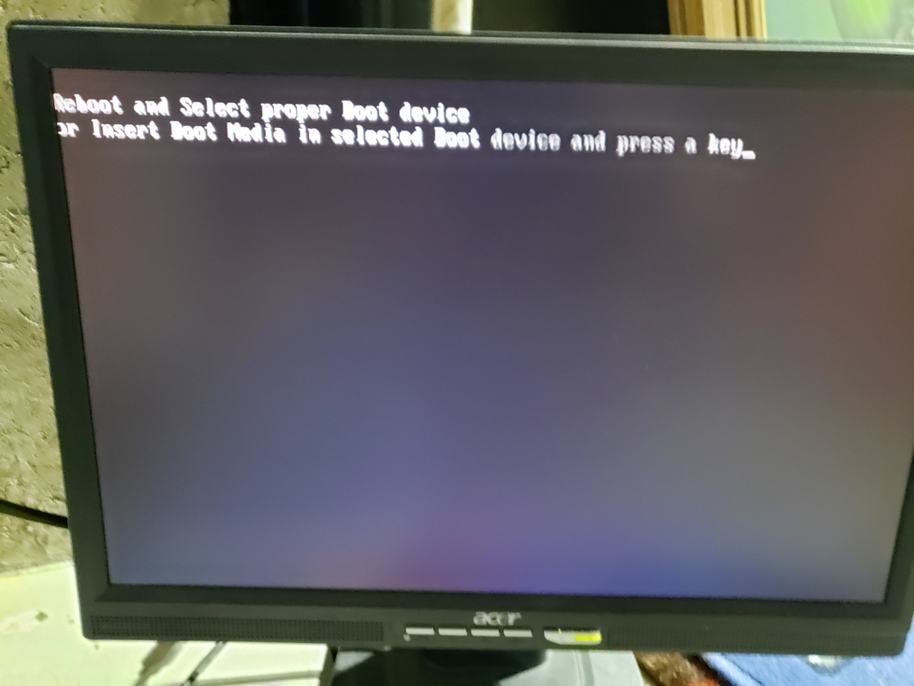

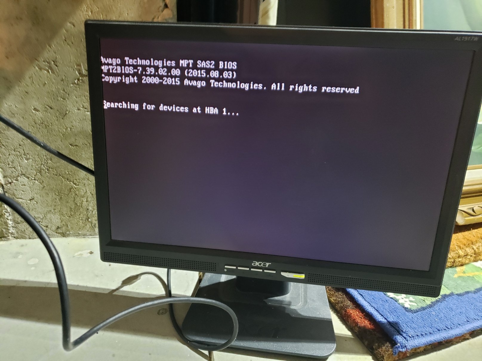

@JorgeB I also ran the Flash drive on the server with no drives plugged in and I was able to boot the Unraid OS. I then plugged in all my drives again and I am getting the same error "Reboot or select proper boot device".

Ok, you probably have an issue with the boot order in BIOS.
Are you sure that the Flash drive is the first (and ideally the only) boot device ?

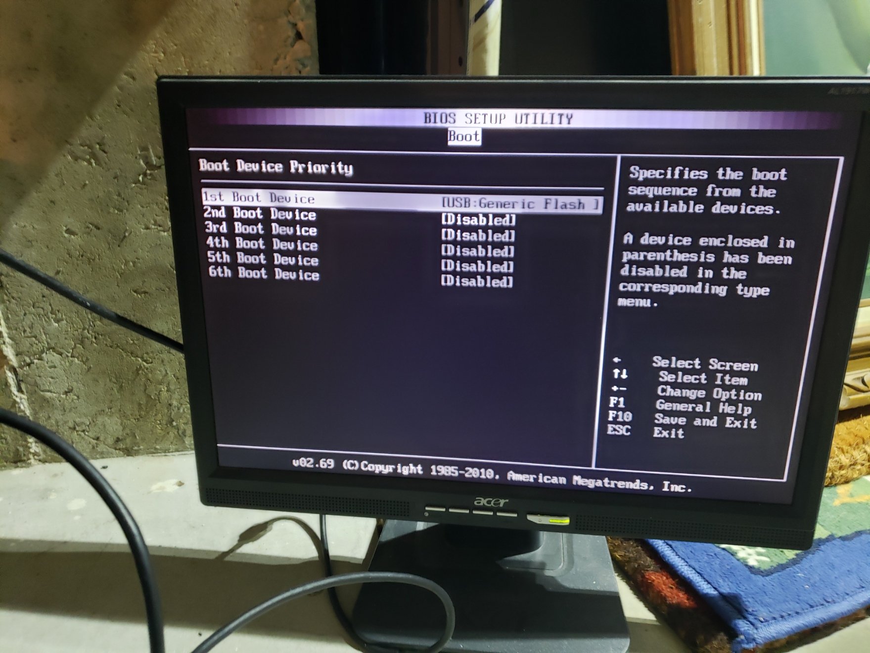

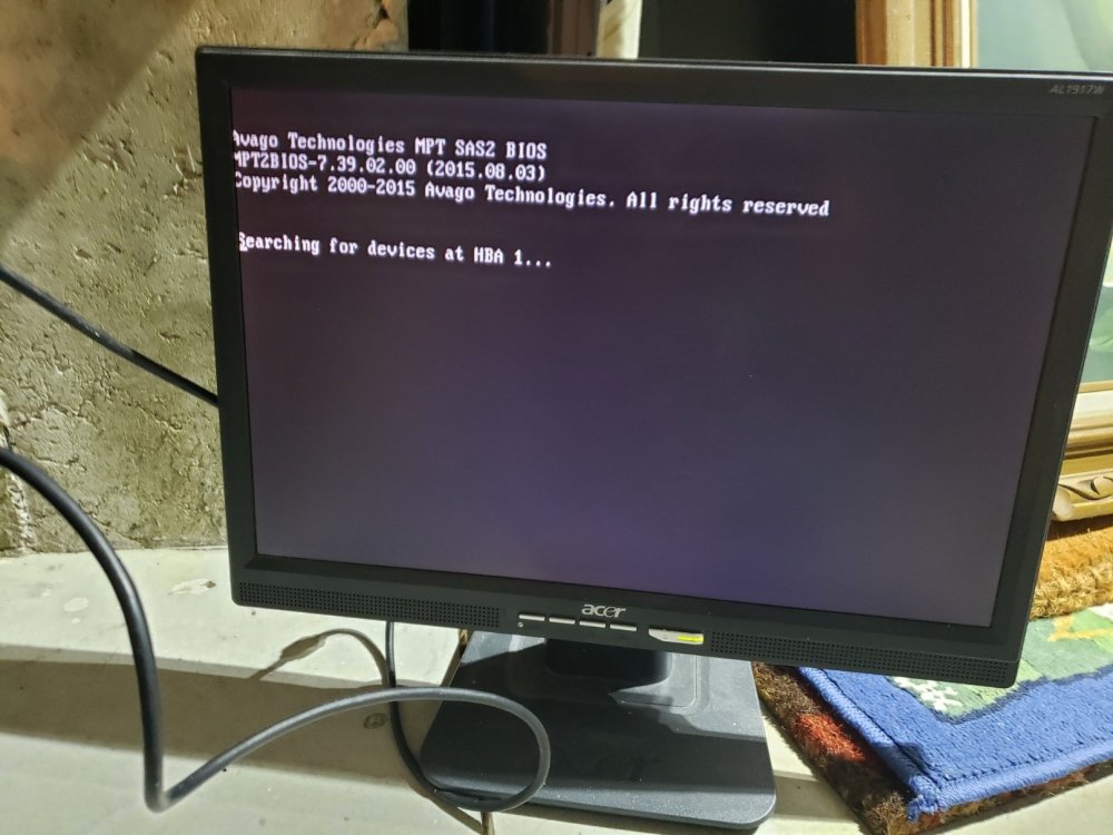

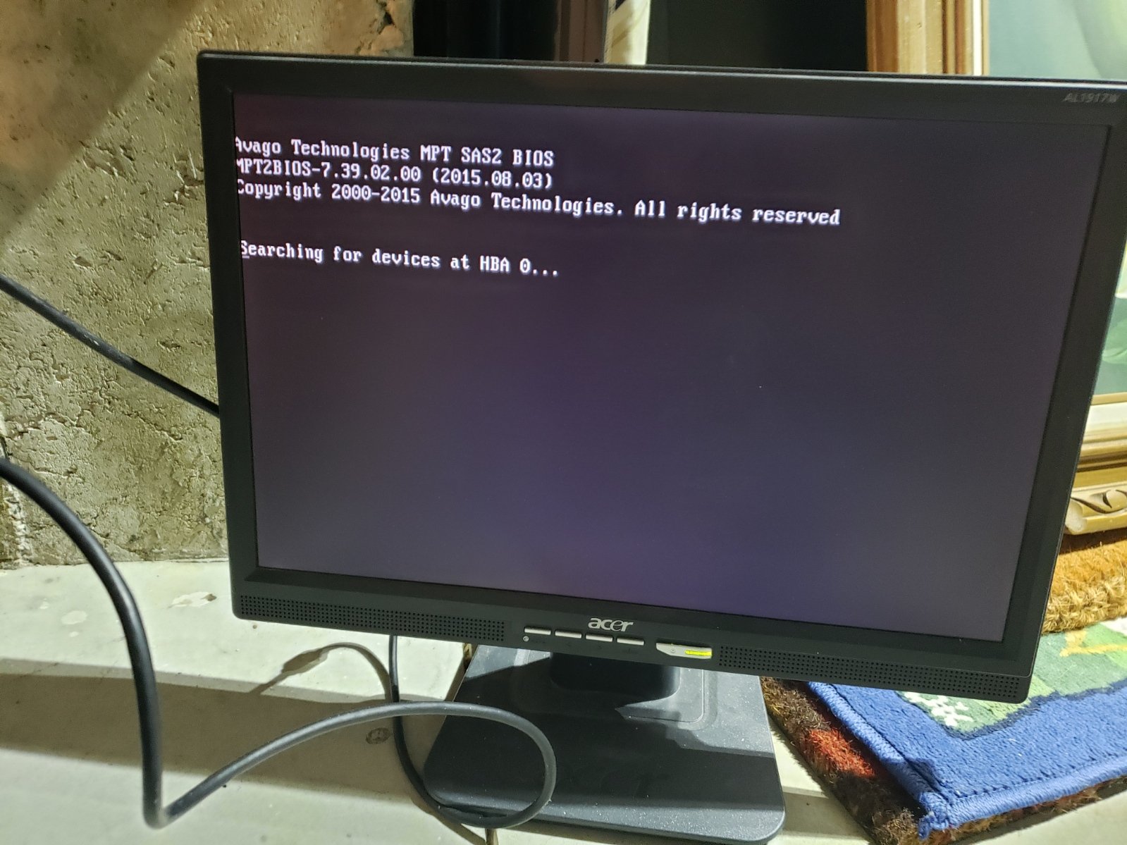

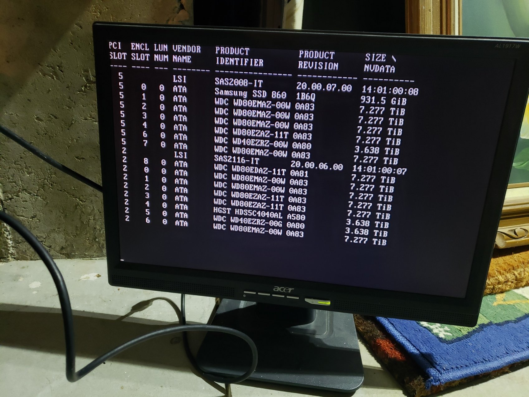

@ChatNoir Positive, I have attached screenshots of the bios boot screen and some other screenshots where it seems to be searching HBA 0 and 1. Thank you for taking a look at this. I have no idea what I am doing wrong the firmware is updated. I have checked all the connections and I even started the server with just the flash drive inserted and UNRAID booted up fine.

BIOS sometimes tries to "help" when you add disks and changes the boot device. Make sure it is still trying to boot from flash after you connect the disks.

Some BIOS have issues when there are many other possible boot devices, you don't need the BIOS on the LSI, disable OPT ROM BIOS on the board BIOS, if that doesn't work to suppress the HBA BIOS you can delete them from the HBAs since they are not needed for Unraid, and it will make booting faster anyway.

@JorgeB @trurl That was it! Disabling the OPT ROM BIOS on the board bios solved the boot issue. I am now booting fine and running a parity sync before I switch out my 8tb for my 12tb. Thank you all for your help I will post this as solved once the Parity Sync is complete.

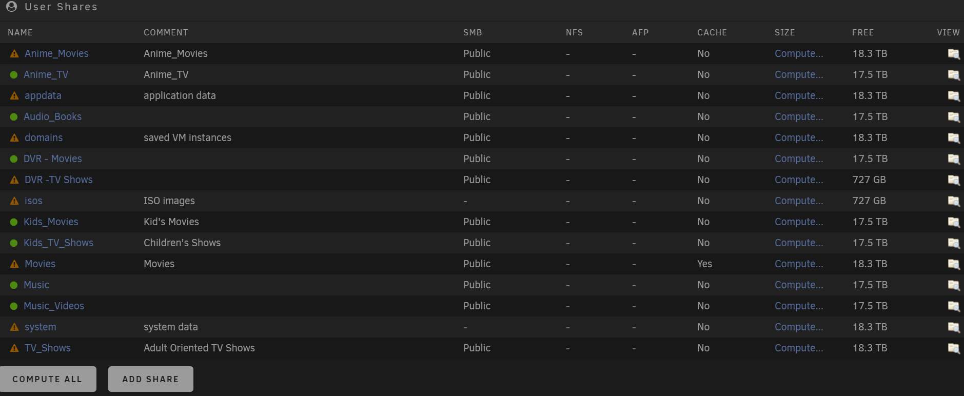

@JorgeB @trurl Just one quick question before I mark this issue as solved. Why are some of my shares showing as unprotected anfter I just completed the Parity Sync? I have attached a screenshot below. Thank you again.

Any share that has files (or just even the top level folder) on cache, like the M----s share for example, will say unprotected, since you have a single cache device, set them to cache="yes" and run the mover, so everything is moved to the array.

Attachment seems to have not happened. If any of the files for a user share are on cache, and cache has no redundancy, you will get that warning. I have no redundancy on one of my pools (appdata, etc) but it is backed up.

Yes, if you want to have everything on those shares in the array after the mover runs (and use cache for initial transfer).
