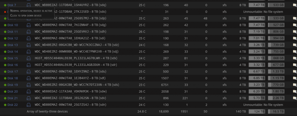

@trurl I ordered another 12TB drive so I could have dual parity and I attempted to install it last night. I have checked and rechecked my connections and taken my server completely apart multiple times but I keep getting errors on disk 9 and 22 and it has a red x on disk 8 and says its disabled. I know you might not be able to respond right away but I have attached logs. I have the 12tb installed and ready to go but I can't even start the array right now with read errors.
Thank you,
-GTP

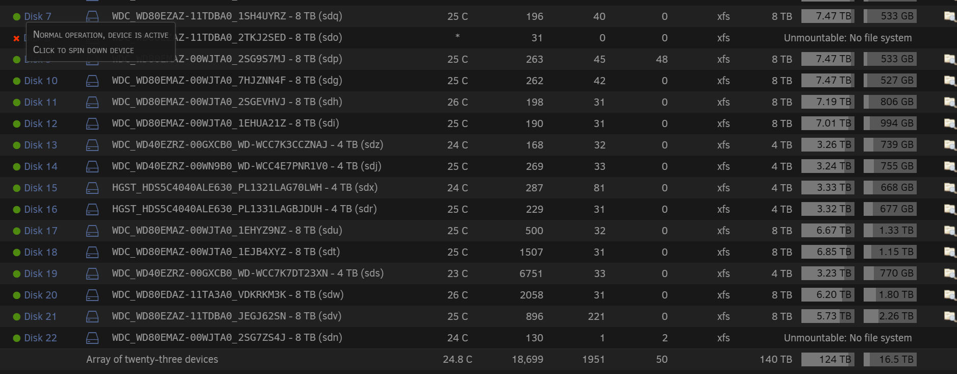

@trurl @JorgeBI think I fixed the power/connection issues as all the disks were recognized. But I still have a red x on disk 8 and now disk 22 has 2 read errors and disk 9 has 48. Disk 22 was the former Parity disk that I was turning into a data disk. I was trying to install with the new 12tb parity so I could have dual Parity. My point is it only had like 37.5 gb on it but it says unmountable. I have attached the diagnostics while I am running the extended SMART test on disk 8. I just wanted to protect the array with dual parity now I have this mess on my hand. thanks for your help.
-GTP

Seems like we are going back over things already discussed in this thread.
Possibly emulated disk8 is being corrupted by the errors on other disks and maybe the physical disk8 is mountable.
Still mounted disk9 is also showing corruption but that might just be the errors again.
SMART for each disk in question looks OK.

I really don't know what else to do I have changed every connection, ordered new cables and made sure everything was seated correctly. Why does it keep showing up on these drives if I changed the sata and power source?
I don't know maybe it is one of the cables and I switched out the wrong one. I will keep trying after the SMART tests complete. How long does the extended SMART test usually take its still at 10%? I ordered some different new power splitters so maybe that will help too.

This time there were issues with disks sdn, sdo and sdp, they likely share the same miniSAS cable, so I would start by replacing that.
Ok I ordered all new miniSAS cables and installed them today. All drives are recognized and so far no errors except disk 8 again. I have attached diagnostics. I don't want to do anything until @trurl or @JorgeB tell me too but I think the next steps are to start the array in maintenance mode and check disk 8 and then repair it if necessary but I will wait until I hear from one of you before I do anything. At least disk 22 and disk 9 seem to be ok now with the new cables... I have the dual parity disk as unmounted right now but after we know the array is stable I would like to add dual parity just to be safe. I really appreciate your patience with me and my server she has been very fussy lately and I appreciate both of you helping me get her healthy again.

Emulated Disk8 appears to be mounting correctly, if contents look OK and there's no filesystem damaged (like a lot of lost+found stuff) rebuild on top.
Everything looks ok so I went ahead and started he rebuild @JorgeB Thanks for the advice. After the rebuild, I will confirm that all drives good and then I want to add dual parity. I just need to stop the array add the disk into Parity 2 and press start array right?
