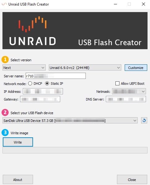

Alright, so this is making some more sense, but can you give some explicit stepwise instructions as to what you did? I tried with both "Allow UEFI Boot" and not with it. So here for example are my steps that I tried (that have not worked):
1) insert flash drive into Windows computer
2) run Unraid USB Flash Creator with these settings (this is for the MBR/BIOS attempt that also failed):
3) took USB flash drive out of Windows computer
4) inserted USB flash drive into Linux computer (Pop!_OS in this case)
5) wrote your MBR image with this command:
sudo dd if=MBR_HardDisk4.dat of=/dev/disk/by-label/UNRAID bs=446 count=1
6) took out USB flash drive
7) inserted USB flash drive into R710 with BIOS boot turned on
8 ) started R710 server and waited for it to try to boot - failure to detect a boot device.
