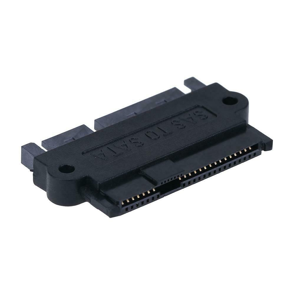

----- LSI SAS2008 in PCI Express - Eight external drives
[1:0:0:0] disk HITACHI HUS72403CLAR3000 C370 /dev/sdd 3.00TB -- SAS to Sata
[1:0:1:0] disk ATA WDC WD30EZRX-00D 0A80 /dev/sdg 3.00TB
[1:0:2:0] disk HITACHI HUSRL402 CLAR200 C140 /dev/sdh 200GB -- SSD SAS to Sata
What do you mean by "SAS to SATA"? Is this a physical adapter? Can you perhaps point to a similar product page?
At any rate, the next thing I'd check, in parallel with this thread, is the cabling of the drives - SAS and SATA - start with sdd and sdk but would probably go over all of them, just to be safe.
Yep! Image attached. Ebay link here
Spoiler
If I run my tests after reinstalling the plugin and the problems surface again I'd be surprised if it's a cable problem, but it never hurts to check. I'll go and have a gander when I need to hard off the machine.
You're right. If spinning down your /dev/sdd would trigger a similar issue again, then we'd have to conclude that your drive model - HUS72403CLAR3000 - is one of those which do not properly support the STANDBY command, and, sadly, it will need to be added to the list of "excluded" drive models in the plugin. Net-net it would mean that the plugin will not be of value to you.
If you want, you can test for this issue, when the array is quiesced so as not to trigger another parity check. Let me know if you want to try that.

I'm cool to try any tests you want :) I read the description of the SAS-Sata adapter and it mentions "Before buying, please check the manual to see if it supports SATA mode because it is not compatible with all SAS hard drives." This could all be the adapter's fault. I'll have a think and see what would be the cheapest/easiest way to get the adapter out of the setup. I may have to get an SFF 8088 to 4xSFF 8482 cable just to connect the two SAS drives.
Let's discuss this for a moment.
The adapter you pointed at is a physical connector adapter; it can connect a SAS drive to SAS-capable(!!) ports having SATA form factor, such as those found e.g. on some Supermicro motherboards. Those ports are not SATA ports; they are SAS ports (in fact, SAS-SATA ports, because they can "speak" SATA protocol as well).
No adapter can connect a SAS drive to a SATA-only port.
Now, I have been assuming that you use this adapter to connect your SAS drive to a SAS controller that has SATA-style ports. Can you re-confirm that this is indeed the case.
Assuming we are indeed talking about SAS ports, you can
(a) Stop the array (so as not to cause yet another parity panic)
(b) Identify the SAS drive. Let's assume it's /dev/sdX
(c) Issue these commands from a command line:
