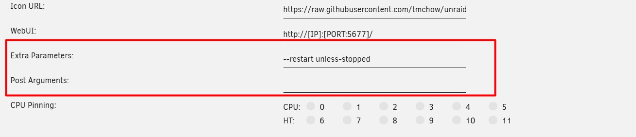

    3) With everything installed, go to the "Docker" tab and at the bottom of the page click on "ADD NEW STACK" Name it "N8n" and specify the appdata path "/mnt/user/appdata/n8n"

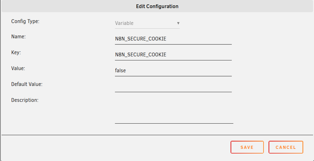

On 9/23/2024 at 6:42 AM, issabankz said:
Did you find a solution to this? I want to use it with SWAG, but I’m also stuck on the local network with that window and cannot access it via an external domain.grafik.png.43ba97f66e81f6844af289cee4abaa8f.pnggrafik.png.e62c33065fef296420531dedf39b8709.png
The solution to this is given on the last line. Create a new environment variable in the docker config.
Click
Add these details
Save and apply.

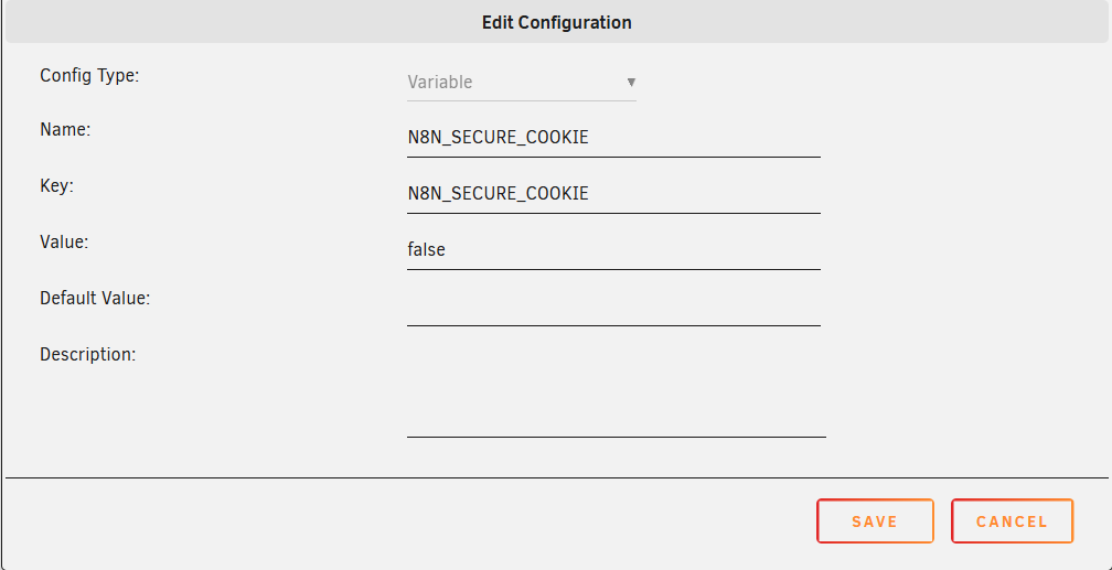

Click
Add these details
Save and apply.
Thank you for the hint i will give it a try.
