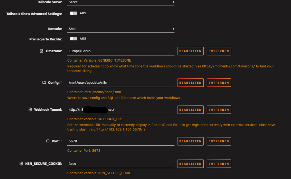

I can confirm its working now after 2 changes on the template:
-Change webhook variable to WEBHOOK_URL
-Change PATH of config from /root/.n8n to /home/node/.n8n
Thank you for the fix.

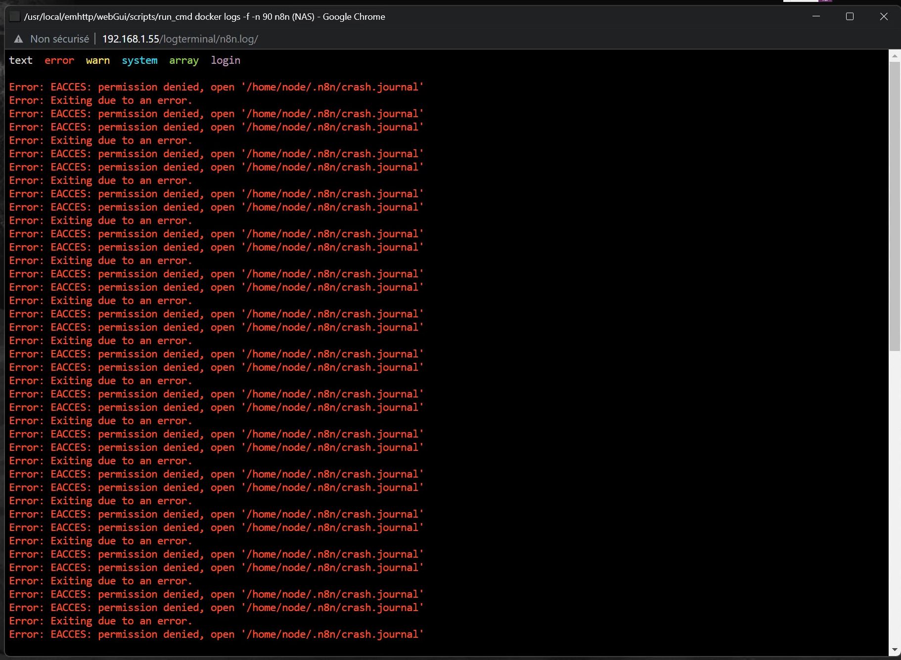

Hi, tried to install the n8n container but it does not start properly. The log windows just popup and close. I was able to catch it with a screen record. Below the screen shot.
Any idea of the problem ?
Thanks for help.
Thanks for help.
The problem is that the user running the container (node) is unable to write to your app folder. To fix it, set the user id and group id of that folder to 1000:1000. You can run the command below from the Unraid server terminal.
chown 1000:1000 /mnt/cache/appdata/n8n
Hope this helps!

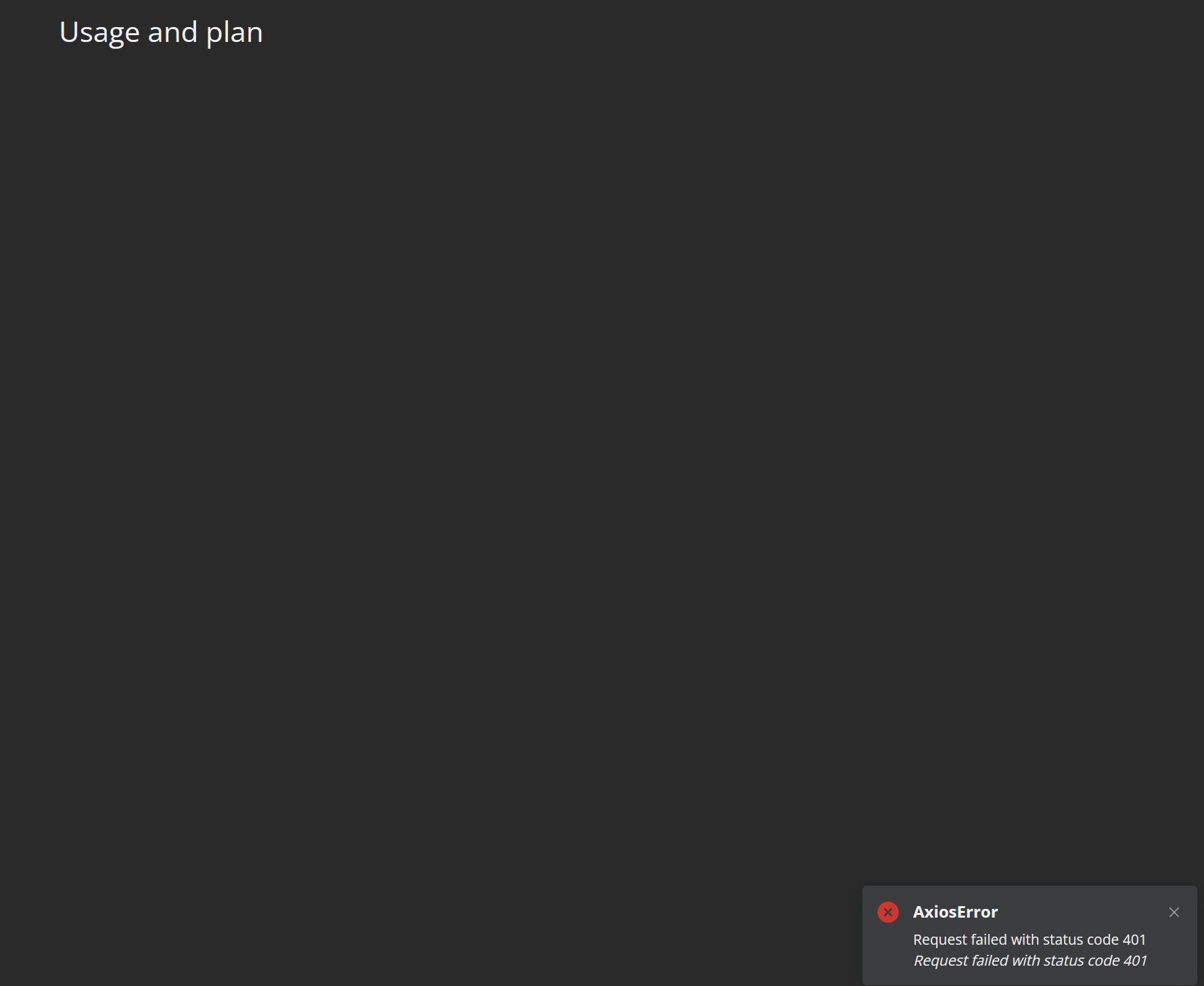

When I log into my container (been using it for a couple of years now, and did the migration a year ago when it was needed) I now receive the following screen (note I did the chown command noted above):
Navigating to Settings presents the following error
The personal page loads, and I tried to change my password but also get a 401.
Edited by SakabaRihiro

Fixed my issue below by changing to 1.29.1 per https://community.n8n.io/t/not-able-to-login-to-either-docker-or-npm-version-of-n8n-via-local-network/42120/2
Might work for you as well. Looks like there's a bug with the n8n docker that affects Unraid.

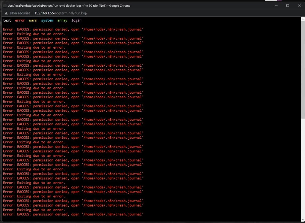

I attempted to install this docker container for the first time today. It is rebooting constantly, then shuts itself off. Here is the log it is generating. The error is repeated over and over (I removed duplicate entries before posting). I assume it is once per reboot.
(node:7) [EACCES] Warning: Error
module: @oclif/[email protected]
task: findCommand (user-management:reset)
plugin: n8n
root: /usr/local/lib/node_modules/n8n
code: EACCES
message: EACCES: permission denied, open '/home/node/.n8n/config'
See more details with DEBUG=*
 ›   Error: command start not found
Edited by loosenut76
I missed this part at the bottom of the docker overview text. After running chown 1000:1000 /mnt/cache/appdata/n8n the docker container worked.

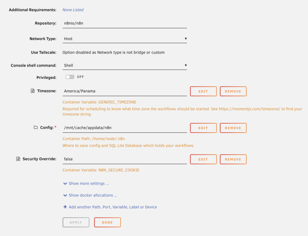

 Important: To avoid permission denied errors, you must ensure the user id and group id of that appdata folder to user:group of 1000:1000. Run this command in the terminal chown 1000:1000 /mnt/cache/appdata/n8n.
