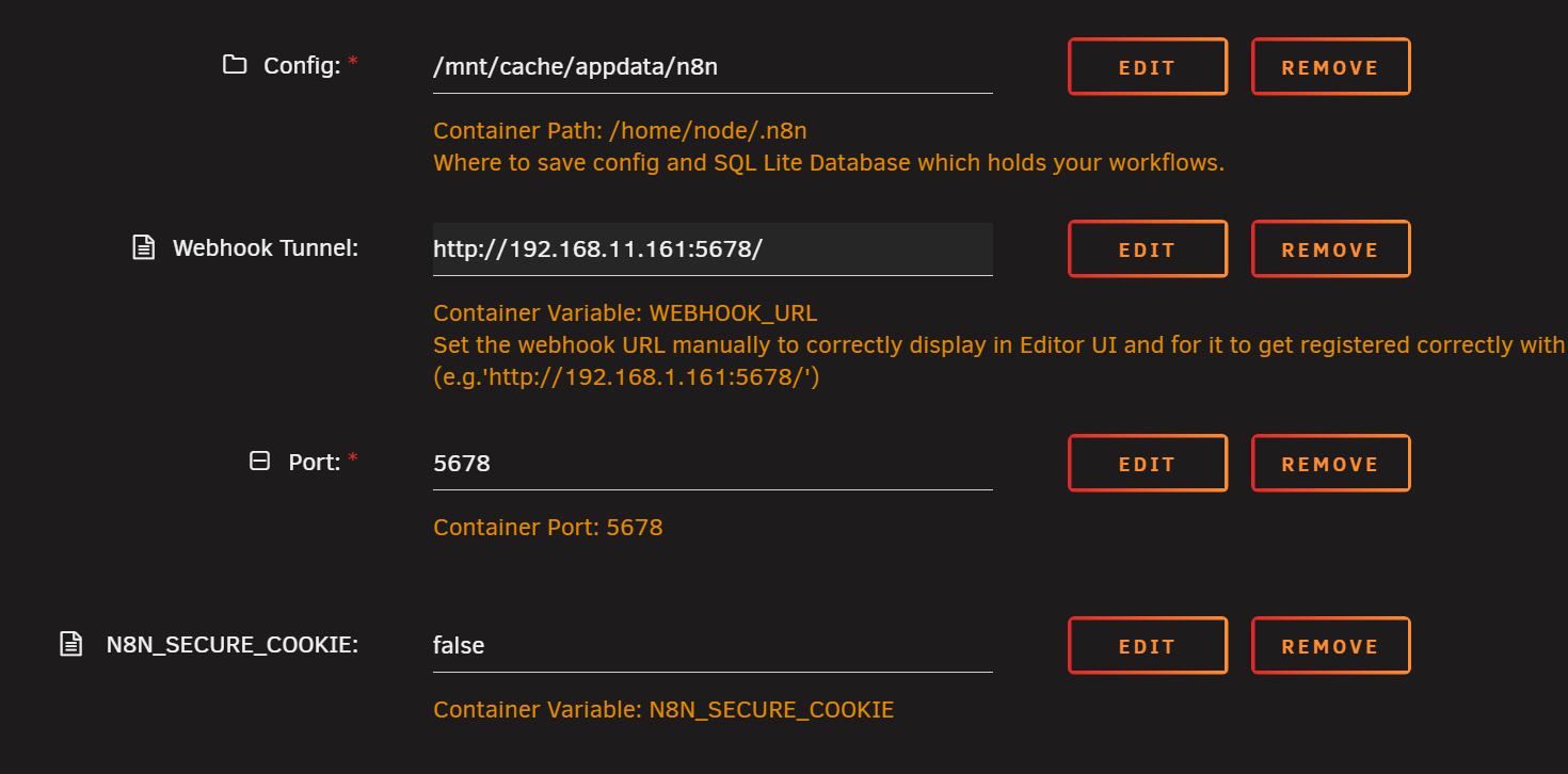

I too am still getting this error after setting the container variable to not use secure cookies image.png

The issue is simply the config directory default is not pointing at the correct app data folder, and then it doesn't have the correct permissions.
To fix it:
  1. Edit the n8n container, change the Config directory to "/mnt/user/appdata/n8n" and apply that change.
  2. Stop the container.
  3. From an Unraid terminal run the following: chown -R 1000:1000 /mnt/user/appdata/n8n
  4. Start the container.
That should do it!
If you get the 'SSL' error when loading the webpage, you need to add a new variable to the template, N8N_SECURE_COOKIE with the value of FALSE

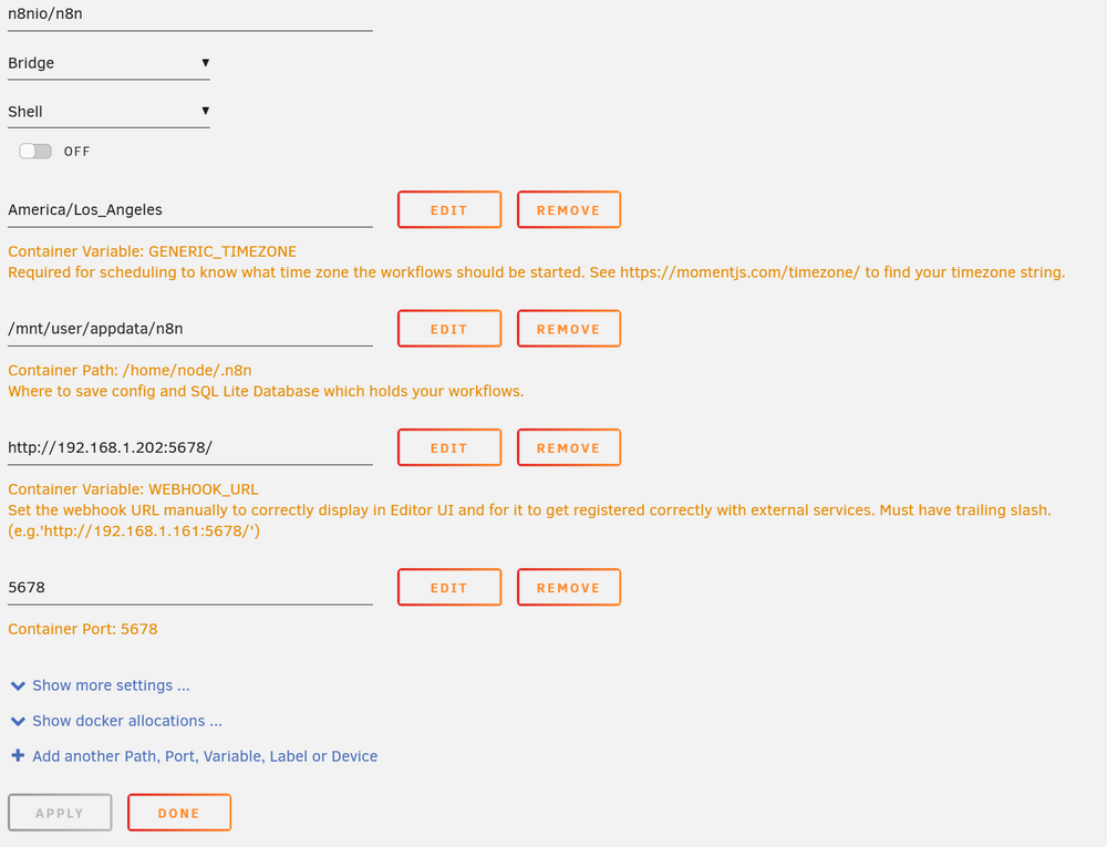

the webhook variable in the template ended up making me bang my head against the desk for about 24 hours until I realized my production webhook url was not my server IP.
I had set a base URL to expose the docker to receive google authentication, it changed my test URL to my domain name, but kept the production URL as an IP. but WRONG IP !!!
I was trying to add other docker URL variables to fix the "issue" when I saw your existing variable set to 192.168.1.161
Im not sure if I overlooked this variable during setup, or if I assumed it was set to this IP for a reason... without remembering I have this IP reserved for something in my house.
It is bad practice to hardcode IP addresses in the unraid docker templates.
best practice is to leave blank for user to fill in, or use localhost, as it is usually the most likely choice.

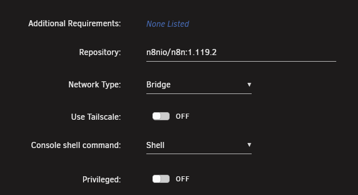

Template should be marked deprecated, it no longer works on a clean install
Workaround is by set a specific (older) version. -> https://hub.docker.com/r/n8nio/n8n/tags
this one worked for me:
n8nio/n8n:1.119.2

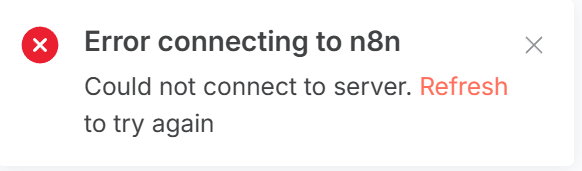

Hi thank you for making this docker.
I installed this docker on my Unraid NAS and can access it just fine from a windows PC, but for some reason, I cannot access n8n webui from my Mac that is on the same local network. I've tried different browsers, disabling firewall, disabling adblocker, VPN and the only message I get is "Error connecting to n8n Could not connect to server. Refresh to try again".
What could be causing this problem?

Hi guys, I´m having issues setting up tailscale inside the docker container.
I´m on Unraid 7.2.4 and installed the latest version.
These are my settings.
I am able to start the docker and get connection localy.
When trying to implement tailscale for external access I´ll get an error of docker not having root priviliges.
What can I do?
