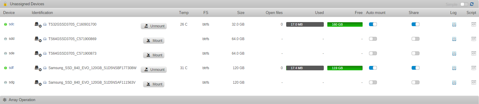

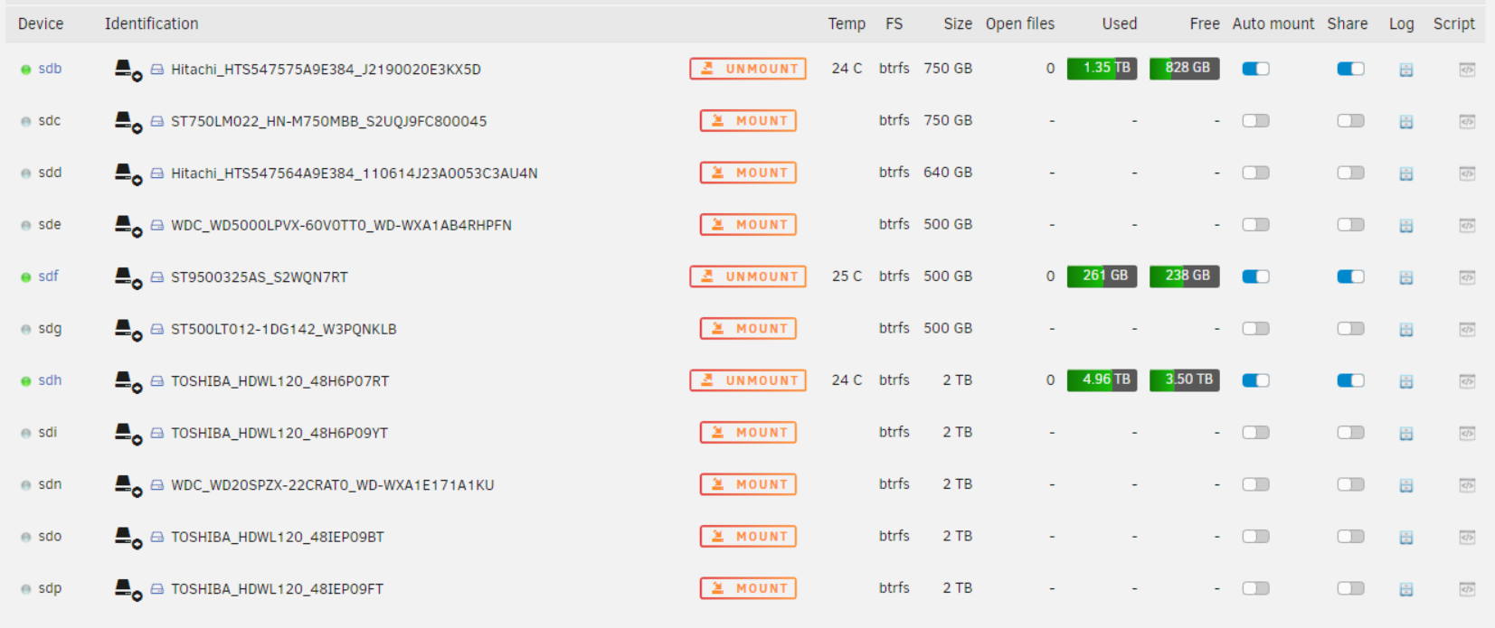

-You can have as many unassigned pools as you want, example how it looks on UD:
sdb+sdc+sdd+sde are part of a raid5 pool, sdf+sdg are part of raid1 pool, sdh+sdi+sdn+sdo+sdp are another raid5 pool, note that UD sorts the devices by identifier (sdX), so if sdp was part of the first pool it would still appear last, UD doesn't reorder the devices based on if they are part of a specific pool.
You can also see some of the limitations, i.e., no temperature is shown for the secondary pools members, though you can see temps for all devices on the dashboard page, still it allows to easily use multiple pools until LT adds multiple cache pools to Unraid.
