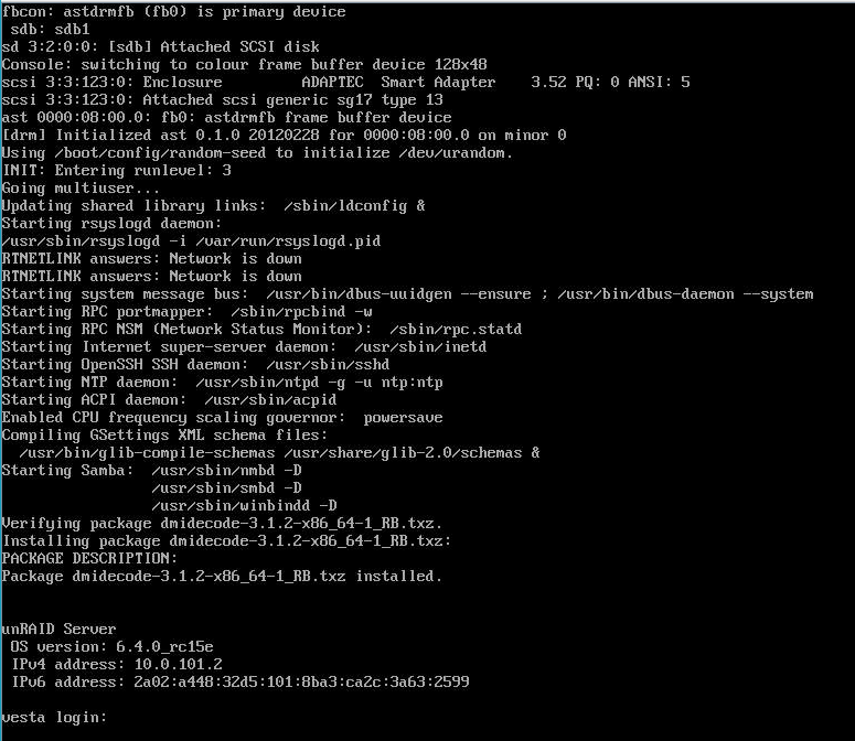

December 6, 20178 yr 3 minutes ago, limetech said: Last patch I could find in this area is here: That seems to work for me. Dec 6 09:25:43 vesta kernel: ipmi message handler version 39.2 ... Dec 6 09:25:43 vesta kernel: ipmi_si: probing via SMBIOS Dec 6 09:25:43 vesta kernel: ipmi_si: SMBIOS: io 0xca2 regsize 1 spacing 1 irq 0 Dec 6 09:25:43 vesta kernel: ipmi_si: Adding SMBIOS-specified kcs state machine Dec 6 09:25:43 vesta kernel: ipmi_si IPI0001:00: ipmi_si: probing via ACPI Dec 6 09:25:43 vesta kernel: ipmi_si IPI0001:00: [io 0x0ca2] regsize 1 spacing 1 irq 0 Dec 6 09:25:43 vesta kernel: ipmi_si dmi-ipmi-si.0: Removing SMBIOS-specified kcs state machine in favor of ACPI Dec 6 09:25:43 vesta kernel: ipmi_si: Adding ACPI-specified kcs state machine Dec 6 09:25:43 vesta kernel: IPMI System Interface driver. Dec 6 09:25:43 vesta kernel: ipmi_si: probing via SPMI Dec 6 09:25:43 vesta kernel: ipmi_si: SPMI: io 0xca2 regsize 1 spacing 1 irq 0 Dec 6 09:25:43 vesta kernel: (NULL device *): SPMI-specified kcs state machine: duplicate Dec 6 09:25:43 vesta kernel: ipmi_si: Trying ACPI-specified kcs state machine at i/o address 0xca2, slave address 0x20, irq 0 Dec 6 09:25:43 vesta kernel: ahci 0000:00:11.4: version 3.0 Dec 6 09:25:43 vesta kernel: ahci 0000:00:11.4: AHCI 0001.0300 32 slots 4 ports 6 Gbps 0xf impl SATA mode Dec 6 09:25:43 vesta kernel: ahci 0000:00:11.4: flags: 64bit ncq pm led clo pio slum part ems apst Dec 6 09:25:43 vesta kernel: ipmi_si IPI0001:00: The BMC does not support clearing the recv irq bit, compensating, but the BMC needs to be fixed. ... Dec 6 09:25:43 vesta kernel: ipmi_si IPI0001:00: Found new BMC (man_id: 0x002a7c, prod_id: 0x0857, dev_id: 0x20) Dec 6 09:25:43 vesta kernel: ipmi_si IPI0001:00: IPMI kcs interface initialized Though SMBIOS is not present in some of the other reports here. In my case both java tool and browser work.
