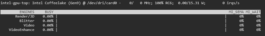

  5. @rushgunner have you got the Intel-GPU-TOP plugin installed? You might need this for an intel iGPU. Make sure it's updated.
