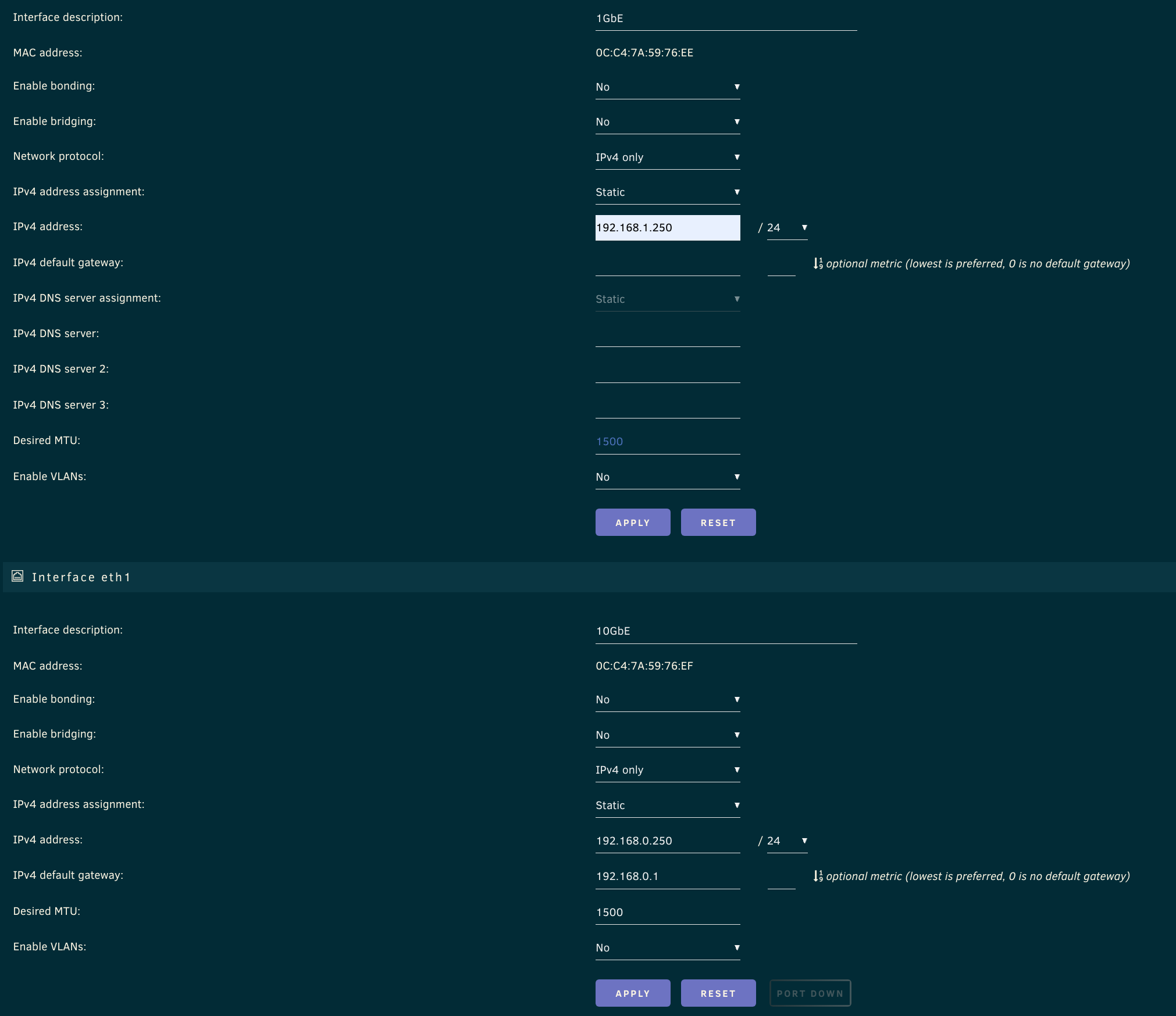

  12. Thanks. I worked it out myself. It turns out you don't even need to do that. If you just set DNS in eth0, even if it's a different subnet to eth1 and eth0 is not active unraid will happily use this DNS for eth1.
  13. Curiouser and curiouser. eth0 refused to connect to my router after trying multiple cables. However, after moving the router connection to eth1, eth0 now works fine with other connections. Several hours of testing later And the cable that was previously limited to 100 Mbps is now very happy at 1 Gbps. Not sure whether diagnostics say anything sensible about this? fs-diagnostics-20221007-1603.zip
  14. There's no internet connection on my server. I can ping the gateway 192.168.0.1. All other devices connected to the gateway have internet access. I can ping 8.8.8.8 and 8.8.4.4. But I can't ping google.com The network settings won't let me set DNS for eth1 only for eth0 (which is not connected to anything). Why doesn't eth1 let me access the internet?
