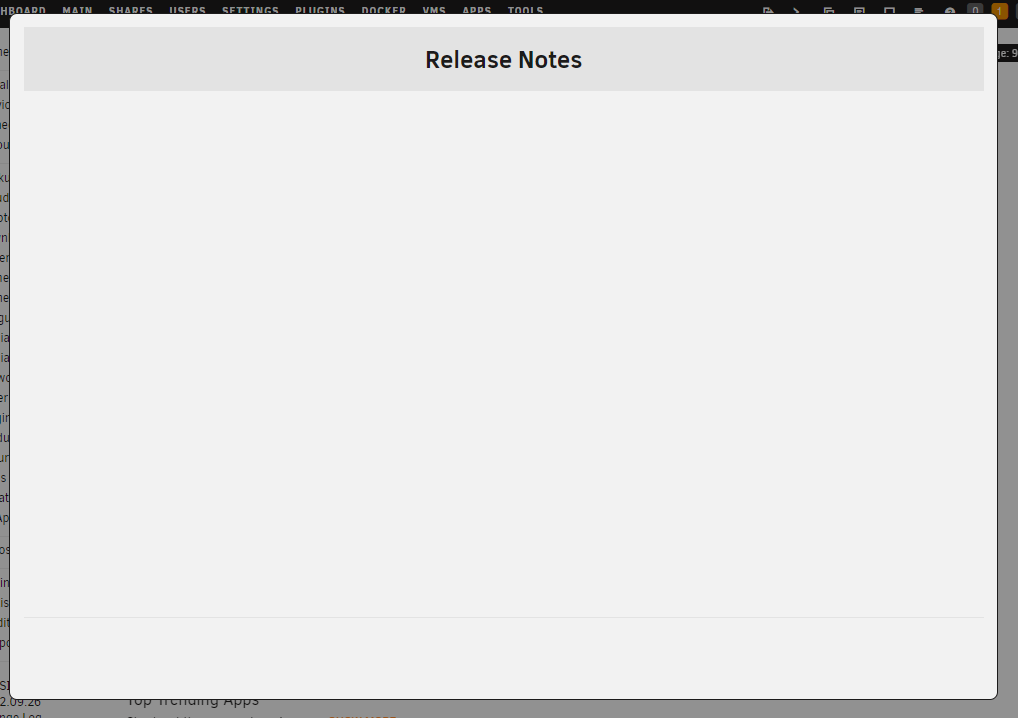

[6.11] Release Notes, Feedback, and System Info all come up blank.

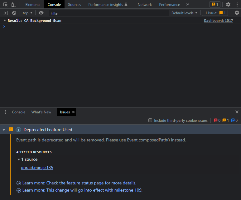

Nothing in the console but this "issue" comes up when I open the windows Okay, I just found something weird. So the box doesn't fill until I load a second browser tab and try to open the same window. At that point the content is filled in the first window.
I can confirm that the issue still happens in safe mode.
This issue started with updating to 6.11, all plugins are updated. Tried uninstalling docker folders plugin and rebooting but that didn't fix it. monolith-diagnostics-20220927-1232.zip
