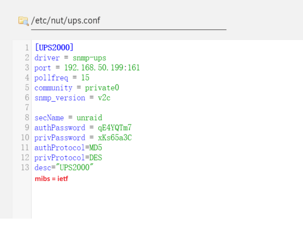

[Plugin] NUT v2 - Network UPS Tools
It should work with your UPS because it uses the RFC standard. Can you try changing the settings as follows: If this doesn't work, please run these commands and post the results: nut-scanner -S -s 192.168.50.198 -e 192.168.50.200 -c public0 nut-scanner -S -s 192.168.50.198 -e 192.168.50.200 -c private0 nut-scanner -S -s 192.168.50.198 -e 192.168.50.200 Last resort, check out this Chinese guide I found for your UPS with SNMP: https://post.smzdm.com/p/adm62dkk/ They got it working with SNMPv3. It should definitely work with SNMPv1/SNMPv2 also, but in the worst case you can try the guide from this post and use SNMPv3 (which is far more complicated, but also more secure). Please let me know what worked for you in the end!
Can you try put the as the UPS Driver Port: 192.168.50.199:161 Then set Start Network UPS Tools Service to No --> Apply --> Yes --> Apply If it doesn't work then please post the relevant SYSLOG lines so I can see what NUT does... 🙂 Also please download the MIB file from that page and post it here, so I can see if it is NUT compatible!
