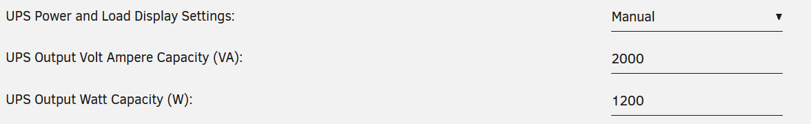

  2. You did not do anything wrong, it's possible your UPS does not send this information for NUT to read. Unfortunately you cannot do anything about that, but you can still use the "Shutdown Mode": "Battery Level" and "Time on Battery", which are the more reliable shutdown modes anyhow. "Runtime Left" is the least reliable shutdown mode and that's the only one that won't work for you because of the missing runtime variable. So basically NUT already has all the information it needs to work reliably and that's good even if some of the variables are missing here. You will see some more information (not the runtime, but at least the power consumed) if you set this setting as follows: Yeah I understood the issue and the two settings you've now added should fix that problem for you. 🙂 Please let me know after the next test if your system has shutdown or if it is working for you as it should now. Yes, this is basically correct information being shown by NUT. The yellow colour is not an alert, it just means that something that is not 100% standard operation is happening for the user to be aware of: ECO mode: When the input voltage is within the set voltage range, the UPS will switch to bypass mode to achieve energy saving. In the event of a power outage, the switching time to battery power is <4ms. I agree that "no battery protection is available" is maybe not 100% correct in your case, but the UPS being on BYPASS is correctly reported by NUT. Usually BYPASS does mean that the UPS circuit is completely bypassed (like in datacenters during UPS battery maintenance) so in such cases there really is no battery protection available while the UPS is on BYPASS. It seems in your case they have a smart switching mechanism and not powering the rectifier and battery circuits is saving that energy and thermal heat to be called ECO mode. I'm also not sure if the UPS is able to condition input power (Volts and Hz) in ECO mode, if that's something that matters to you. By the way, "blazer_usb" is the legacy driver for the newer "nutdrv_qx" driver, you can try setting the UPS Driver to "nutdrv_qx" and see if that will show more or better information (also regarding the BYPASS) - it should work (see this report): https://github.com/networkupstools/nut/issues/1872

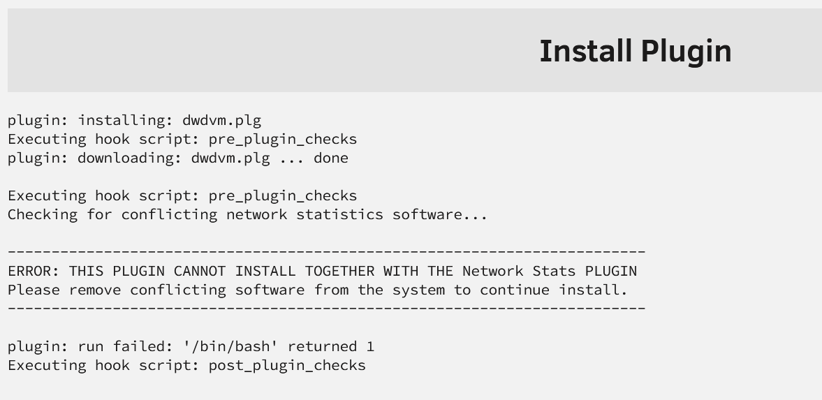

  19. Weird, it should show an error that it's not compatible in the installation window:
