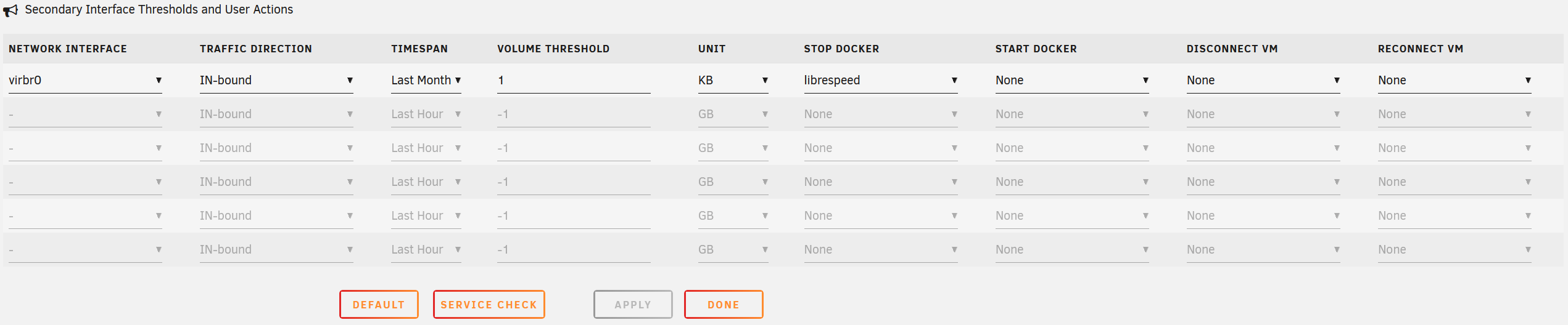

[PLUGIN] Data Volume Monitor (DVM)
I've figured out a way to implement the feature without interacting with the Docker containers and VMs themselves. I've just pushed an update with the new setting (disabled by default), so please let me know if it works for you... 🙂

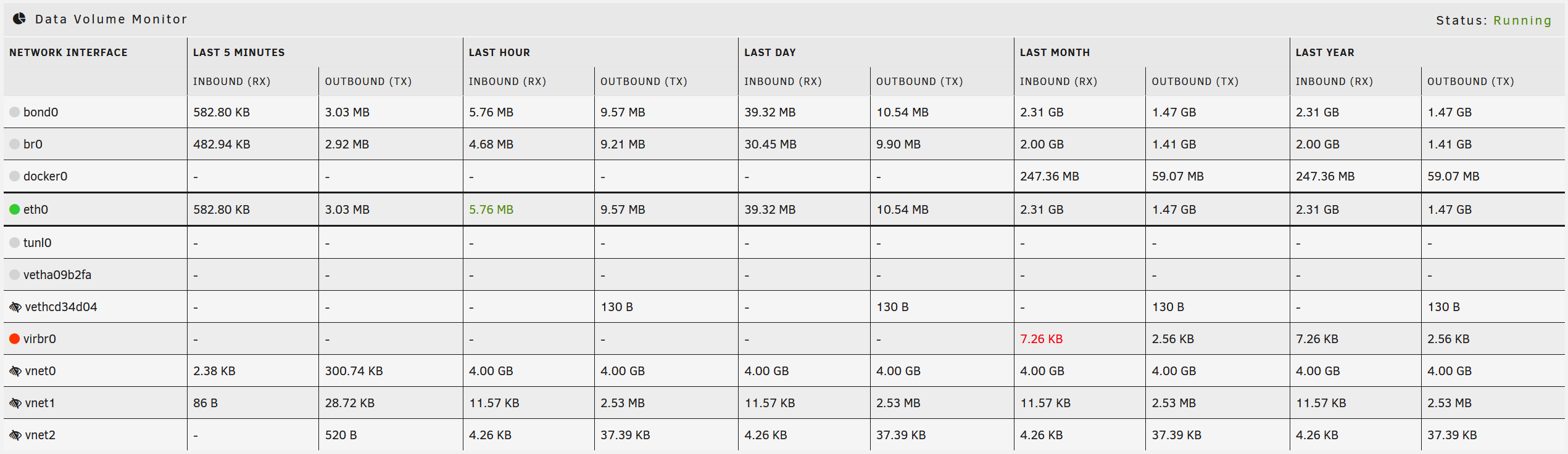

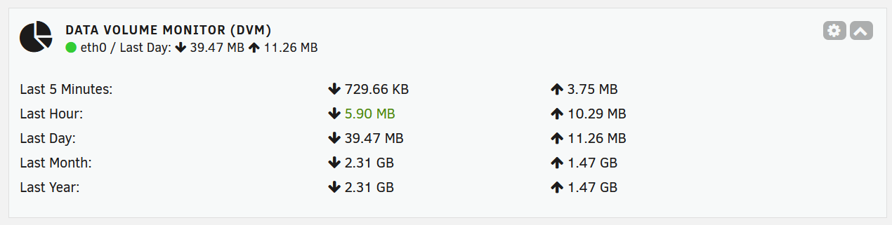

Data Volume Monitor (DVM) for UNRAID "A plugin that lets you monitor and act on your consumed data volume utilizing vnStat." With much pride I'd like to present my latest project - the Data Volume Monitor (DVM). Dashboards, footer information, notifications, user actions (on VMs/Docker containers) and custom scripting. These are a few of the features being offered - all centred around the data volume consumption of your server. Don't want to your Syncthing container to pull in more than 50 GB a day? No problem, DVM will stop and restart the container for you within those limits. Running a few data intensive VMs and want to pull the plug when it's been too much? No problem, DVM will disconnect and reconnect specific VMs from/to the network. Want to move around some files and folders when you've pulled in too much data? No problem, set up a custom script and DVM will execute it for you when it's time. Please report back if you are experiencing any problems! This plugin was developed with older machines in mind - it's been tested on 6.8.3 and above.
