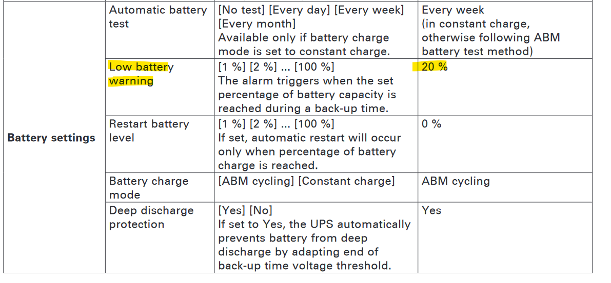

pfSense NUT and NUT in general will by default shutdown when the UPS sends the low battery signal "LOWBATT" (usually happens around 20% charge). The runtime remaining or battery percentage remaining thresholds which trigger the low battery condition are often configurable on the UPS itself. I also happen to have an Eaton 5P and you can configure this on the UPS screen here: So UNRAID also always does this as a last resort (shutting down on a low battery signal), but also has other additional shutdown conditions which act on top of that to ensure that UNRAID has sufficient time to shutdown before any such low battery signal. So setting a reasonable time for the additional shutdown condition (e.g. Time on Battery) on UNRAID while keeping the NUT defaults on the pfSense would ensure that UNRAID shuts down before the pfSense (and any other devices using basic NUT).
