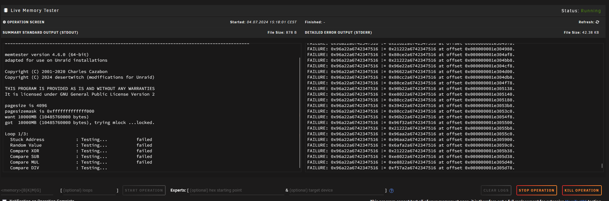

  9. It can't test all of the memory, but it can test a large subset of your memory (e.g. 12GB out of available 16GB). It's very useful for situations where you have no physical access or just want to do a quick preliminary test over a suspicion. As an example, today we suspected RAM problems for a Discord user with OS instabilities and filesystem corruption. Using this plugin, we quickly identified that their RAM had severe problems, becoming apparent within seconds of testing: So it's not a full replacement for an extensive offline memory-test (e.g. using memtest86), but it can be helpful in situations. 🙂
