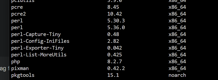

is plugin packages fully compatible with Unraid 6.12.2?
i can see two perl packages in unraid after installing Sanoid :
v5.30.3 from Sanoid.
I'm using it on 6.12.3 right now so yeah it works.
@david279 Yes checked on 6.12.2 , its working .
but maybe some packages can be updated as they very old  for today , like "perl" 5.3.0.3 that replace the new one 5.36.0?
