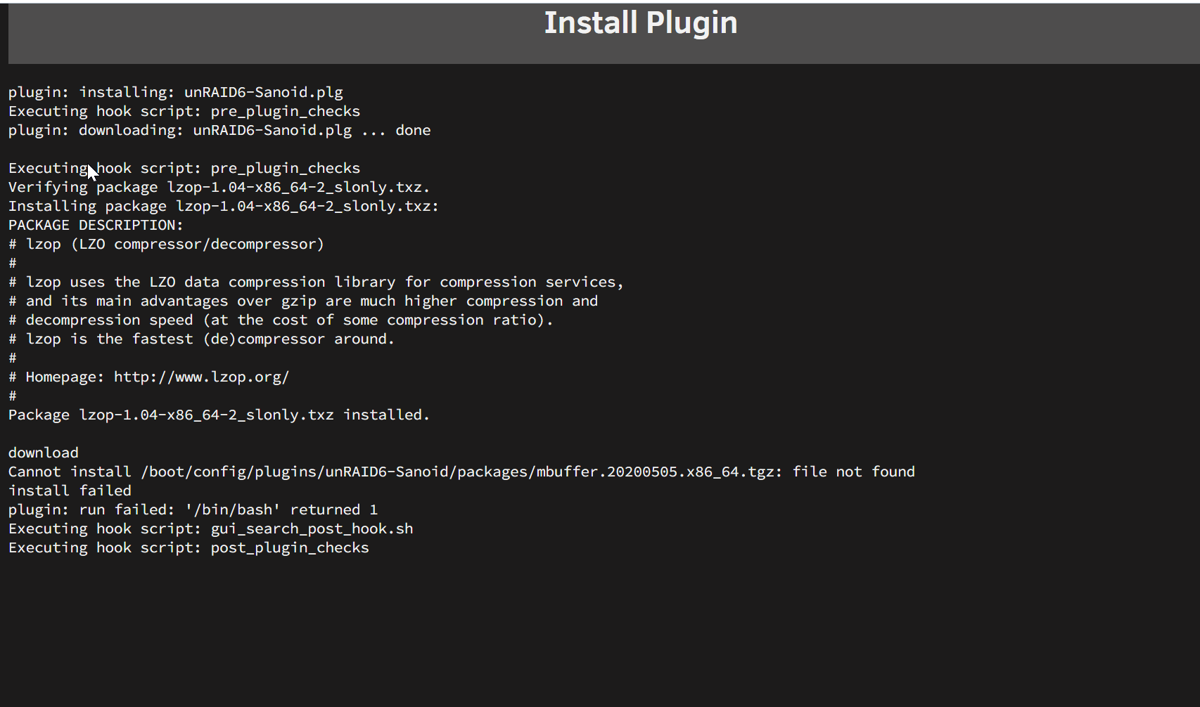

  • The problem is that the version of mbuffer installed by the plugin is not compatible with the new OS version (7.x). This becomes even worse because the OS provides its own mbuffer package, which will
  • foo_fighter
    foo_fighter
    @steini84: Looks like mbuffer needs to be updated for UnRaid V7:   root@NAS:/boot/config/plugins# find . -name '*mbuffer*' ./unRAID6-Sanoid/packages/mbuffer-20240107-x86_64-1_SBo.tgz
  • Hey.   I have created a pull request that does not install mbuffer and perl 5.34 (perl 5.38.2 is preinstalled on unraid 7) with the sanoid plugin on unraid 7. I don't have unraid 7 available
I can not help but i get exactly the same error when trying to install it from Apps.
Same here seem the issue is in the plugin config if referencing a file that doesn't exist. I opened a ticket in Github.
Forgot to update the reference to the new mbuffer package so the install failed on new installs (updates were fine). Fixed now

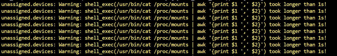

@steini84 i posted to UNASSIGNED DEVICES topic  ,and author said :
The reason this showed up is that you had a PC with the UD GUI open and apparently your server was working very hard.  The command that timed out is UD trying to read the mounts file to determine mounted status of the UD devices.  Reading that file should not take longer than 1 second.  I will increase the time out a bit to try to keep this from happening, but it is harmless other than to show UD could potentially be hanging.  UD will catch up on the mounted status at the next background scan.
Maybe ask the plugin author if they can adjust the priority.

On 10/23/2023 at 3:25 PM, steini84 said:
There seems to be a problem with the mbuffer package. You can install the older version, but all the Slackware packages i found for the latest version are the same.
To install the older package you can use
wget https://github.com/Steini1984/unRAID6-Sainoid/raw/167f5ad3dc1941ef7670efcd21fbb4e6e6ad8587/packages/mbuffer.20200505.x86_64.tgz
installpkg mbuffer.20200505.x86_64.tgz
I stumbled over the problem with the broken mbuffer package. The package fetched by the plugin cointains only the sources of mbuffer and I was not able to find a current version packaged for Slackware. But there is a build script available: https://slackbuilds.org/repository/15.0/system/mbuffer/
I built the latest version of mbuffer (20240107) and packaged it with the linked SlackBuild for Slackware. I think it would be great, if mbuffer package in the plugin would be updated to have a working version available out of the box.
The packaged version of mbuffer is in the attachment. But if you like, I can also create a pull request on GitHub with the updates for the plugin.
Edited by SoerenS
typos
Thanks for this, worked fine on my main system and backup to remove the mbuffer error.
Please if you can
@steini84 can be this version (updated) used in plugin ?
Edited by Masterwishx
I made the pr with your file, just not shure if needs to be recompiled for usr/local instead of /usr, waiting for @steini84 responds
Perfect thanks, this has been merged :)
