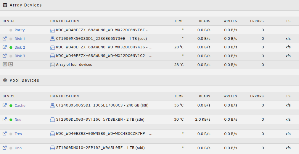

Currently I have xfs in the pool. The objective is disable parity, and add this disk as data, all disks as data indeed, except the appdata/docker SSD. nuvol-diagnostics-20260506-1755.zip

Wow, I don't know how I have multiple mixed SSD and HDD in one pool. I was very wrong. I have all my disks as xfs, by the way. So, I will go to a new config, with as pools as disks I have. You're great, Jorge, thank you.

I have both, HDD and SSD, in the array and in the pool... I only want a "simple" data storages, in different shares... And one of the SSD for docker. So, from the point of performance and simplicity, all in one pool, HDD and SSD? Thank you.

Hi all! I currently have an array with a parity disk, and a pool with an SSD for docker and several hard drives. The shares are on a single disk; the data isn't spread across disks. I want to remove the parity disk, without losing any data, of course. In my new setup, I want to use each disk independently for my shares; I don't want parity or RAID. What's best? Just have one pool with all the disks? Just have the array with all the disks without parity? Have several pools (and no array), each with a single disk? (I don't think this last one is ideal, since I think data can't be moved from one pool to another) I don't want lose any data changing to the new config. Thank you so much.

I currently have three disks in the array with one parity disk. And three disks in the pool. I would like to use the parity disk as another data disk and move the three disks from the pole to the array, since it will work the same without a parity disk. What would be the best process to do this? Thank you.
