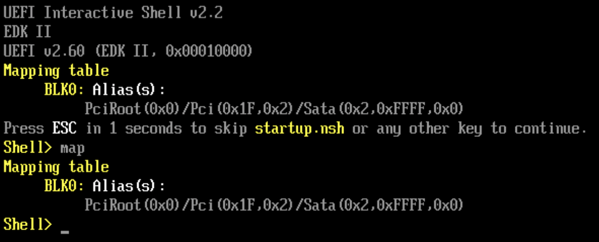

Booting into shell after moving HAOS image on Unraid VM
makin replied to makin's topic in VM Engine (KVM)
You sir are a true hero! Thank you very much! -
Thanks for answering! This is the xml form for my VM: <?xml version='1.0' encoding='UTF-8'?> <domain type='kvm'> <name>HA OS</name> <uuid>0d290cc6-10fe-a591-adf8-4e49d5769d5d</uuid> <description>Home Assistant OS on Linux</description> <metadata> <vmtemplate xmlns="unraid" name="Linux" icon="linux.png" os="linux"/> </metadata> <memory unit='KiB'>4194304</memory> <currentMemory unit='KiB'>2097152</currentMemory> <memoryBacking> <nosharepages/> </memoryBacking> <vcpu placement='static'>3</vcpu> <cputune> <vcpupin vcpu='0' cpuset='0'/> <vcpupin vcpu='1' cpuset='1'/> <vcpupin vcpu='2' cpuset='2'/> </cputune> <os> <type arch='x86_64' machine='pc-q35-4.2'>hvm</type> <loader readonly='yes' type='pflash'>/usr/share/qemu/ovmf-x64/OVMF_CODE-pure-efi.fd</loader> <nvram>/etc/libvirt/qemu/nvram/0d290cc6-10fe-a591-adf8-4e49d5769d5d_VARS-pure-efi.fd</nvram> </os> <features> <acpi/> <apic/> </features> <cpu mode='host-passthrough' check='none' migratable='on'> <topology sockets='1' dies='1' cores='3' threads='1'/> <cache mode='passthrough'/> <feature policy='require' name='topoext'/> </cpu> <clock offset='utc'> <timer name='rtc' tickpolicy='catchup'/> <timer name='pit' tickpolicy='delay'/> <timer name='hpet' present='no'/> </clock> <on_poweroff>destroy</on_poweroff> <on_reboot>restart</on_reboot> <on_crash>restart</on_crash> <devices> <emulator>/usr/local/sbin/qemu</emulator> <disk type='file' device='disk'> <driver name='qemu' type='raw' cache='writeback'/> <source file='/mnt/cache/domains/HA OS/haos_ova-6.1.qcow2'/> <target dev='hdc' bus='sata'/> <boot order='1'/> <address type='drive' controller='0' bus='0' target='0' unit='2'/> </disk> <controller type='usb' index='0' model='ich9-ehci1'> <address type='pci' domain='0x0000' bus='0x00' slot='0x07' function='0x7'/> </controller> <controller type='usb' index='0' model='ich9-uhci1'> <master startport='0'/> <address type='pci' domain='0x0000' bus='0x00' slot='0x07' function='0x0' multifunction='on'/> </controller> <controller type='usb' index='0' model='ich9-uhci2'> <master startport='2'/> <address type='pci' domain='0x0000' bus='0x00' slot='0x07' function='0x1'/> </controller> <controller type='usb' index='0' model='ich9-uhci3'> <master startport='4'/> <address type='pci' domain='0x0000' bus='0x00' slot='0x07' function='0x2'/> </controller> <controller type='pci' index='0' model='pcie-root'/> <controller type='pci' index='1' model='pcie-root-port'> <model name='pcie-root-port'/> <target chassis='1' port='0x10'/> <address type='pci' domain='0x0000' bus='0x00' slot='0x02' function='0x0' multifunction='on'/> </controller> <controller type='pci' index='2' model='pcie-root-port'> <model name='pcie-root-port'/> <target chassis='2' port='0x11'/> <address type='pci' domain='0x0000' bus='0x00' slot='0x02' function='0x1'/> </controller> <controller type='pci' index='3' model='pcie-root-port'> <model name='pcie-root-port'/> <target chassis='3' port='0x12'/> <address type='pci' domain='0x0000' bus='0x00' slot='0x02' function='0x2'/> </controller> <controller type='pci' index='4' model='pcie-root-port'> <model name='pcie-root-port'/> <target chassis='4' port='0x13'/> <address type='pci' domain='0x0000' bus='0x00' slot='0x02' function='0x3'/> </controller> <controller type='virtio-serial' index='0'> <address type='pci' domain='0x0000' bus='0x02' slot='0x00' function='0x0'/> </controller> <controller type='sata' index='0'> <address type='pci' domain='0x0000' bus='0x00' slot='0x1f' function='0x2'/> </controller> <interface type='bridge'> <mac address='52:54:00:c4:eb:8b'/> <source bridge='br0'/> <model type='virtio'/> <address type='pci' domain='0x0000' bus='0x01' slot='0x00' function='0x0'/> </interface> <serial type='pty'> <target type='isa-serial' port='0'> <model name='isa-serial'/> </target> </serial> <console type='pty'> <target type='serial' port='0'/> </console> <channel type='unix'> <target type='virtio' name='org.qemu.guest_agent.0'/> <address type='virtio-serial' controller='0' bus='0' port='1'/> </channel> <input type='tablet' bus='usb'> <address type='usb' bus='0' port='2'/> </input> <input type='mouse' bus='ps2'/> <input type='keyboard' bus='ps2'/> <graphics type='vnc' port='-1' autoport='yes' websocket='-1' listen='0.0.0.0' keymap='de'> <listen type='address' address='0.0.0.0'/> </graphics> <video> <model type='qxl' ram='65536' vram='65536' vgamem='16384' heads='1' primary='yes'/> <address type='pci' domain='0x0000' bus='0x00' slot='0x01' function='0x0'/> </video> <hostdev mode='subsystem' type='usb' managed='no'> <source> <vendor id='0x0658'/> <product id='0x0200'/> </source> <address type='usb' bus='0' port='1'/> </hostdev> <memballoon model='virtio'> <address type='pci' domain='0x0000' bus='0x03' slot='0x00' function='0x0'/> </memballoon> </devices> </domain> -
Hi everyone, I am facing an issue after moving my HA image from a parity disk to my cache disk on Unraid. This worked quite easy and was done in order to not having the parity check negatively affecting the performance of HA. fs0: brings 'fs0:' is not a valid mapping. I then performed the following (read in the Unraid forums): modprobe nbd max_part=8 qemu-nbd --connect=/dev/nbd0 /path/to/the/image/ha.qcow2 mkdir /path/to/the/mount/point/ fdisk /dev/nbd0 -l mount /dev/nbd0p1 /path/to/the/mount/point/ and the output is: Disk /dev/nbd0: 32 GiB, 34359738368 bytes, 67108864 sectors Units: sectors of 1 * 512 = 512 bytes Sector size (logical/physical): 512 bytes / 512 bytes I/O size (minimum/optimal): 512 bytes / 512 bytes Disklabel type: gpt Disk identifier: A4E33CCF-98F3-43B5-B08D-6F37CFF42D17 Device Start End Sectors Size Type /dev/nbd0p1 2048 67583 65536 32M EFI System /dev/nbd0p2 67584 116735 49152 24M Linux filesystem /dev/nbd0p3 116736 641023 524288 256M Linux filesystem /dev/nbd0p4 641024 690175 49152 24M Linux filesystem /dev/nbd0p5 690176 1214463 524288 256M Linux filesystem /dev/nbd0p6 1214464 1230847 16384 8M Linux filesystem /dev/nbd0p7 1230848 1427455 196608 96M Linux filesystem /dev/nbd0p8 1427456 67108830 65681375 31.3G Linux filesystem So it appears to not be broken. After checking that, I unmounted and disconnected using: umount /path/to/the/mount/point/ qemu-nbd --disconnect /dev/nbd0 rmmod nbd What I did for the sake of a backup is to mount the biggest partition and download the supervisor folder which holds configs and backups... Do you guys have any idea what to try to get the VM back on running? Especially ZWave is what took soooo much time. 😦 Thanks a lot in advance guys!

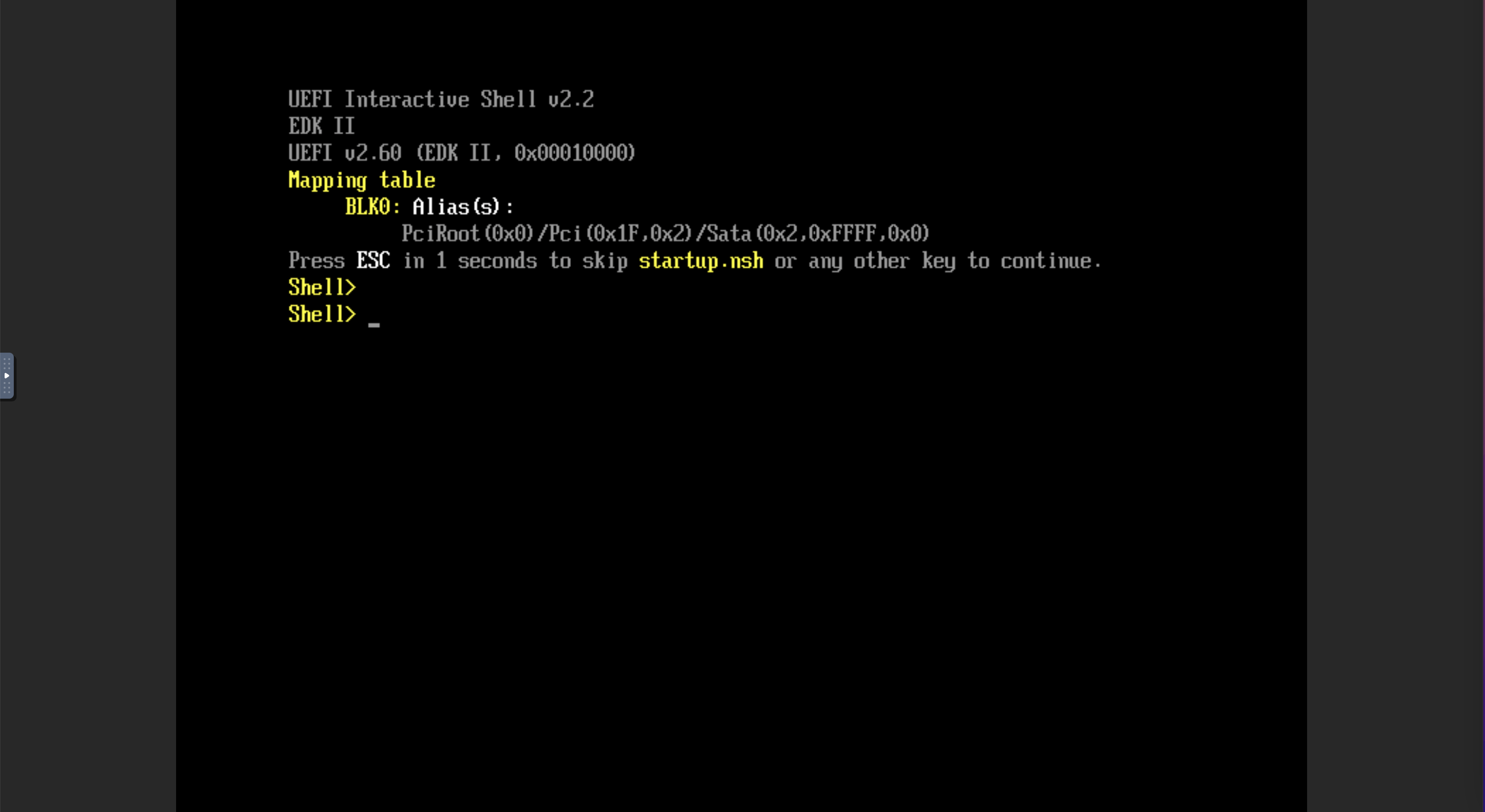

Hey guys, after moving the HA VM from disk1 to cache, I encounter the same issue but the partitions seem to still be intact. Disk /dev/nbd0: 32 GiB, 34359738368 bytes, 67108864 sectors Units: sectors of 1 * 512 = 512 bytes Sector size (logical/physical): 512 bytes / 512 bytes I/O size (minimum/optimal): 512 bytes / 512 bytes Disklabel type: gpt Disk identifier: A4E33CCF-98F3-43B5-B08D-6F37CFF42D17 Device Start End Sectors Size Type /dev/nbd0p1 2048 67583 65536 32M EFI System /dev/nbd0p2 67584 116735 49152 24M Linux filesystem /dev/nbd0p3 116736 641023 524288 256M Linux filesystem /dev/nbd0p4 641024 690175 49152 24M Linux filesystem /dev/nbd0p5 690176 1214463 524288 256M Linux filesystem /dev/nbd0p6 1214464 1230847 16384 8M Linux filesystem /dev/nbd0p7 1230848 1427455 196608 96M Linux filesystem /dev/nbd0p8 1427456 67108830 65681375 31.3G Linux filesystem Any idea how to save my VM? I do not have a backup...
