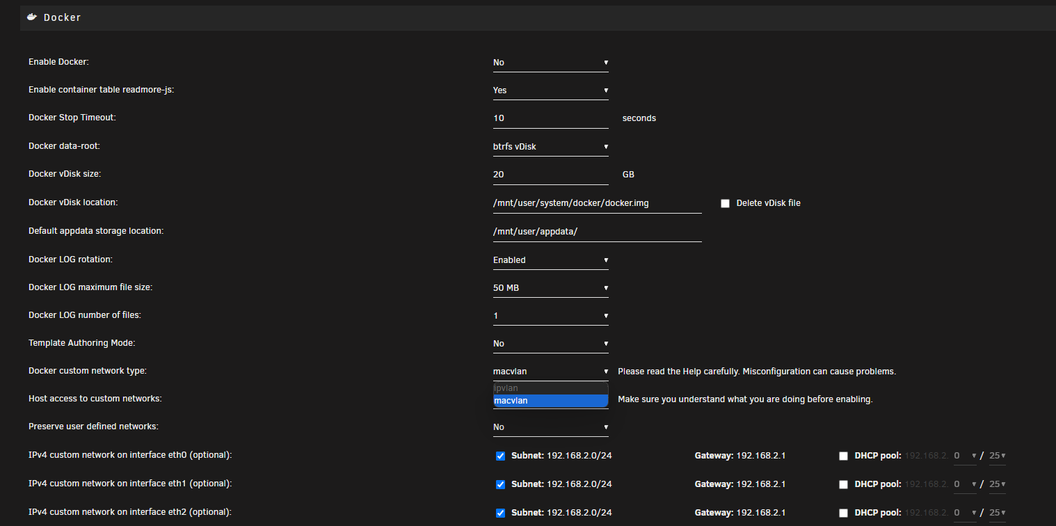

  7. Thx for the excellent work Unraid Team. Now I know what my freezes caused Macvlan and ubiquiti switches. I tried the suggestion in the release notes but the option i greyed out on my system. I have three NIC in my system. 2 onboard and one 10GB Nic Card. Onboard should be as bond0 at a 802.3ad ubiquiti switch.

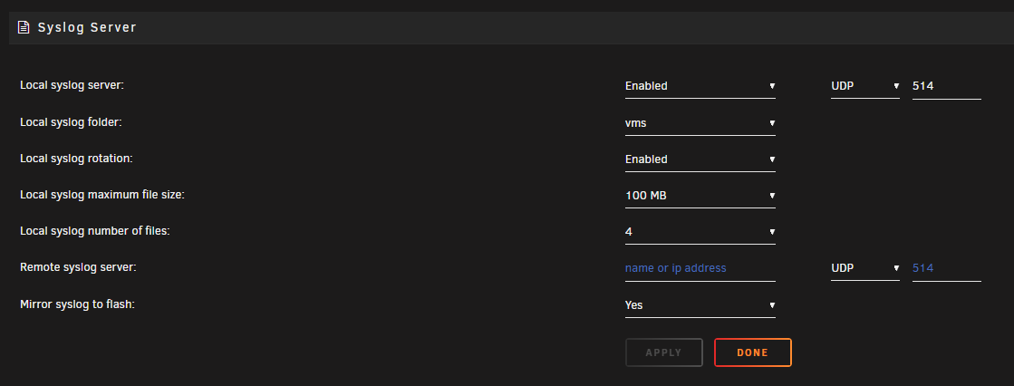

  9. Okay my mistake thanks I missed that in the documentation. So I just enter there localhost ip "127.0.0.1" right? Now I see a syslog-127.0.0.1.log onto the share generated.
  10. Update: Server freezed again but I can't see any logs generated onto the location of "vms". This share is a cache only one. I did it again with now mirror tto flash as additional logging destination:
