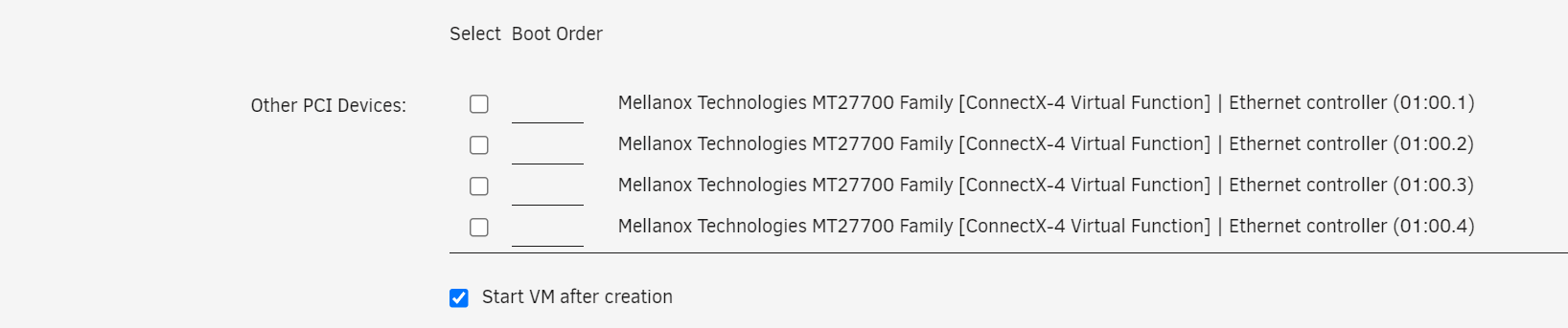

  4. 1) Mainboard Bios, enable sriov there 2) install the sriov plugin 3) make a user script with (echo 4 means 4 Virtual GPUs) #!/bin/bash echo 4 > /sys/devices/pci0000\:00/0000\:00\:02.0/sriov_numvfs 4)make it run on array start 5) set 4 VFs in the Plugin 6)reboot 7) bind as many as you wish in the system devices Tab 8)reboot

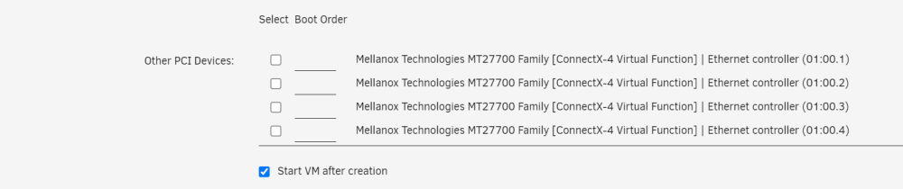

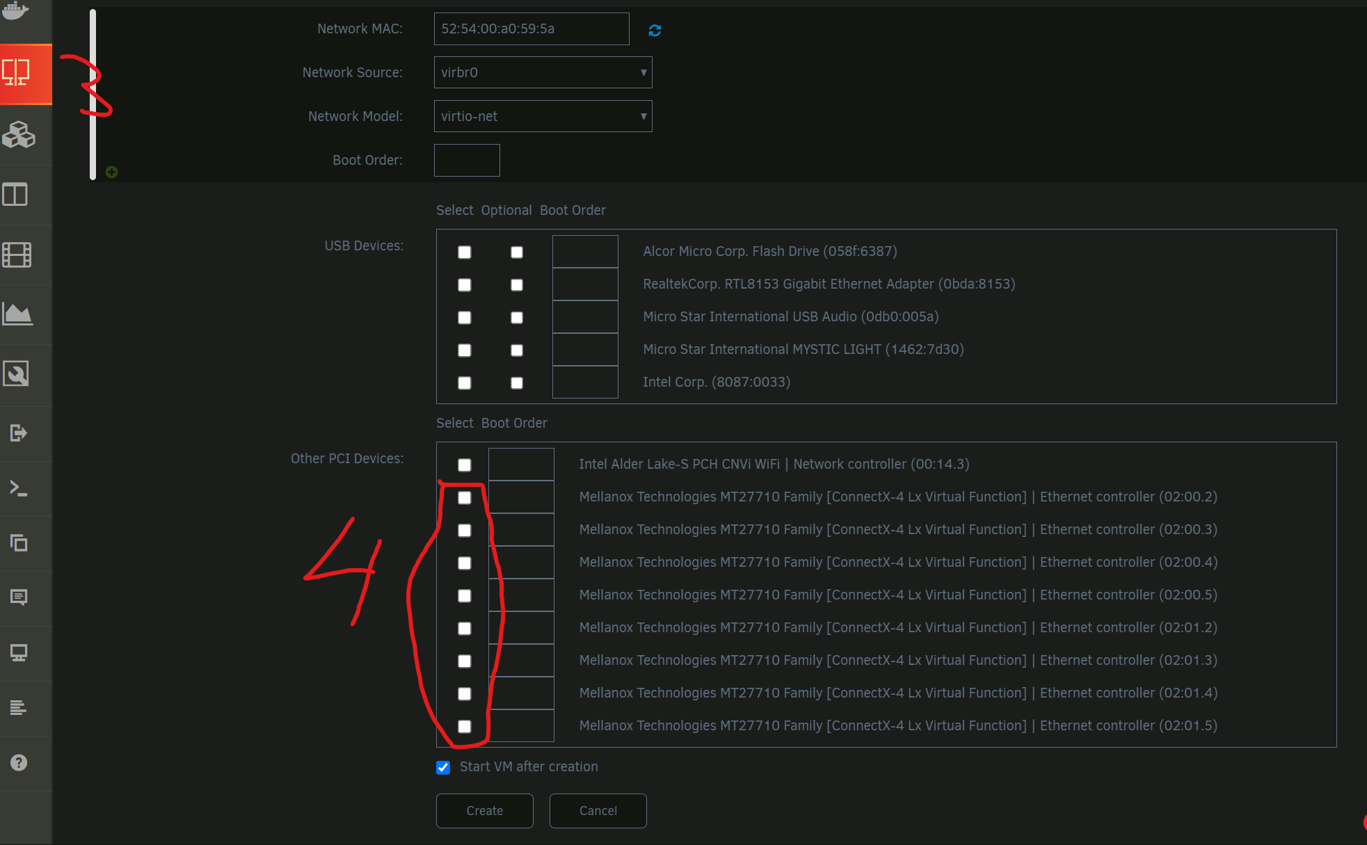

  5. No you need to tick how much you want to use in VM‘s Tick the Box and reboot as usual then create a VM and check those box or boxes if you need more than one in your VM

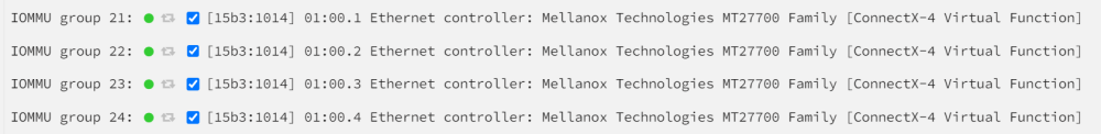

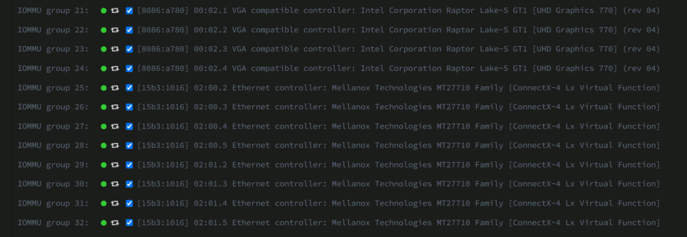

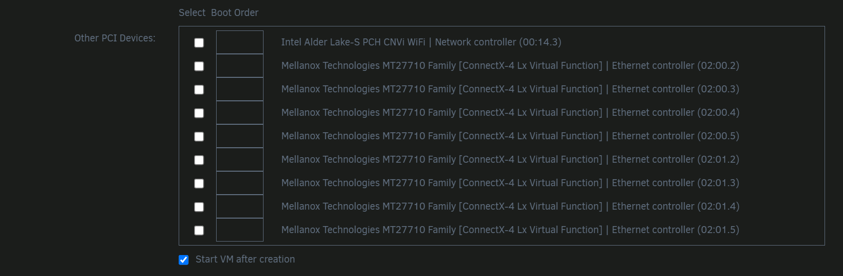

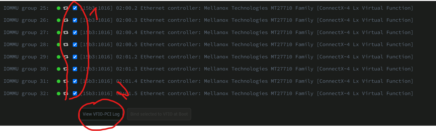

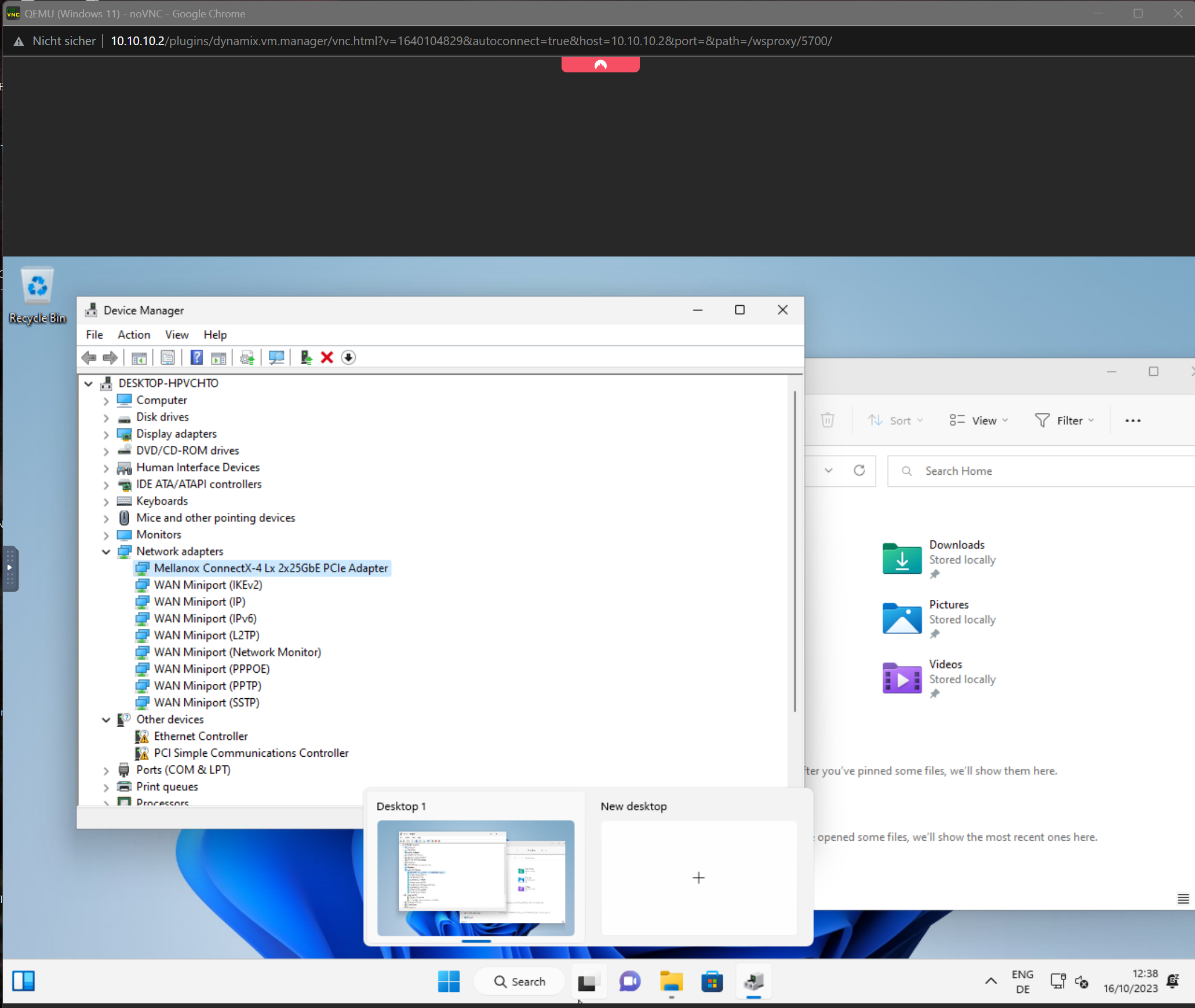

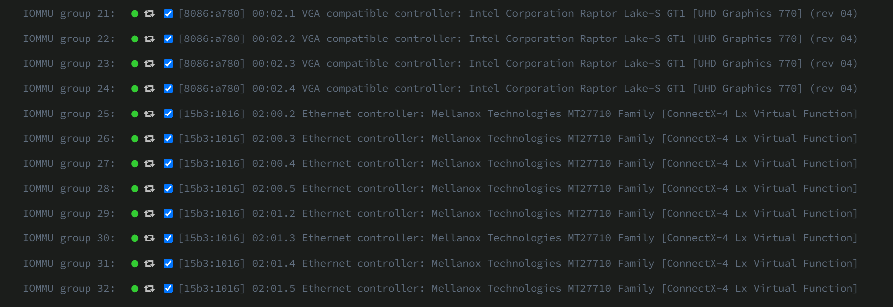

  10. Ok first things first, i get the gist of what the code does maybe an educated gues but i made it work with you guys/gals help. 😅 All this on 6.12.4 So i have an 25gbe dual nic its Mellanox Technologies MT27710 Family [ConnectX-4 Lx] I did 1) Use this command in the Terminal: wget 'https://raw.githubusercontent.com/andre-richter/vfio-pci-bind/master/vfio-pci-bind.sh'; mv vfio-pci-bind.sh /boot/config/ 2) Use this comman in the Terminal echo 4 > /sys/class/net/eth0/device/sriov_numvfs echo 4 > /sys/class/net/eth2/device/sriov_numvfs eth0 and eth2 are my 2 NIC's with this comman i get the Ids from the VFs in the Tools ---> System Devices like so, 15b3:1016 0000:02:01.2 15b3:1016 0000:02:01.3 15b3:1016 0000:02:01.4 15b3:1016 0000:02:01.5 15b3:1016 0000:02:00.2 15b3:1016 0000:02:00.3 15b3:1016 0000:02:00.4 15b3:1016 0000:02:00.5 3) made a user script make it run on start of the array, echo 4 > /sys/class/net/eth0/device/sriov_numvfs echo 4 > /sys/class/net/eth2/device/sriov_numvfs sudo bash /boot/config/vfio-pci-bind.sh 15b3:1016 0000:02:01.2 sudo bash /boot/config/vfio-pci-bind.sh 15b3:1016 0000:02:01.3 sudo bash /boot/config/vfio-pci-bind.sh 15b3:1016 0000:02:01.4 sudo bash /boot/config/vfio-pci-bind.sh 15b3:1016 0000:02:01.5 sudo bash /boot/config/vfio-pci-bind.sh 15b3:1016 0000:02:00.2 sudo bash /boot/config/vfio-pci-bind.sh 15b3:1016 0000:02:00.3 sudo bash /boot/config/vfio-pci-bind.sh 15b3:1016 0000:02:00.4 sudo bash /boot/config/vfio-pci-bind.sh 15b3:1016 0000:02:00.5 /usr/local/sbin/vfio-pci >>/var/log/vfio-pci 4) its done next step on my second Unraid server i have an 100GbE Mellanox x4 and its SRIOV capable but it seems to be deactivated lets see how i activate it via Unraid, i think there are some hints in this thread. *edit* *done* install the Mellanox Plugin open a Terminal and use this command You need to use your NIC ID and you can use any VFs amount your Card allows. mstconfig -d 01:00.0 set SRIOV_EN=1 NUM_OF_VFS=4 now my 100GbE NIC is SRIOV activated then rinse and repeat the steps above 1)- 4) i spun up a VM and voila the NIC is already installed the other not installed is the virtual one from Unraid 😁

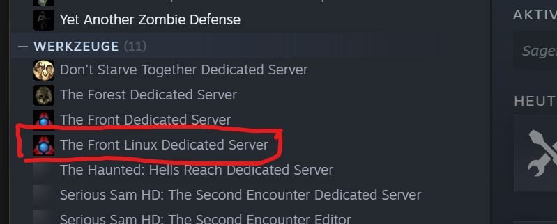

  13. Can "the Front" be dockerized? its new and has an linux dedicatetd server on steam?

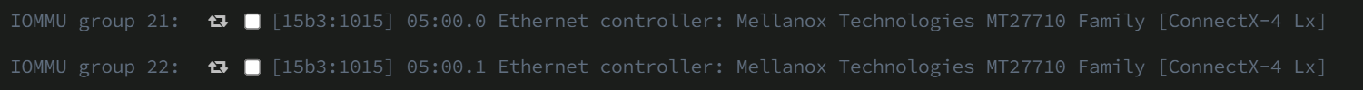

  20. my NIC has the same ATTRS{vendor}=="0x15b3", ATTRS{device}=="0x1015" so this code needs to be in the go file? # create and reload udev-rules cat << UDEVRULES >> /etc/udev/rules.d/99-sriov.rules ACTION=="add", SUBSYSTEM=="net", ATTRS{vendor}=="0x15b3", ATTRS{device}=="0x1015", ATTR{device/sriov_drivers_autoprobe}="0", ATTR{device/sriov_numvfs}="4" UDEVRULES udevadm control --reload udevadm trigger --action=add i just need 4 VFs ?
  21. ok i want to try this, what i have Mellanox CX4121A IBM 01GR253 Dual-Port SFP28 SRIOV capable Board i7 13700k SRIOV with IGPU works i tried all Methods none is working afaik i want 4 VFs per Controller i tried to imitade the how to 2 post above mine from @riduxd but with no effect i have no VFs shown so none to bind after the first edit of the go file this are my NICs i would add this to my go file #!/bin/bash # Start the Management Utility /usr/local/sbin/emhttp & echo 12.884.901.888 >> #p8 state nvidia nvidia-persistenced # ------------------------------------------------- # disable haveged as we trust /dev/random # https://forums.unraid.net/topic/79616-haveged-daemon/?tab=comments#comment-903452 # ------------------------------------------------- /etc/rc.d/rc.haveged stop echo 4 > /sys/devices/pci0000\:00/0000\:00\:02.0/sriov_numvfs && /usr/local/sbin/vfio-pci modprobe i915 && sleep 5 echo 2 > /sys/devices/pci0000:00/0000:00:02.0/sriov_numvfs && /usr/local/sbin/vfio-pci echo 2 > /sys/devices/pci0000:00/0000:00:02.0/sriov_numvfs sed -i "s/\(strSpecialAddress.*\)\$gpu_function/\1\"0\"/" /usr/local/emhttp/plugins/dynamix.vm.manager/include/libvirt.php #VF Mellanox echo 4 > /sys/bus/pci/devices/0000:05:00.0/sriov_numvfs echo 4 > /sys/bus/pci/devices/0000:05:00.1/sriov_numvfs # Relaunch vfio-pci script to bind virtual function adapters that didn't exist at boot time /usr/local/sbin/vfio-pci >>/var/log/vfio-pci right?
