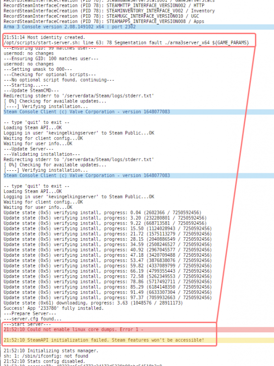

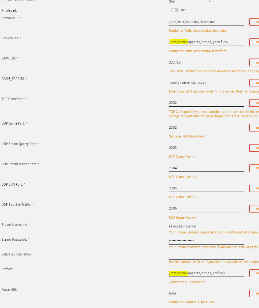

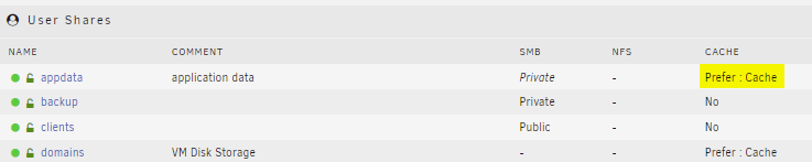

  16. Heya Ich777 and others in this thread~ I've been using quite a lot of game server dockers from you and they normally work flawlessly One that doesn't is the Arma3 ones and I'm getting the same 'Segmentation fault' and 'Could not enable linux core dumps. Error 1' that others have reported many pages back. I read a few of the posts I could actually find and concluded the following potential fixes: - verifying files - clean install - ensure mounts don't point at the fusion storage - try FORCE_X86 - use valid steam account - purchase something worth 5$ with the account (or does the account need to have that item in its library? I have 5โ‚ฌ (>5$) in my steam wallet and purchased a gift for my main account) I think the account should be fine, since I used it to run a windows server for arma previously. These are the logs I'm getting on a pretty clean install. These are the container settings. Note I have both ServerFiles and Profiles set to /cache/ These are my share settings (appdata has been set to 'prefer' cache for ages) Is there anything else I can still try? I don't mind log messages if they're harmless; but that error causes the server to seemingly randomly restart while playing. Thanks a lot in advance for anyone who can chime in with some suggestions. And thanks a ton to ich777 for creating all those dockers.
