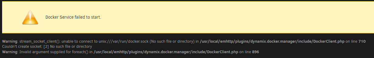

Thanks, recreating the image helped. I have not figured it unfortunately, the only big change I've made is updating the OS. Is there any good guide for frp, image --> folder? Thanks in advance! I run memtest and got zero errors this time...but I did this after I solved the issue above with @Squid's help and a restart.
Docker Service fails to start after upgrading from 6.10.2 to 6.10.3.
I backed up the flash drive before updating from 6.10.2 to 6.10.3. After updating Docker Services refuse to start, please see warning texts below. How can those warnings be fixed? I've attached diagnostics as well. tower-diagnostics-20220617-1305.zip
