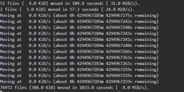

Mover "starts", but does not move any data and never "stops" after upgrading to 7
What setting did you have to change? I'm facing the same problem.
