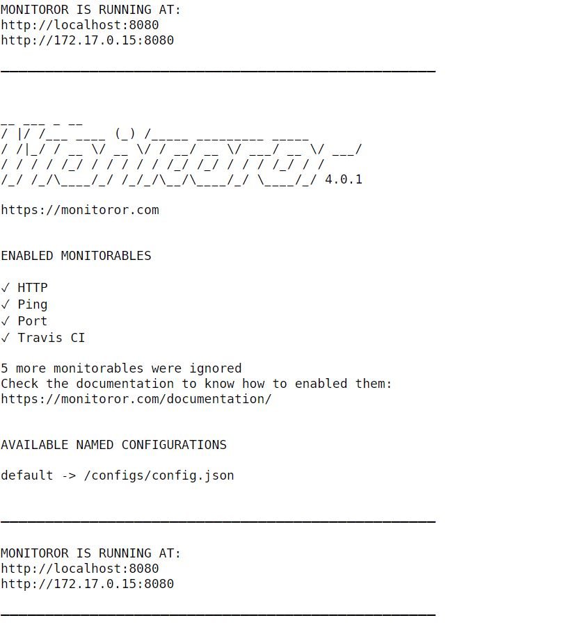

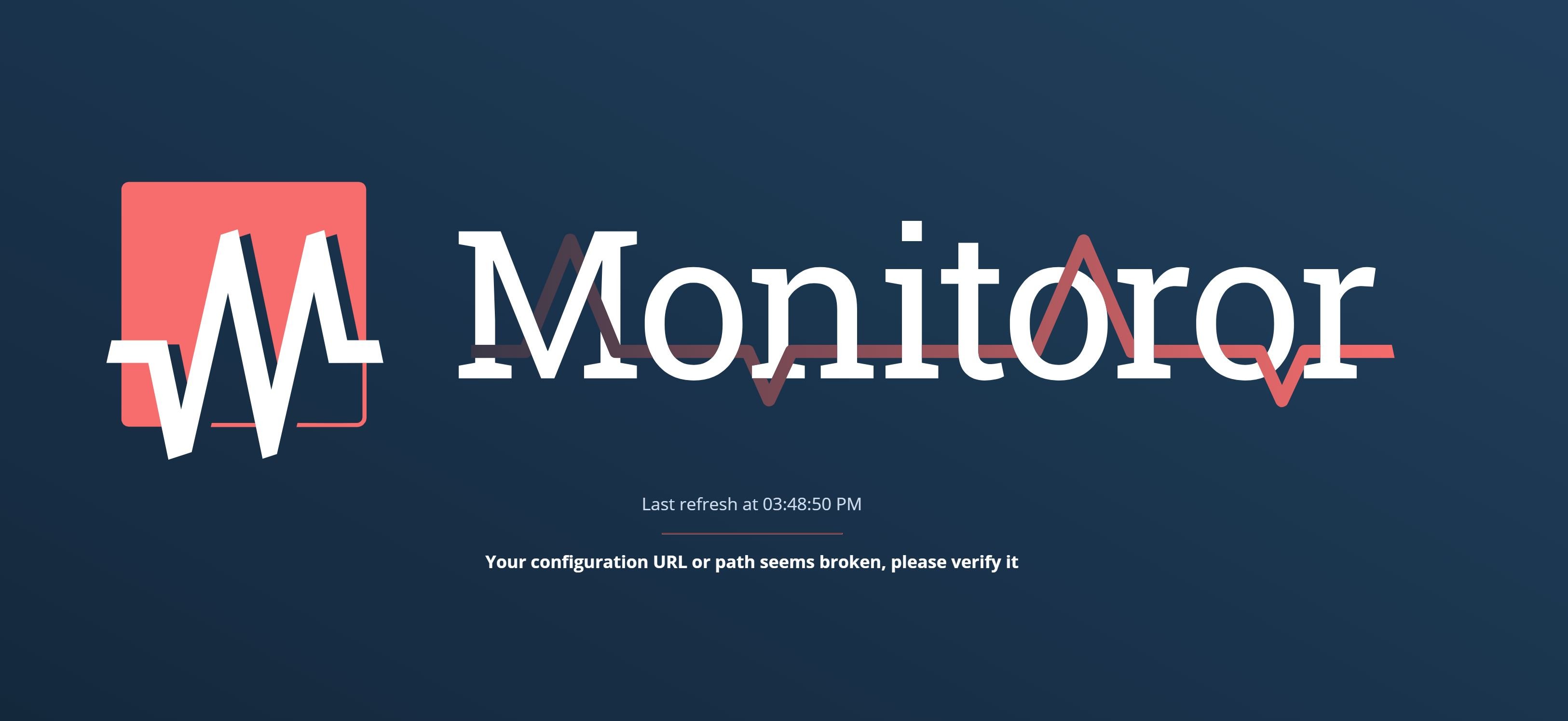

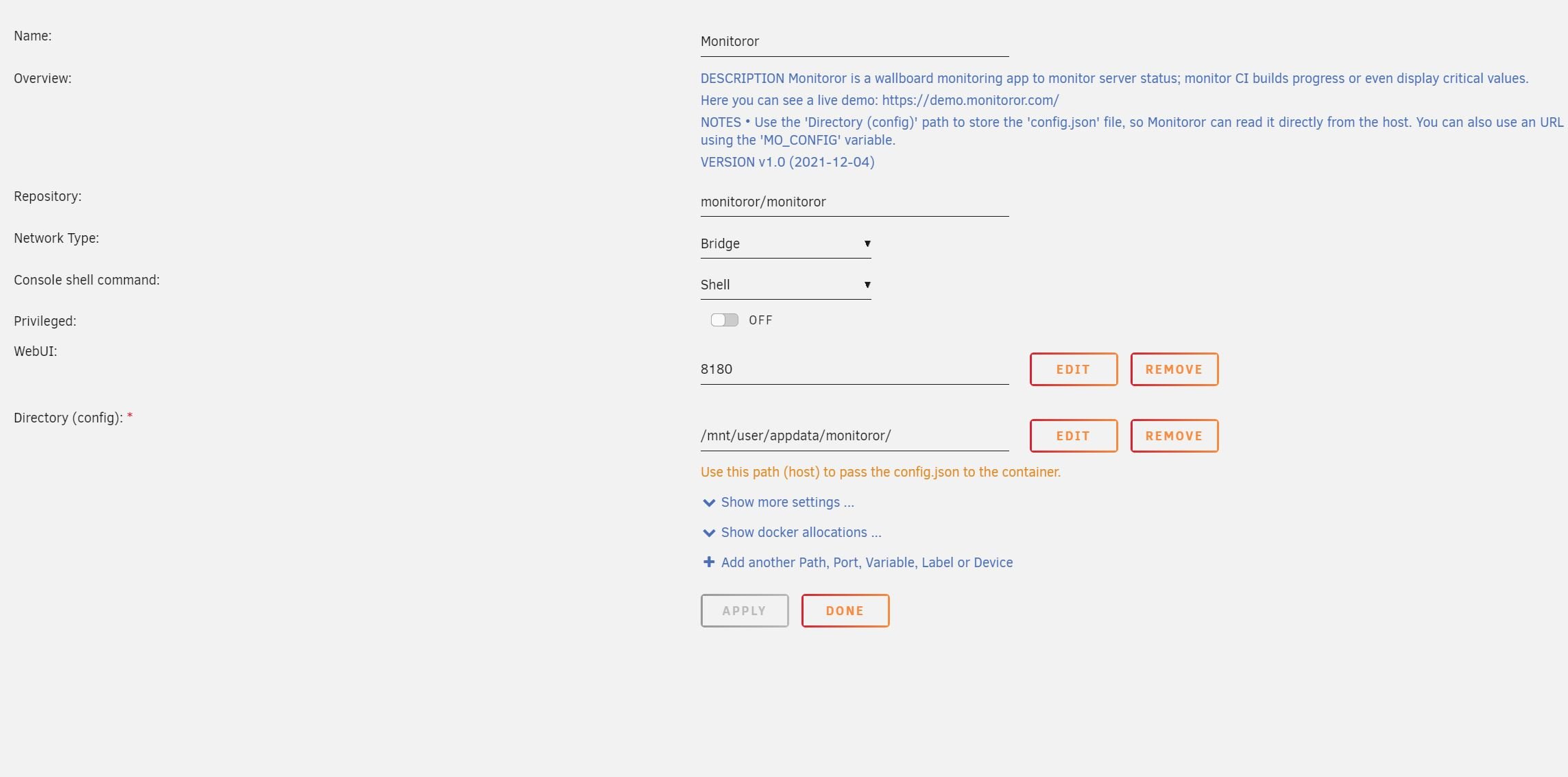

  14. when i change the webui port from 8080 to 8180.the docker is still working on 8080 port Your configuration URL or path seems broken, please verify it
