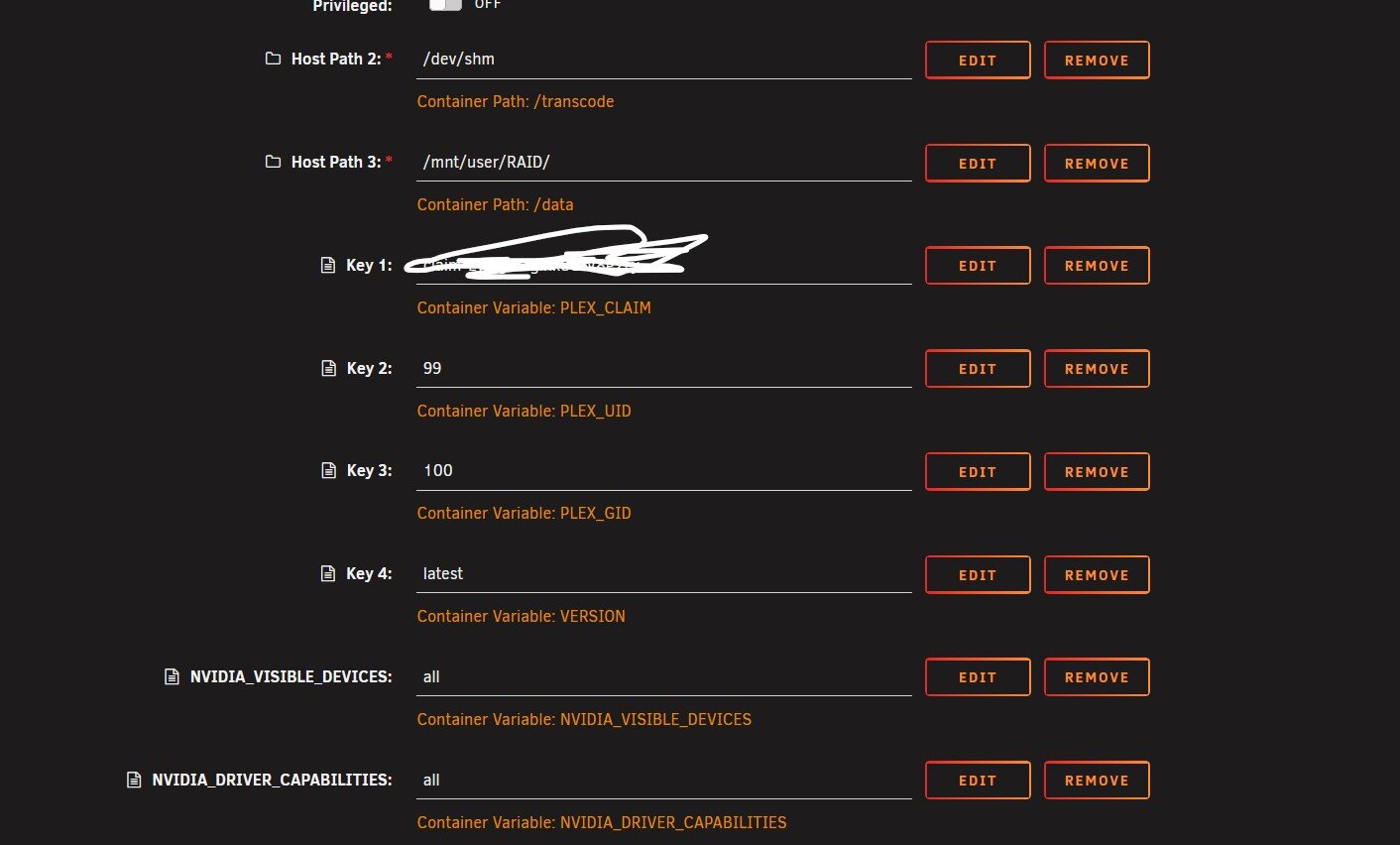

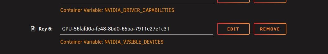

  6. I swear I'm not on drugs. Doesn't help. Switch anything to transcode and the CPU goes nuts. I've tried an Android device, a Windows Plex app (not the web app), and various media sources. Most stuff direct plays of course, but when I force it to 720p (for example)
  7. Yes, it's started with the --runtime=nvidia I guess 7.3b2 somehow broke hardware transcoding. FWIW, I opened a bug report. @anthony0030 you in particular might want to check/comment as you can roll back to b1, and I can't as I moved from 7.2.4 https://product.unraid.net/p/7-3b2-breaks-hardware-transcoding-in-plex?b=unraid-os-bugs
  8. OK, I removed the plugin, re-installed it, and made sure it was on v580. Rebooted. Doesn't appear to have changed anything. HW transcoding still isn't happy. I've included screen shots and diagnostics as well as my docker template, because hey, the problem could be me. tower-diagnostics-20260403-0816.zip
