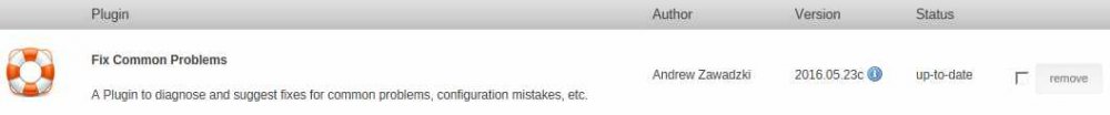

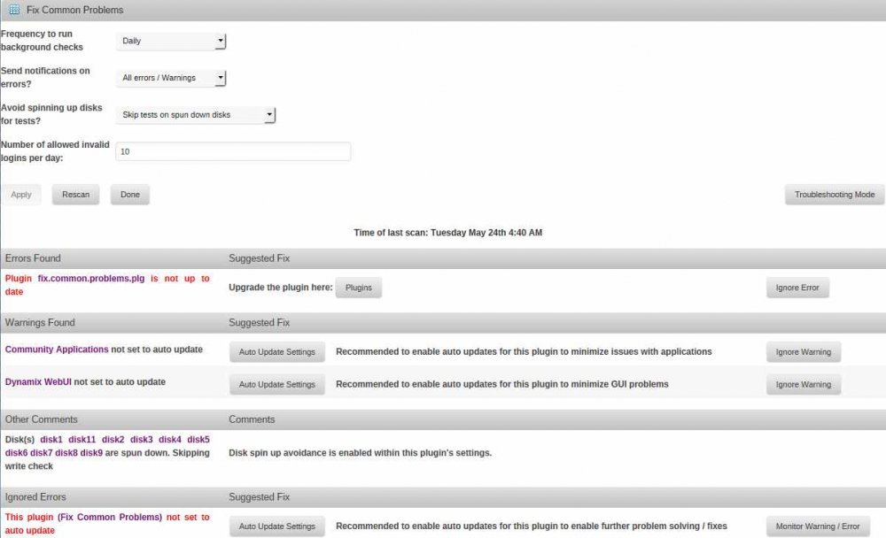

  16. I had tried that, to see if it would make a difference, no change. I just started Firefox (no reboot), pulled up the Main page, checked the log and noticed syslog entries for 'Fix Common Problems' at 4:40am. Started the plugin and for the first time it says "No errors found" and "No Warnings found", plus it says "Time of last scan: Wednesday May 25th 4:40 AM", which was the Daily scan this morning and not a scan of this instant! I had been assuming it always does a scan when I start the plugin, that's what it used to do, and it doesn't look different. But now I've just discovered there's a new Rescan button, never saw it before! So I guess it has not been re-scanning, just showing the result of the last scan. I must have missed that change. Would it be more intuitive if it didn't show the last scan, just showed the settings and a big <Scan> button, which you could click when ready, and click again after changing settings.
  17. Did you rescan? Other than that I cannot replicate. All its doing is checking to see if dynamix thinks there's an update available Also, to downgrade it to a warning: http://lime-technology.com/forum/index.php?topic=48972.msg470697#msg470697 I had rescanned several times, but tried once more, went back to the Main page, then back to the plugin, and no change. Went back to the Main page, spun up all drives for a more complete scan, but again no change. Rebooted and this time the error was gone. So it *appeared* to be fixed after reboot. BUT ... I decided to click the 'Ignore' button for the other 2 update warnings, and they appear to work, except they don't stick, nothing changes, they aren't apparently being ignored, and the Ignore button is still there. So I'm wondering if this and the first issue are another case of client-side weirdness we occasionally have with the webGui, where setting changes don't stick. I use Firefox. I used to have that issue with slot count changes, and would have to switch to Chrome to make slot changes that would stay changed. Others have reported the opposite, wouldn't stick in Chrome, but worked in Firefox. So I just tried Chrome, and it's behaving the same way. I click an Ignore button, get the confirmation dialog box, click the OK button, click OK a second time, then it reverts to the same screen with both Ignore buttons. Noticed that 'Fix Common Problems' does a scan on boot, with syslog entries. There are no syslog entries since boot though, is that possibly an indication that the scan wasn't really running, since this last boot? It supposedly did scans on both Firefox and Chrome. And it has been reporting the adblocker.
  18. Sorry, another false positive on my system, no idea why since it doesn't seem possible it could be connected in any way to User Shares, and others aren't reporting it. Last night, I received a notification (an 'Error') that 'Fix Common Problems' was out of date, marked as an 'Error' which seemed a little excessive. I have the update checks for it marked to be 'Ignored'. I also received a notification of "Version update 2016.05.23c" for 'Fix Common Problems', no problem with that as I was currently on 2016.05.22. So after reading the related posts this morning, I updated to the latest, 2016.05.23c and retested and it still reports the error, that I need to update. I've retried 3 times, no way to update further, and it still insists it's not up to date, see attached screens. Minor suggestion, add the version info next to the plugin title on top, perhaps in parens.
