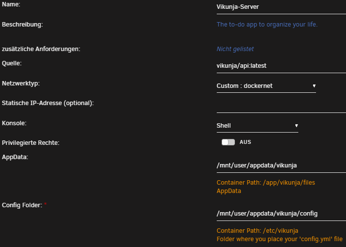

  8. Okay, I created the config.yml manually and saved it in /appdata/vikunja/config/. It works! I was able to enable the email feature and immediately customized even more. For example, I disabled the comment feature 👍🏼 I have tested this way and can confirm that no more data is overwritten 👍🏼 Now Vikunja runs as it should, and I thank you very much for your effort.
  9. I asked on GitHub. The creator of the script tells me that API is working and I now see that I can connect, but there's a problem with my login credentials. He pointed me to a recent change in PhotoPrism: Maybe that's the problem, but I don't know where I should run this command. Can you give me a hint?
  10. So, I started from scratch and re-installed the app. It looks a bit better now: I am able to upload a profile picture now. This was not possible with the last release 👍🏼 I have some files in /mnt/user/appdata/vikunja. For example, if I navigate to /mnt/user/appdata/vikunja/config, I see, that now there is the file vikunja.db, which is almost 500 kb. Great 👍🏼 What is still unclear: Your template suggests to use /etc/vikunja/vikunja.db. I have not changed it, so I wonder why my Database is finally in /mnt/user/appdata/vikunja/config. I would just like to point out that many users back up the /appdata folder, not the /etc folder. I tried to enable the email feature. Following the Vikunja docs, I have to modify the config.yml file. But I don't find this file. Under /mnt/user/appdata/vikunja/config, I only see the file vikunja.db. How can we test and ensure that the vikunja.db file is not overwritten during the next update? Thank you for your efforts 👍🏼
  11. Thanks @A75G. Can you please specify what I should check exactly? Should I reinstall your Vikunja Container from the Unraid Appstore? I really want to help Vikunja run perfectly under Unraid. Since my database seems to be gone anyway, I'll have to start from scratch anyway. I just need some help since I'm not really familiar with Docker.

  16. Yes, I have a backup. Every night, a backup is being made of the /appdata folder. This is the folder, where all the containers store their data in Unraid. The Vikunja container is also set to use the Appdata folder - see attached screenshot. But: The folder /appdata/vikunja is empty! Therefore, unfortunately, I also have no backup... I have now checked the entire Appdata folder as I have many Docker containers running (Jellyfin, Flame etc). Many of them use SQLite and all of them put their data in the Appdata folder, except Vikunja. Maybe @A75G can help?
  17. I have updated Vikunja-api, and now I can no longer login to my Vikunja server. I don't know much about Docker, unfortunately. Could it be that the update overwrote my database?
