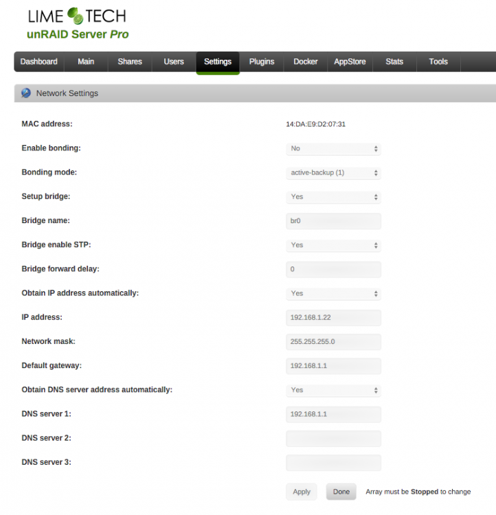

can you try completely removing the unRaid-hole using the docker manager, and then as root on Tower, type: docker run -d --name=unraid-hole -p 53:53/tcp -p 53:53/udp --cap-add=NET_ADMIN spants/unraid-hole and then, if that doesn't work: docker run -d --name="unRaid-Hole" --net="host" -e TZ="Europe/London" --cap-add=NET_ADMIN spants/unraid-hole ^^^ This is the new settings for unRaid-Hole, using Host mode for faster lookups My Network settings are attached, for reference. I have two nw cards but I am only using one. Thanks! Tony

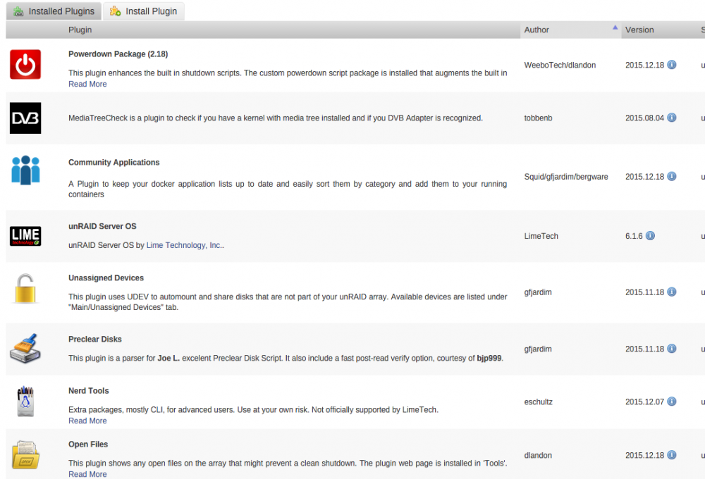

Pulling image: spants/unraid-hole:latest IMAGE ID [latest]: Pulling from spants/unraid-hole. IMAGE ID [340b2f9a2643]: Pulling fs layer. <snip> IMAGE ID [0752514b4a91]: Extracting. Pull complete. IMAGE ID [cbbe3318f326]: Extracting. Pull complete. Already exists. Digest: sha256:27e5abac0fc87ea1565e63f1c610caa872409cb97484c043cf3bc0f5bb31824e. Status: Downloaded newer image for spants/unraid-hole:latest. TOTAL DATA PULLED: 8 MB Command: root@localhost:# /usr/local/emhttp/plugins/dynamix.docker.manager/scripts/docker run -d --name="unRaid-Hole" --net="bridge" -e TZ="Europe/London" -p 53:53/tcp -p 53:53/udp --cap-add=NET_ADMIN spants/unraid-hole 93c6d025391ac856998f86cb1e0cc1aed3be73dc5f3ccf570f43653767f3ccd8 The command finished successfully! What other dockers are you using? And what version of unRaid ( I am on 6.1.6)
