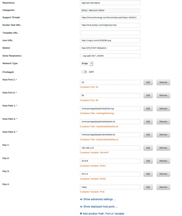

  2. Hi - the pihole support is here https://lime-technology.com/forum/index.php?topic=50453.0 This is mine, working: /usr/local/emhttp/plugins/dynamix.docker.manager/scripts/docker run -d --name="pihole" --net="bridge" -e TZ="Europe/London" -e HOST_OS="unRAID" -e "ServerIP"="192.168.1.22" -e "DNS1"="8.8.8.8" -e "DNS2"="8.8.4.4" -e "IPv6"="False" -p 53:53/tcp -p 80:80/tcp -p 53:53/udp -v "/mnt/user/appdata/pihole/pihole.log":"/var/log/pihole.log":rw -v "/mnt/user/appdata/pihole/blacklist.txt":"/etc/pihole/blacklist.txt":rw -v "/mnt/user/appdata/pihole/whitelist.txt":"/etc/pihole/whitelist.txt":rw -v "/etc/localtime":"/etc/localtime":rw --cap-add=NET_ADMIN diginc/pi-hole:alpine e8948a0fe593ba75d65bf09d9be8ac6b044f89b0c821a65ec3bd5eb8cc79c17d The command finished successfully! Did you create the pihole folder and follow the instructions here: https://lime-technology.com/forum/index.php?topic=50453.0

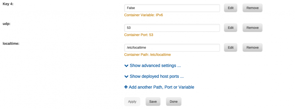

  8. yes, add a new Path for /etc/localtime as shown below:

  18. Here's mine - note the advanced settings with extra params = --cap-add=NET_ADMIN
