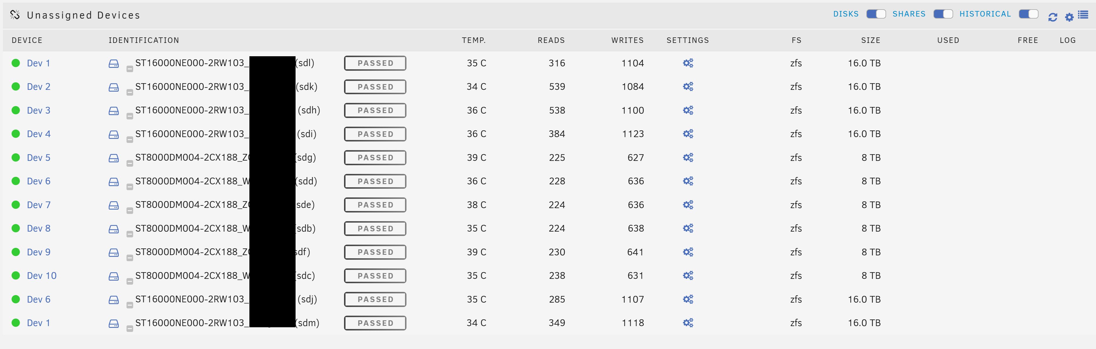

  9. Hi saw the update and applied but it did not auto fix my drive names. I wen to the device and renamed, then deleted any text and hit SAVE. That then saved the right name and repeated for all the incorrect drives and they are not duplicating any more. The update did not automatically do it but maybe prevent it in the future? Thanks for the work and attention. Have a good day.
  10. No worries and thank you. I am busy to and do not have time to manually fix. When I do I will check back for an update or manually fix then. Either way will report back and thanks for the plug-in and quick work.

  13. Hello, Moved over from a Windows server with RAID5 60 TB to Unraid raidz2 120TB with two pools. Everything has went well. I am now having an issue with the unassigned devices plugin and the device names being mixed up. At first all device names were good in the list. I have 6 drives on my new LSI HBA and 6 drives on my Adaptec 71605 (RAID5). The plugin worked well but I had issues after I retired the RAID5. Unplugged my Adaptec raid card, then moved the clear drives from the RAID5 to the HBA as a new pool. That went well too, but when I did that the device names "i.e. dev6" is wrong or replicated and I took a screenshot. After unistalling the unraid listed them in order but when I reinstall the unassigned devices plug-in the names get mixed up again. The names will not match the actually device names for maybe about 3-4 drives. When reinstalling the plug I can see the passthrough and other setting have stuck around. Maybe there is a way to clear the unassigned devices plugin history settings? Please see attached screen shot. I have tried to rename the device to the right number and save but that doesnt work. I hope this would not cause a an issue with an accidental format on the wrong drive but glad I notcied before I clear the the drives from the RAID. I could not trust the visual format and cleared the drives by command line and all is well. No issues but wanted to report it and see what I can do about clearing the history/settings? DEV 1 and 6 and the main issues. Top DEV1 is really 11 and bottom DEV1 is the real DEV1.
