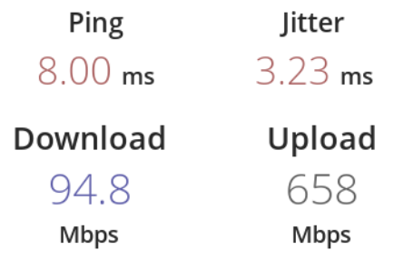

  15. After installing the Intel I225-V NIC, I see the same issue. I now also tested the connection between my WiFi Macbook and a wired PC -> same issue. I'm quite sure now that the issue is caused by my Router.
  16. I was digging a little bit more into this issue: Using iperf3 I can see the same behavior, even on an Ubuntu 22.04 live OS. Therefore, I'm quite sure that this is a hardware / driver issue with the Realtek RTL8125B NIC on my Biostar B760M-Silver Mainboard. Unfortunately, I didn't find a way to disable the 2,5 Gbps mode in the BIOS, to see if this fixes the issue. I ordered a PCIe Intel I225-V NIC to see if this solves the issue.
  17. Hi, when accessing unRAID via 5 GHz Wi-Fi, download speeds from Docker containers running on unRAID (e.g. librespeed) or of data via SMB/NFS is locked to 100 Mbit. I tested this on multiple devices and I can see the same on all of them. The strange thing is, that the upload speed to the unRAID server seems fine with ~600-700 Mbit. After testing the connection to unRAID, I also ran an Internet speed test using fast.com, which shows me download speeds of ~600-700 Mbit (I've got an 1 Gbit/s Internet plan). The unRAID server is connected via a Cat 6 Ethernet cable to my Fritzbox Router, and when connecting the same clients via Ethernet, the full 1Gbit/s are being used. Result using librespeed: Any ideas what is going on here? gandalf-diagnostics-20230123-1931.zip
