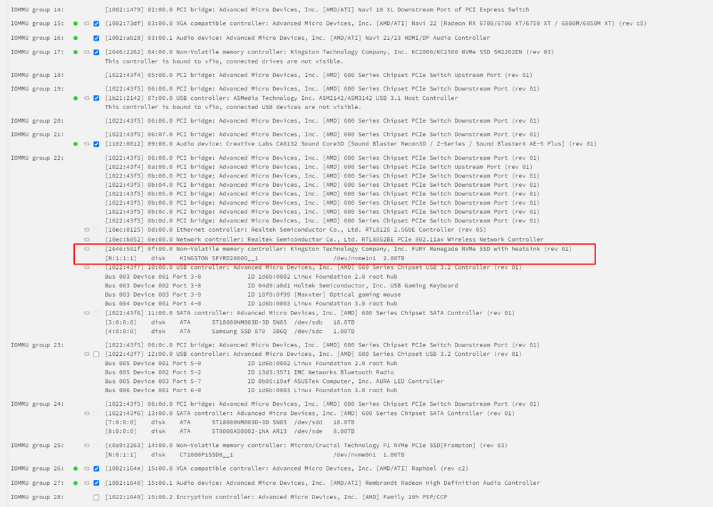

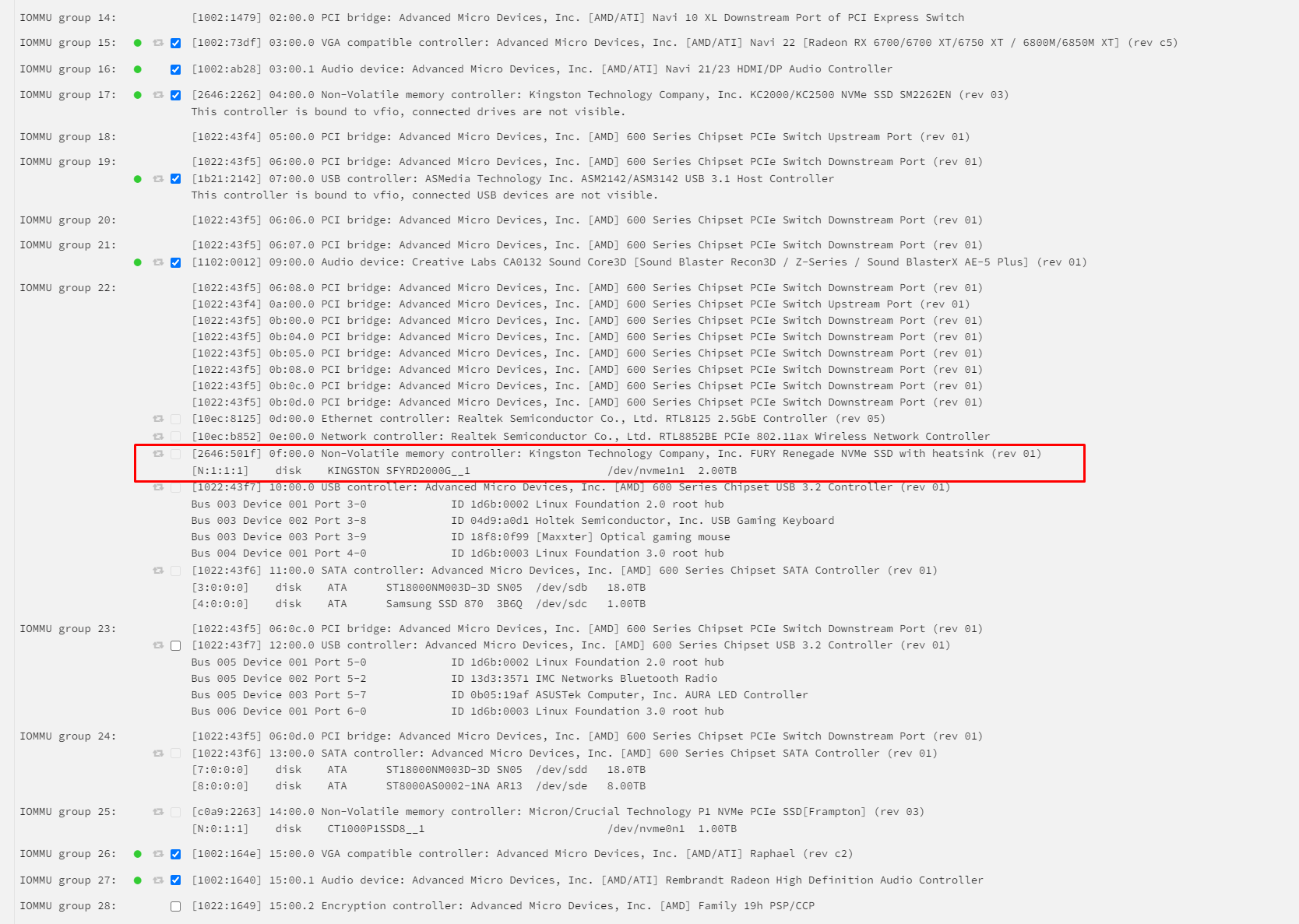

  12. I switched the drive with the 1TB one that is in group 1 in the picture, and it resulted in freedom. 😜 I'm currently using it for a POP!_OS VM.

  16. I just got myself an extra drive that i thought would be easy to pass through to a new VM, but it ended up in a strange group, how do I change this? Is it something that I can change around somewhere so I can pass it through, or what should I do?
