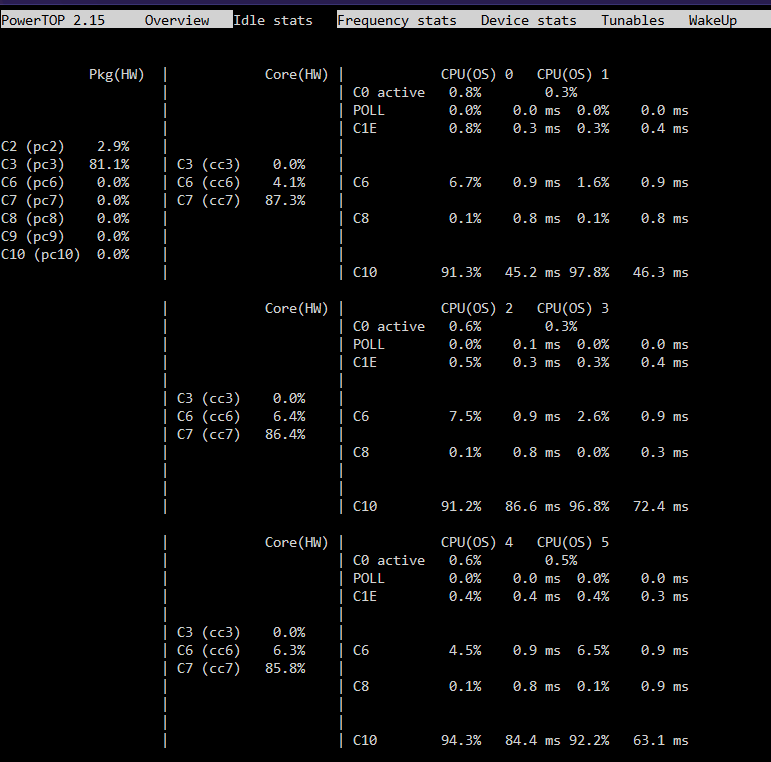

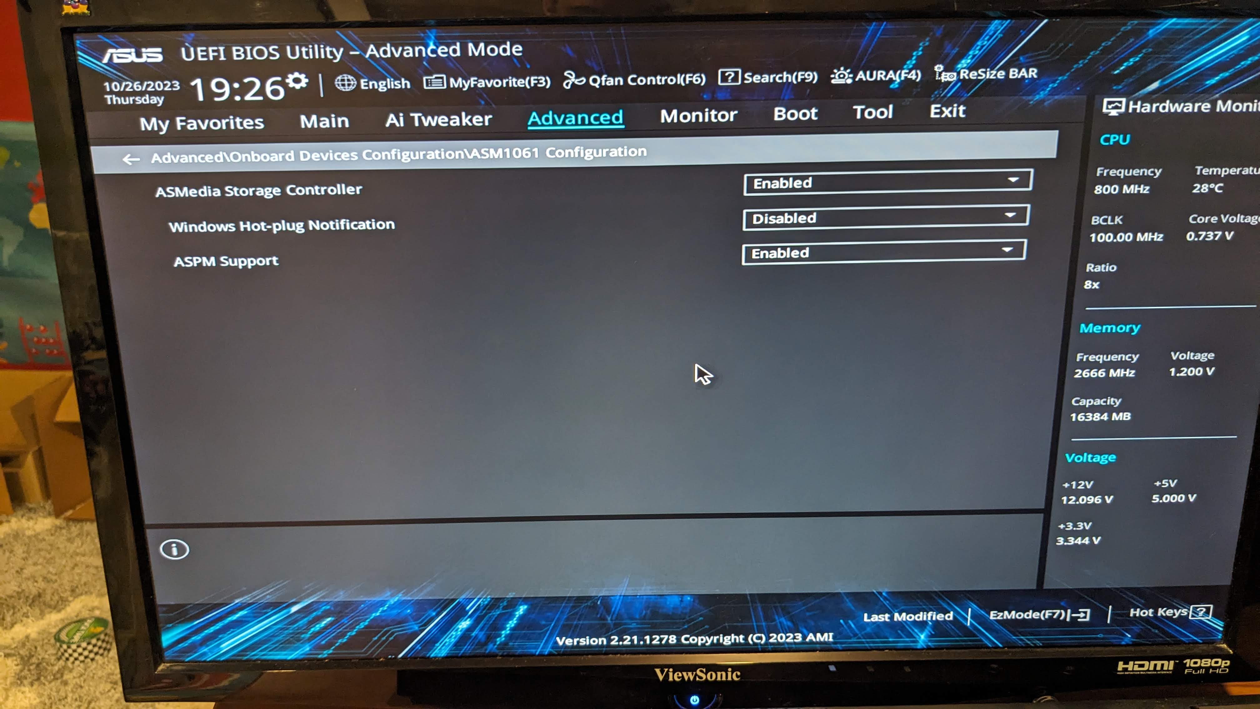

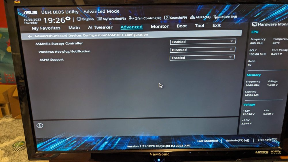

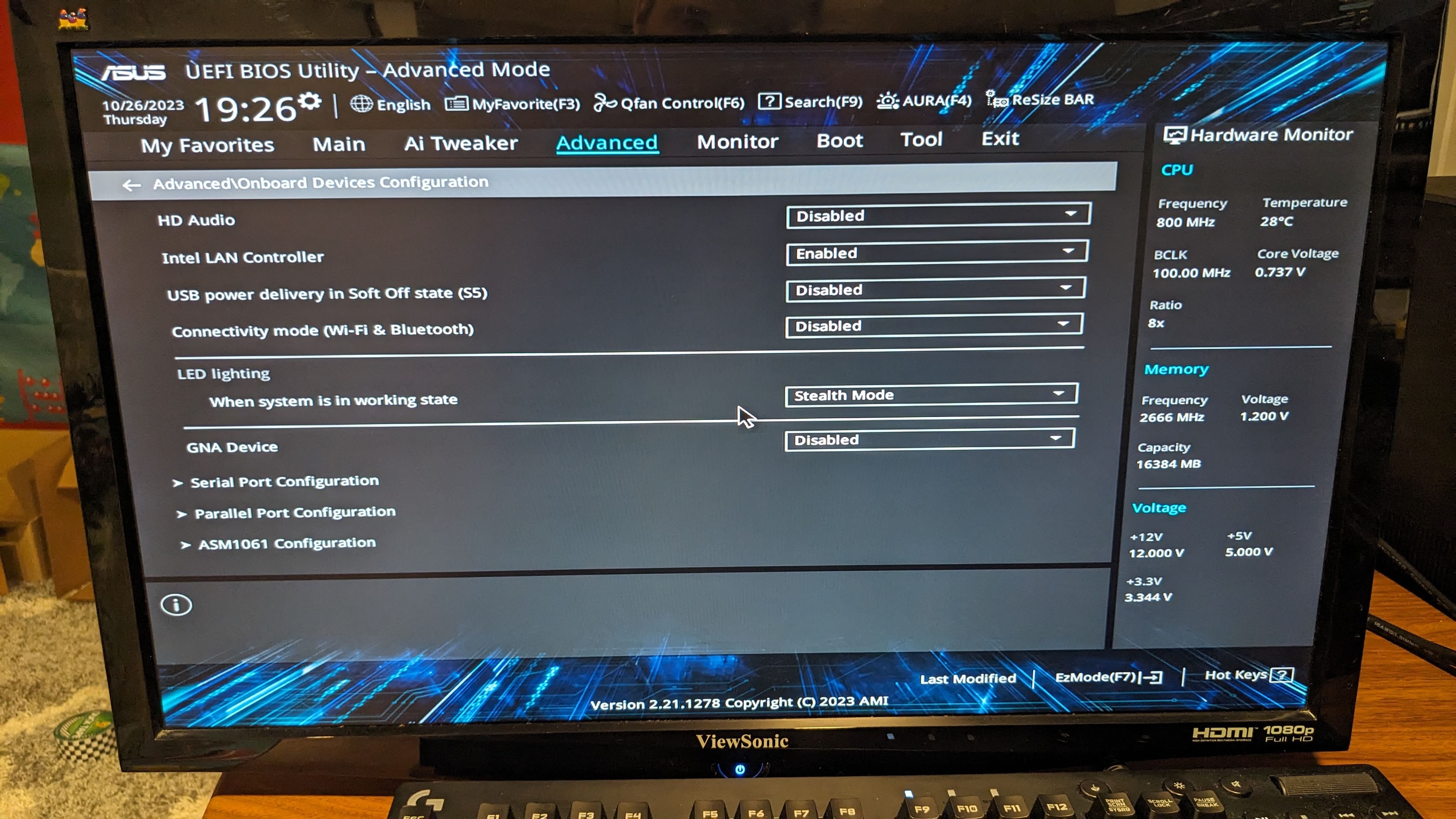

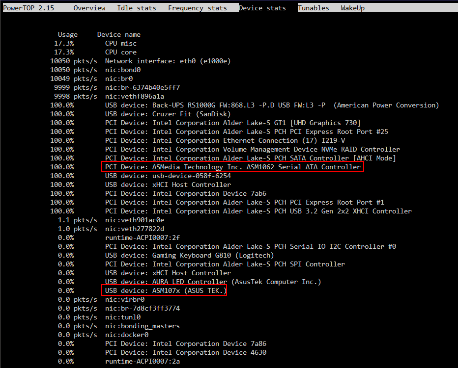

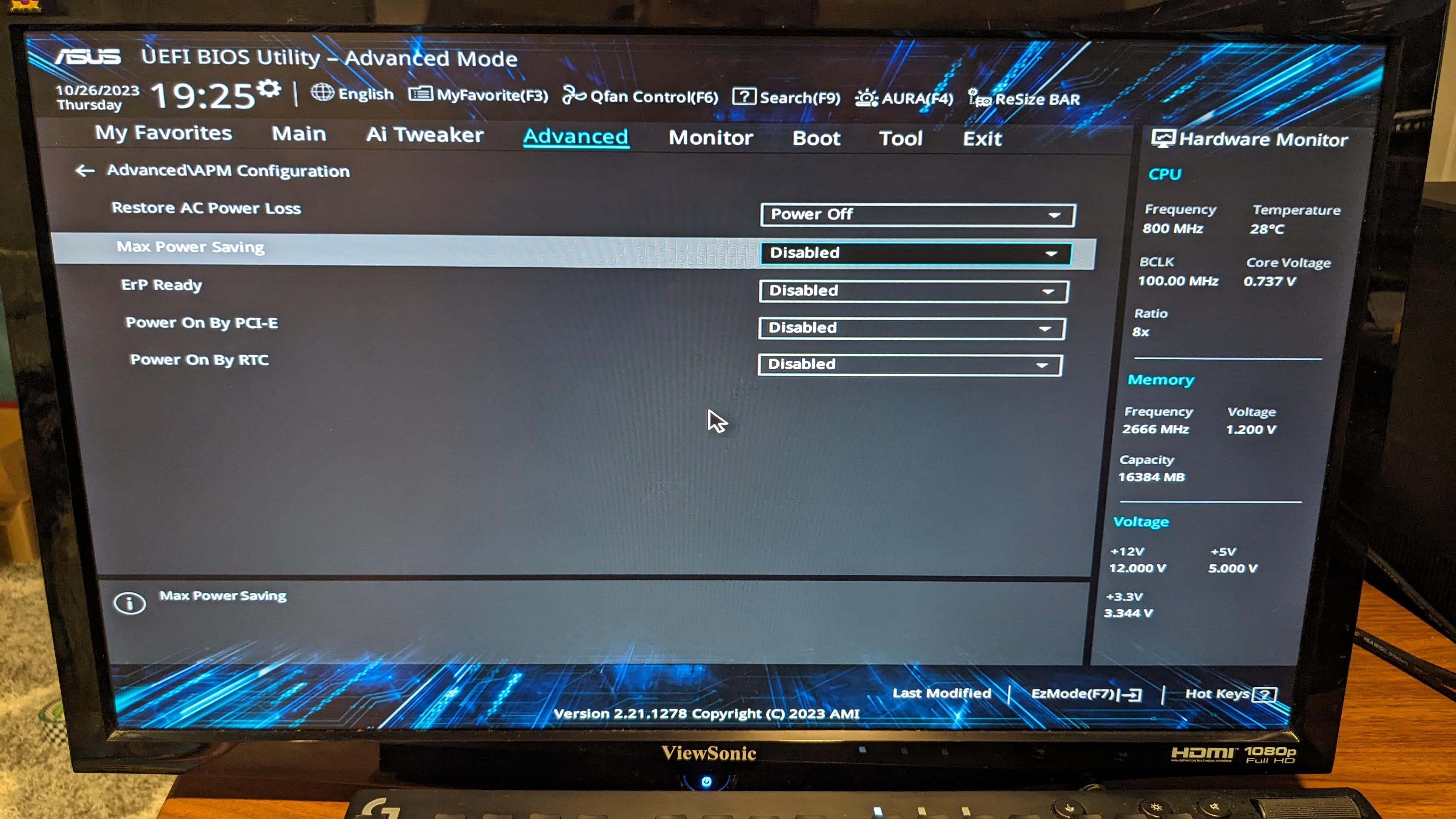

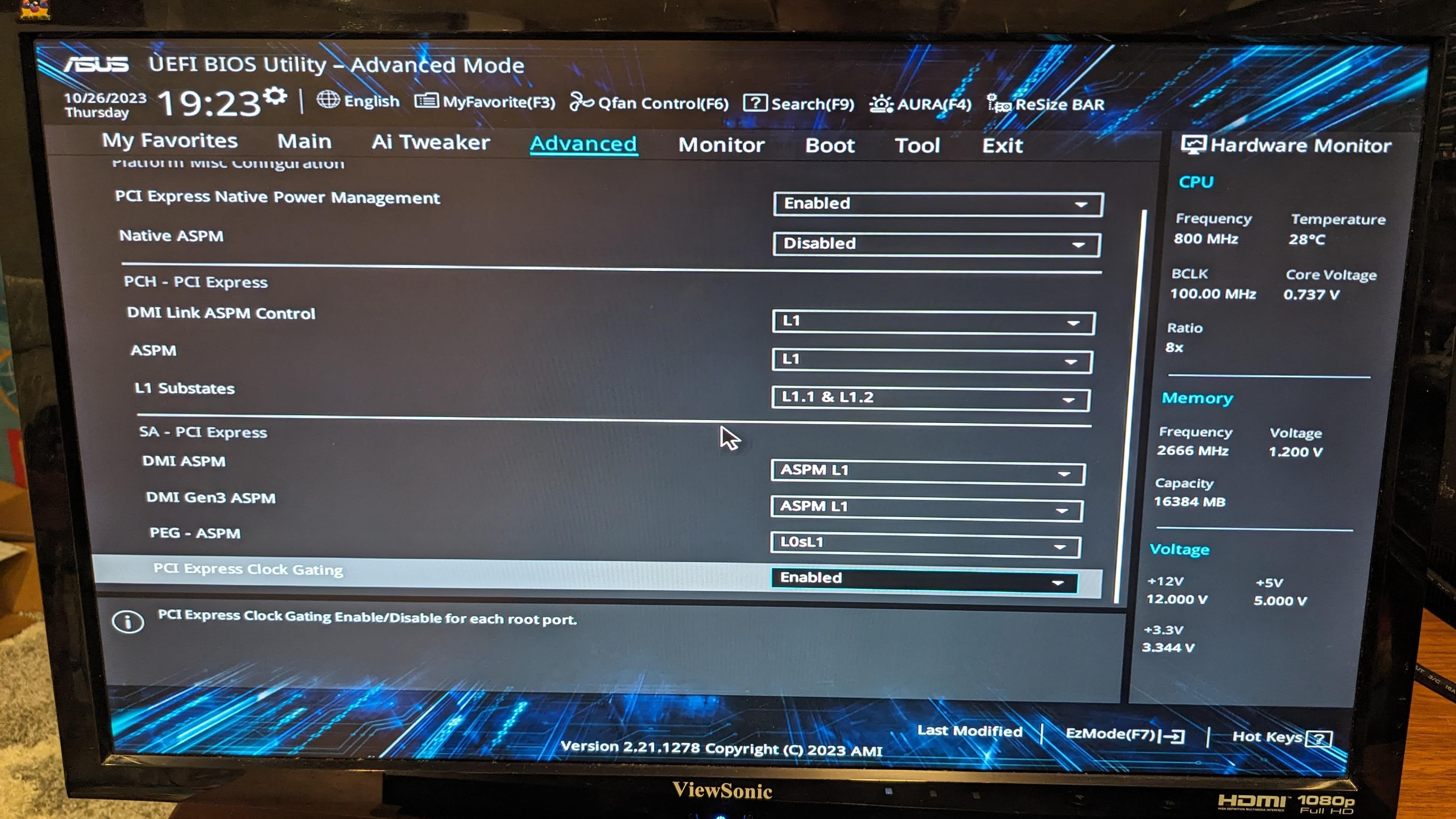

Yeah wait hold up. I thought I was just not understanding something. It DOES say that everything is connected to the Intel B660 chipset. In fact there aren't any duck duck go results (in english at least) containing "asus" "b660m" and "asm1061" @mgutt is it possible you're thinking of the ASRock B660M? That one mentions ASM1061... EDIT: Looking at the Device Stats screen in Powertop, I do see mention of ASMxxxx stuff, but its ASM1062 and ASM107x. Unclear if that matters.
Reduce power consumption with powertop
lol well, awesome... Thanks for the quick replies!
Is ASM1061 on every SATA port on this board? If so, I guess i'd be looking at an add-on card at some point. Also, I believe you on the power supply, but I'm curious how you know that. Is it missing some sort of feature i should have been looking for?

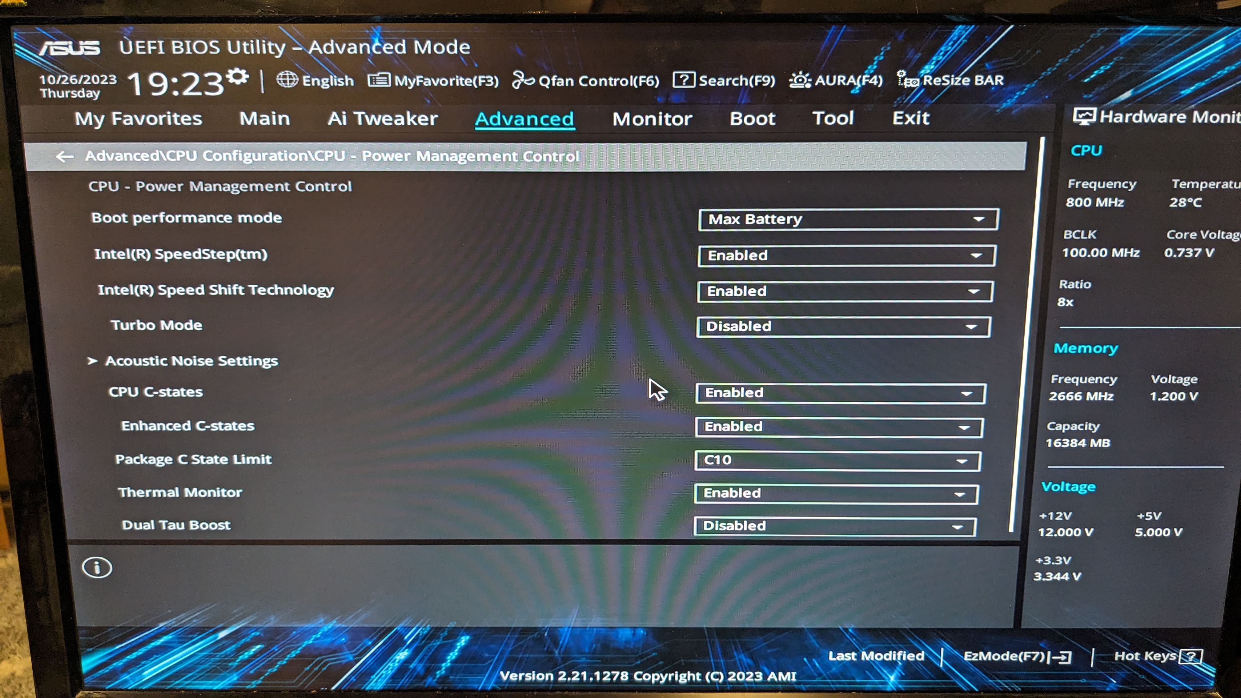

Hi all, I'm starting my power saving journey and feel very in over my head. Motherboard: Asus Prime B660M-A AC D4 (with updated bios) CPU: 12th Gen Intel® Core™ i3-12100 Memory: Silicon Power 16GB (2 x 8GB) 288-Pin PC RAM DDR4 3200 PSU: EVGA SuperNOVA 650 GT, 80 Plus Gold 650W Hard Drives: 3x HDD, 1x SSD, all SATA According to my Kill-A-Watt, I'm idling at 20-28w, depending on if the drives are spun down or not. I'd *love* to lower that by 5 or 10. After running powertop, I've managed to reach C3, but no lower. Anyone have any ideas? Happy to provide whatever other info!
