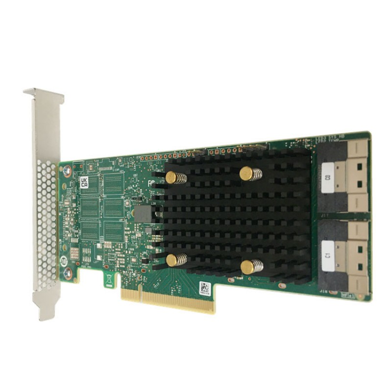

  9. https://www.amazon.com/gp/product/B01N0MHODJ/ref=ppx_yo_dt_b_search_asin_title?ie=UTF8&psc=1 This is what i used to connect my LSI 9500 to my SAS3 expander.... what motherboard do u have?

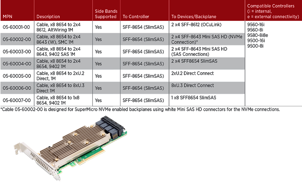

  18. It appears that the only card that would work for those supermicro cables is this one but it's not worth spending $800 on it. This is the broadcom 9460 RAID card - which I don't even need a raid card with unraid..... so I guess the rear slots will be inop But for the front SAS3 backplane, which supports NVME u.2/u.3, can I use the same cable above to plug into the white ports or do I only need the one plugged in? Right now I have one 74 pin cable coming from the card to 2 HD Mini SAS 4i SFF-8643's into the SAS3-826EL1-N4 backplane...

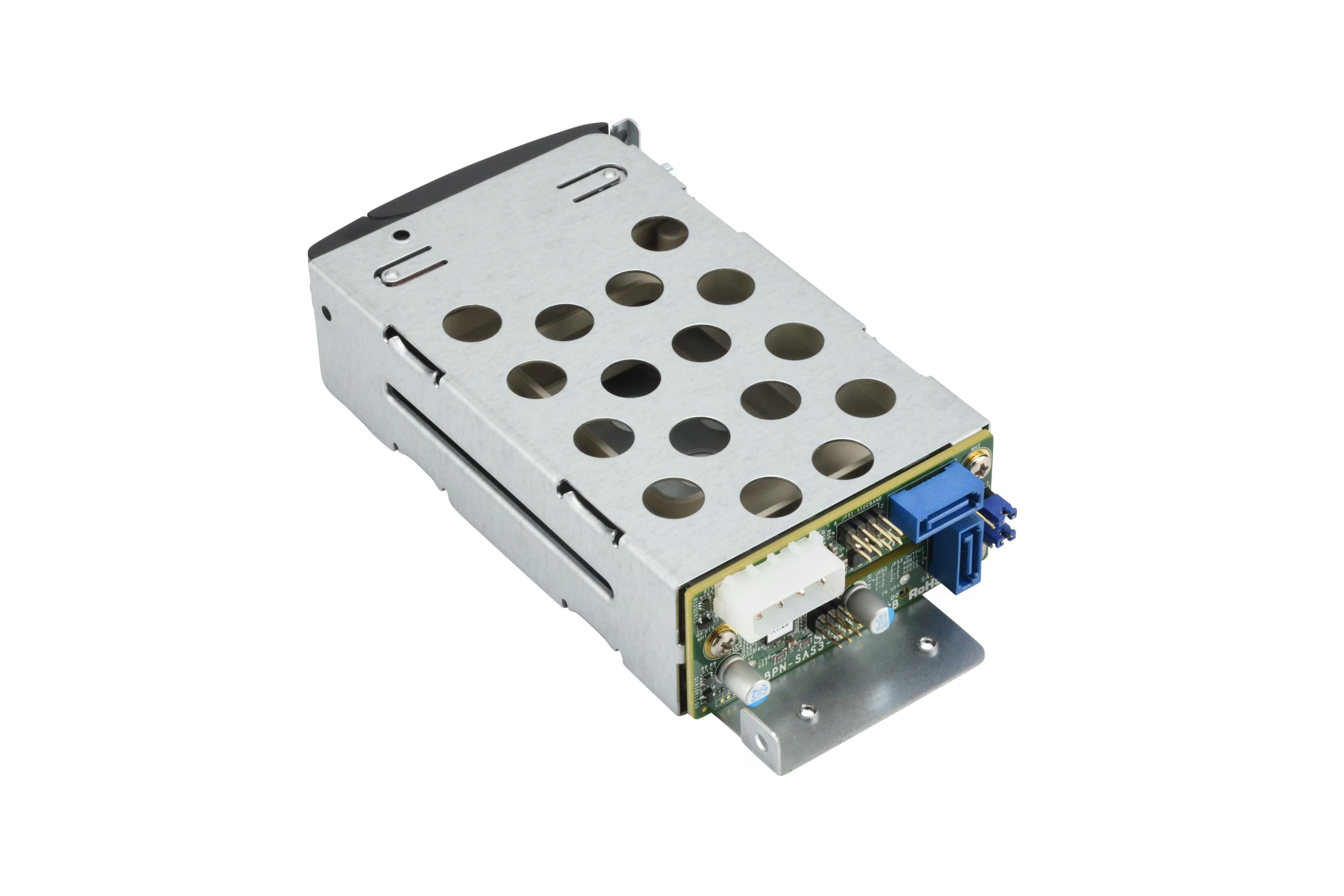

  19. This is the rear NVME 2.5" drive slot. it requires a 4 pin molex for power and 2 sata ports and that 8 pin connector. I guess I won't be able to use it with the LSI 9500 16i

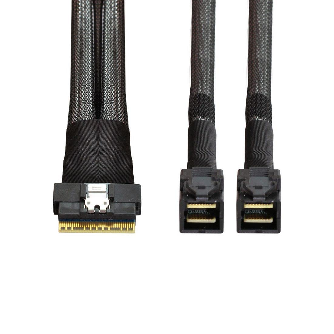

  21. The only issue I have is this Supermicro 826 case has the 2 NVME drives in the rear that has a SFF 8654 to 4x SATA and some odd 8 pin cable... no idea what kind of cable I can use to bring those drives online. ? The LSI has the 74 pin: Using this cable to connect to the SAS3 expander:
