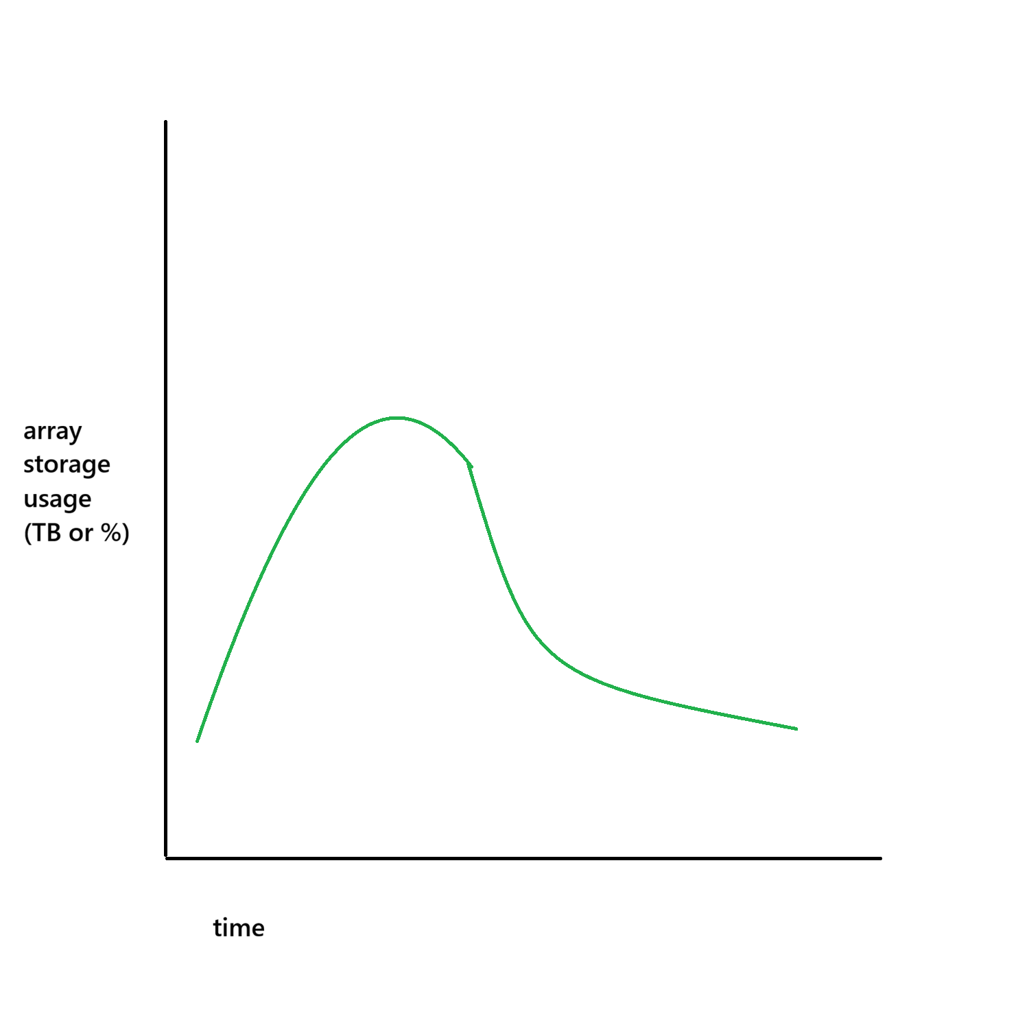

  1. Hello everyone. I am relatively new to unraid so apologies if this question is answered elsewhere. I'm looking for something along the lines of the above that simply shows how much array usage is being taken over time to show relative changes in storage. I do a lot of adding and purging files and am curious how much I've gotten rid of after a given deletion session. Is there any plugin or addon or something I can use for this? Thanks in advance.

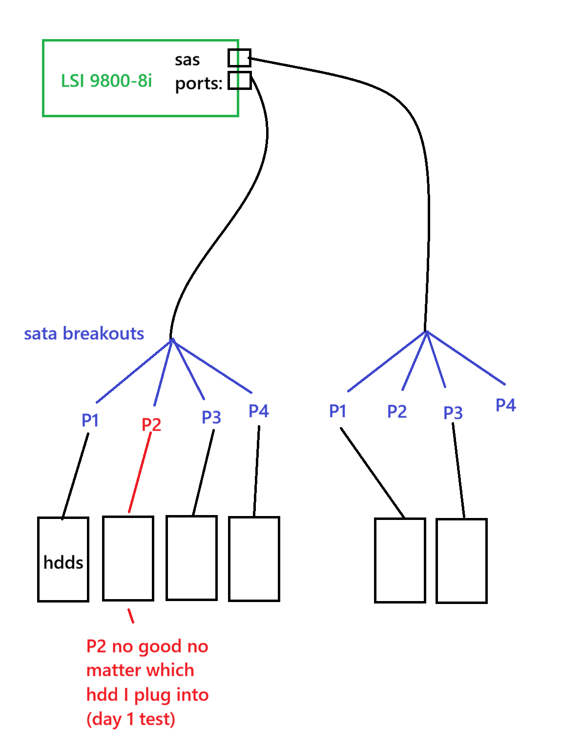

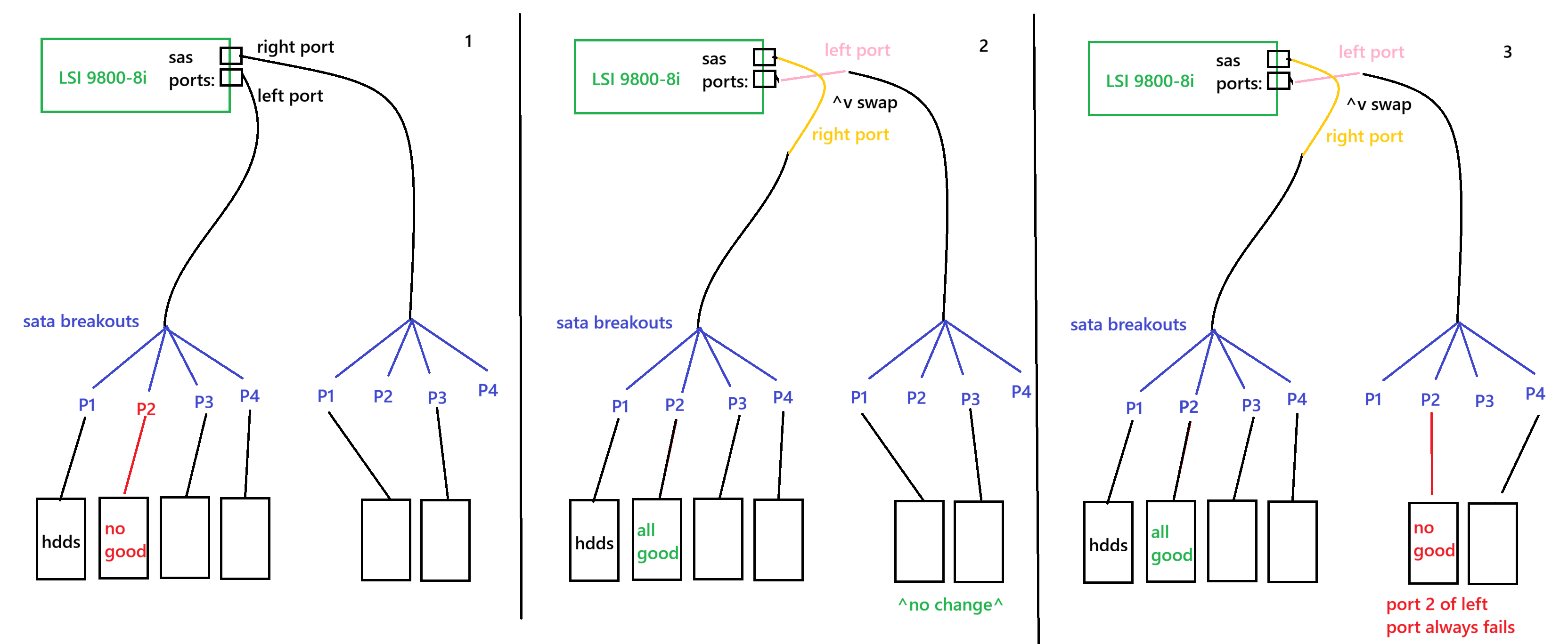

  3. Sorry, I probably didnt explain it well. Here's a diagram to make it simpler: day 1 test: day 2 test (today): hope my crummy diagram helps explain what I mean. the problem is following "sata cable splitout plug 2" of the left port only, no matter which cable I use
  4. Hi everyone. I received the replacement cable today. I installed it, and got a bizarre result. 3 drives spin up out of 4 with the new cable, same as the old cable. I go and check which one doesn't spin up and then go check the cable. The cables come labeled (P1 P2 P3 P4). The old cable problem child was P2. And the problem cable on the new one is also P2. Now I'm starting to wonder if there is another issue, maybe either with my bios or with my SAS card? I am using 9800-8I LSI card, is it possible that it's faulty somehow making it unable to read one out of the 4 splitter SATA plugs? Would love to hear any and all ideas, as I'm a noob. EDIT: As my LSI card is the 9800-8i with two SAS out ports, I swapped the two SAS cards and now all 4 drives appear. I should have tried this originally. Since I have 6 drives, the cable I swapped to the port that hadn't shown all 4 previously only had P1 and P3 plugged in, and both of those drives also showed up. I just tried plugging in P2 and P4 in place of P1 and P3, and lo and behold, once again P2 does not get recognized. So to put it simply, my LSI card has two SAS out ports, and the leftside SAS out seems to not accept the P2 split of my 4 way SAS <> SATA split out. Does this mean I need a new LSI card, or could it be a software issue?

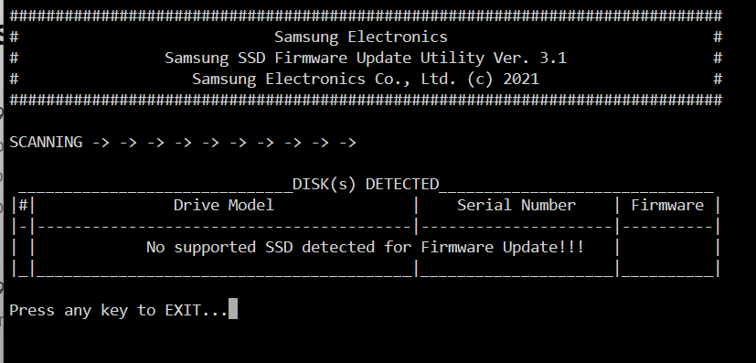

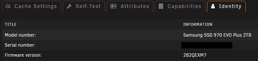

  11. This is helpful. I have a 970 Evo Plus with firmware "2B2QEXM7" as evidenced here: vs the latest firmware on samsung site as "4B2QEXM7" (difference is 2b vs 4b only it seems) as evidenced here: \ I downloaded that 4B2QEXM7 firmware. When I follow OP steps, I get this: Your post explains it. It's also explained in this reddit thread: https://www.reddit.com/r/pcmasterrace/comments/ut6asc/samsung_ssd_firmware_how_to_update/ Unfortunately for me, the reason I went hunting for this is because my samsung 970 EVO plus seems to randomly shut off in my array. I have to hard shut down and cold boot to get it back (even reboot doesnt get it back). I was hoping firmware update would resolve this. Now I have no clue.
