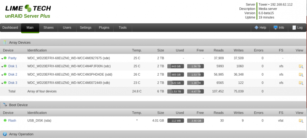

That worked: root@OshTank:~# /usr/local/emhttp/plugins/snmp/drive_temps.sh WDC_WD20EFRX-68EUZN0_WD-WCC4M0927675: 28 WDC_WD20EFRX-68EUZN0_WD-WCC4M4PJF00N: 28 WDC_WD20EFRX-68EUZN0_WD-WCC4M3PHD4DE: 29 WDC_WD20EFRX-68EUZN0_WD-WCC4M0072449: 27 root@OshTank:~#

Nice. I just updated the plug-in, but I'm not seeing temperatures, either in your installation test, or from my SNMP monitoring server. Here's the snippet from your installation: +============================================================================== | Testing SNMP by listing mounts +============================================================================== Looks like snmpd is working... Output: HOST-RESOURCES-MIB::hrFSMountPoint.1 = STRING: "/mnt/disk1" HOST-RESOURCES-MIB::hrFSMountPoint.2 = STRING: "/mnt/disk2" HOST-RESOURCES-MIB::hrFSMountPoint.3 = STRING: "/mnt/disk3" HOST-RESOURCES-MIB::hrFSMountPoint.22 = STRING: "/var/log" HOST-RESOURCES-MIB::hrFSMountPoint.25 = STRING: "/boot" Here's what drive temperatures look like: NET-SNMP-EXTEND-MIB::nsExtendOutLine."disktemp" = No Such Instance currently exists at this OID ----------------------------------------------------------- snmp has been installed. Copyright 2015, David Coppit Version: 2015.08.24 ----------------------------------------------------------- Thanks, John
