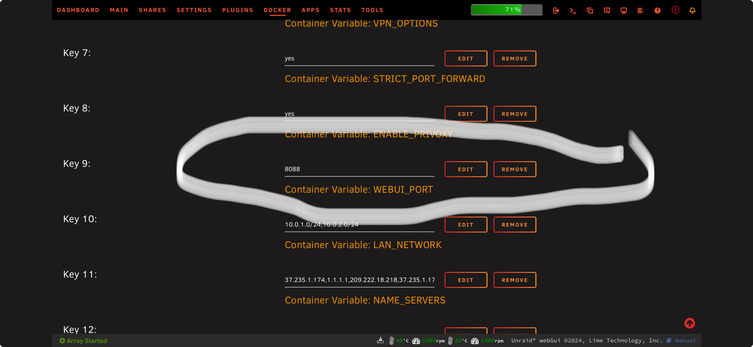

I’m also not sure you set the webUI port in the right spot.- [Support] binhex - qBittorrentVPN
You’ll set the variable webUI port to your desired port number and then add a new port mapping that container port to the same host port. The warning is saying that 8181 is already in use by another container.- [Support] binhex - qBittorrentVPN
8181 is already in use. You’ll need to try another one.- [Support] binhex - qBittorrentVPN
