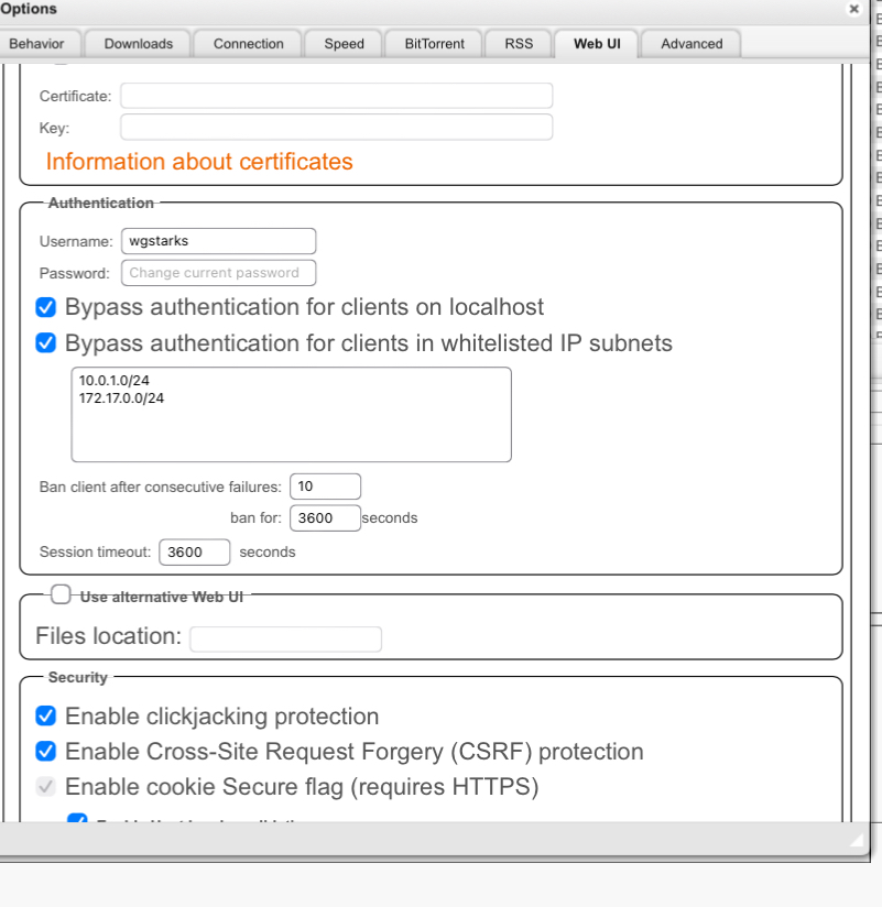

  6. Another option would be to whitelist connections from your local network. 172.17.0.0/24 is the network assigned to docker0 in my unRAID machine. You can verify yours by checking Settings>Network Settings>Routing Tables.
